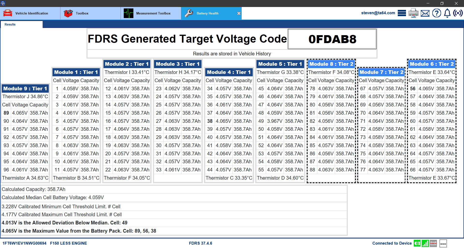

I think I'm one of those that will need a battery module replaced. I used FDRS to update all my software last night and today I am seeing an error P0B24 "Hybrid/EV Battery 'A' Voltage Unstable". I can clear it out, but it comes back. It won't even charge when that error is present. Clearing the error allows it to charge, but the error returns.
I ran a battery health check in FDRS and cell 49 in module 5 is running below the median deviation as shown in the screenshot. It is running in reduced performance mode now. Just got this truck last week, so this sucks.
EDIT: Just spoke to a local dealer and I'm dropping the truck off Monday and he getting me a Mach E loaner.
Quite the deviation! Make sure you don't take it down into the lower SOCs before you drop it off.

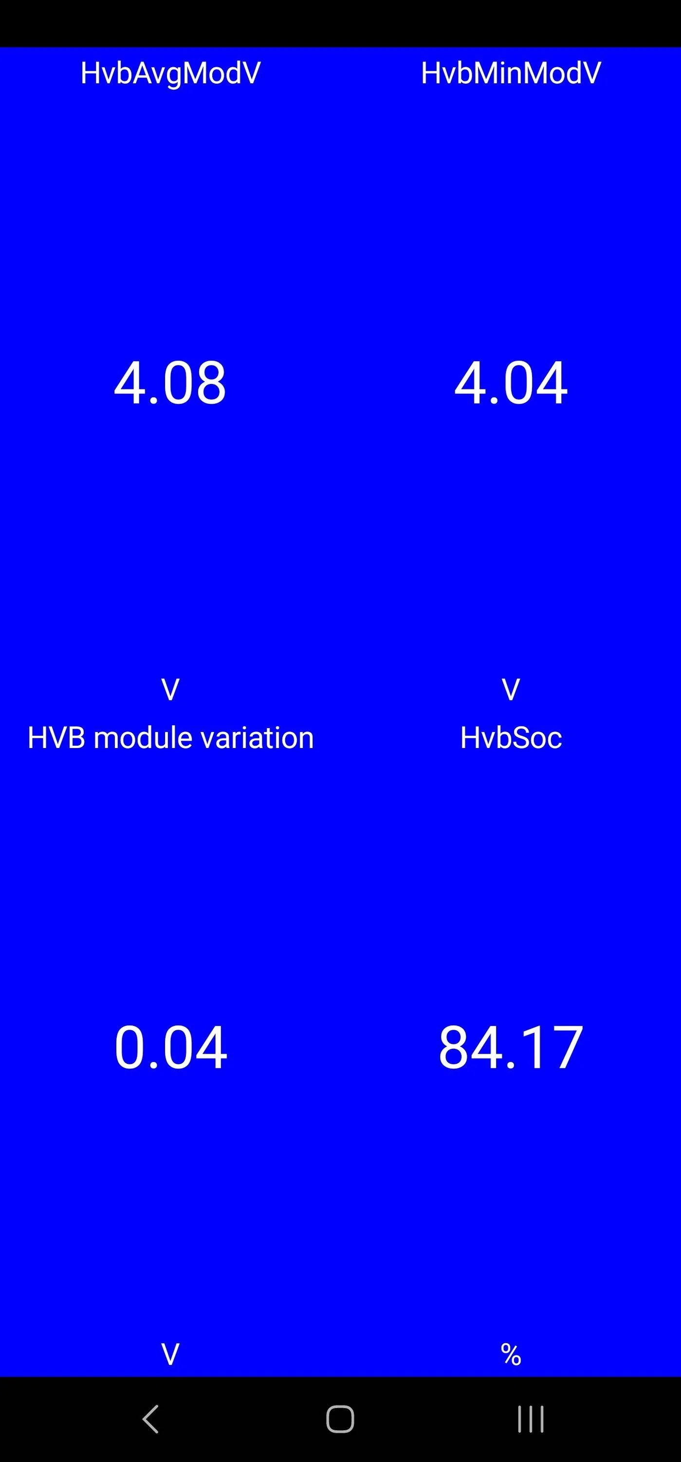

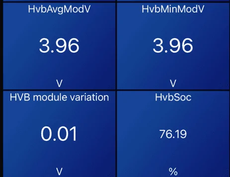

I don't have FDRS but us cheapos can use the Car Scanner app. It doesn't report each module but does report Minimum, Median and Deviation (but only to 2 decimal places :( ). Mine reports .01 Volt deviation for instance. However if you rounded all your modules to 2 decimal places they would be either 4.06 or 4.07 (except #38). Would be curious what Car Scanner shows for you - if it matches FDRS.
Here are the same 4 tiles on mine
Ford F-150 Lightning CSP-23B57 for High Voltage Battery Notice 1695432877260
Ford F-150 Lightning CSP-23B57 for High Voltage Battery Notice Screenshot_20230922_211711
Here are those same tiles for mine on Car Scanner
That's disappointing for sure. Hopefully they get the module quickly and make the experience less of a PITA.
I was wondering what was the deviation limit, so thanks for posting that chart. Looks about .046 volts and car scanner showing 0.04 for you at least gives us an idea of what to look for.

I do think they are connected. I've only had the truck for a little over a week and I've had no errors until I made all the updates including that new BECM one. I cleared all errors after I finished the updates Thursday night and didn't drive until the next morning when I saw the error.
I also ran the test a few times after the updates just playing around with the software before I realized I had an issue. The difference between the median cell voltage and the allowed deviation value was .046 for those as well (below)
  • 9/21 Test 1: 4.072-4.026=.046
  • 9/21 Test 2: 4.071-4.025=.046
  • 9/22 Test 1: 4.059-4.013=.046 (from screenshot earlier)
