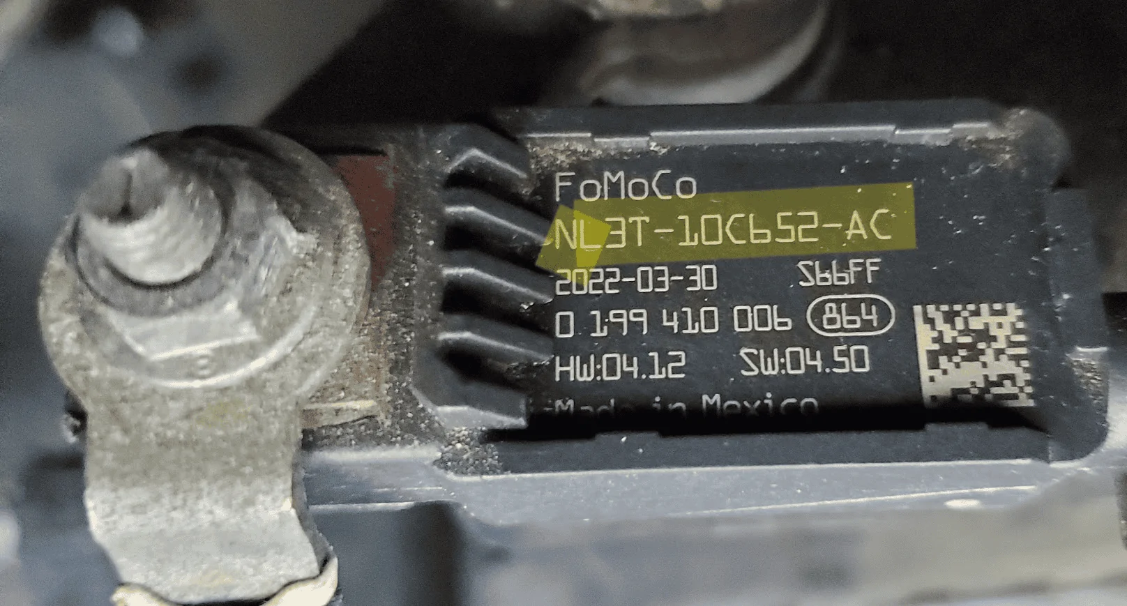

Why is this happening: "The Battery Monitor Sensor (BMS) may randomly under report the actual 12V battery capacity during an over-the-air (OTA) software update, which means that customers might be unable to complete OTA software updates on their vehicles." Which probably has happened to most of us.
What am I looking for: BMS Sensor with either a part number of NL3T-10C652-AC or NL3T-10C652-AD.
I have the -AC version on my truck:

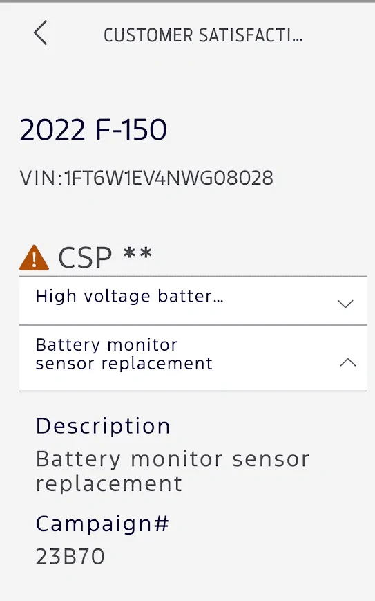

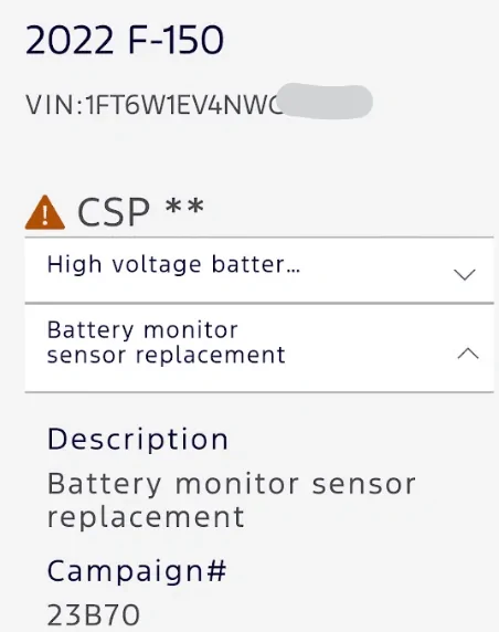

Contact your service advisor and reference CSP program number 23B70. They will need to see the truck to verify the part number you have now before ordering the replacement.
I've attached the relevant docs for you to reference and review.
You have until 5 Jan '25 to get this done.
