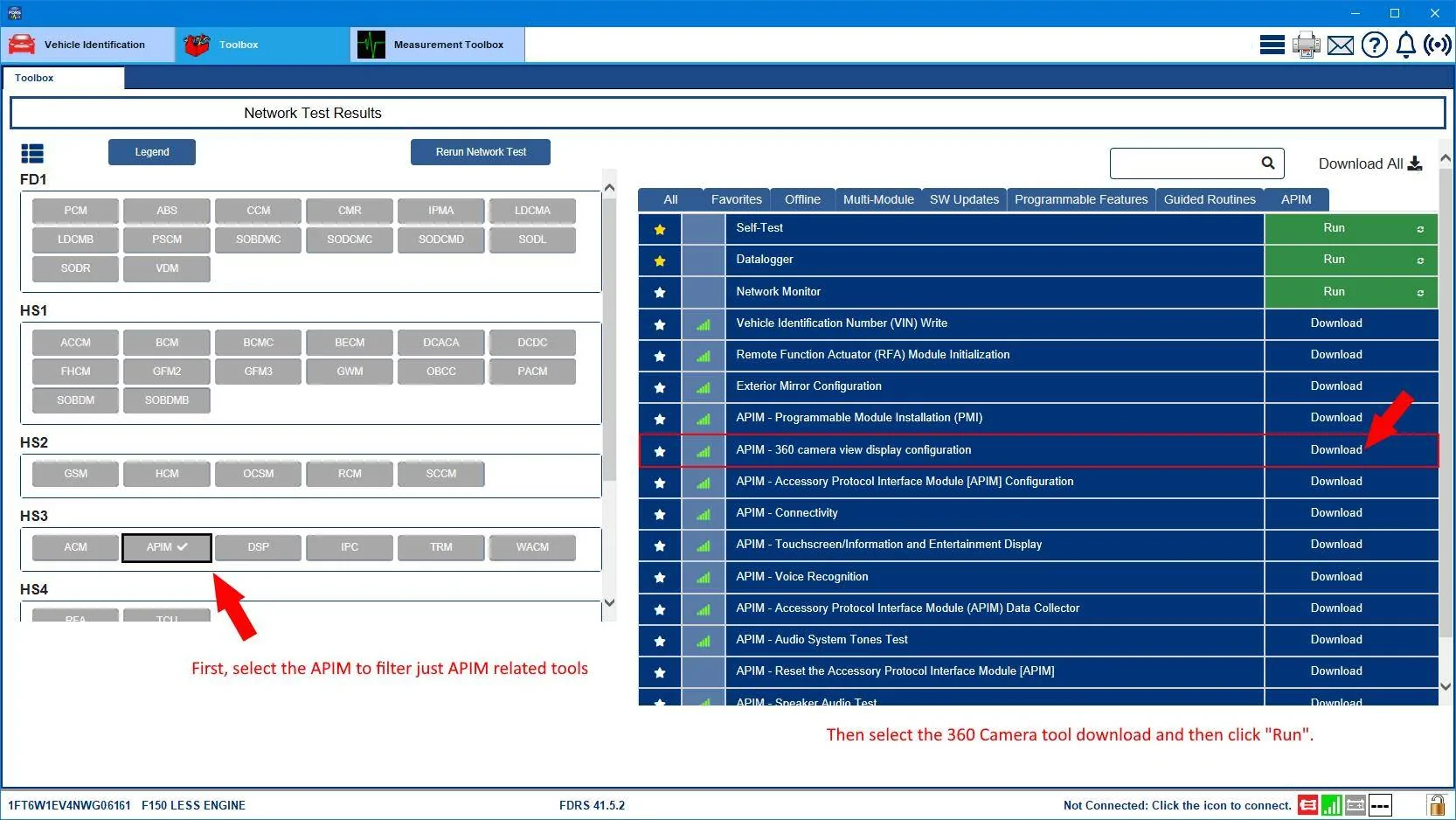

Went back to dealership today after having this CSP applied last week to fix the 'small 360 cam' issue. No luck. Spoke directly with the Tech and he says he applied all the updates (including the 360 camera module configuration). Almost 2 full work days spent at the dealership. Unless there was a misunderstanding I'm not sure what to do now.
Has anyone with the 'small 360 cam' issue gotten it fixed by the dealer yet?

Is your truck a 22? The dealer needs to run the 360 cam configuration in FDRS after the update.

I can't say for the dealer, but if you're willing to DIY, there's a fix via FDRS for the small camera in this post and the following response via Forscan. I ran into this issue after some FDRS updates last month and that solution worked...I did not test the Forscan update to fix this.

Yeah its a 22. Went back to the dealership and requested just this ^^. As far as I know they ran it but it is still the small camera. Thus my question, has anyone with a small camera been able to have it fixed yet.

Yes. But apparently techs are not getting the word. It's a tool in the APIM list that they want...not the 360 config in the IPMA tool list!
Ford F-150 Lightning CSP 24B56 - Inoperative Front Parking Sensor(s) - IPMA Software Update for Certain 2022-24 F-150 Lightning Trucks Lightning_360_cam_small_screen_fix
