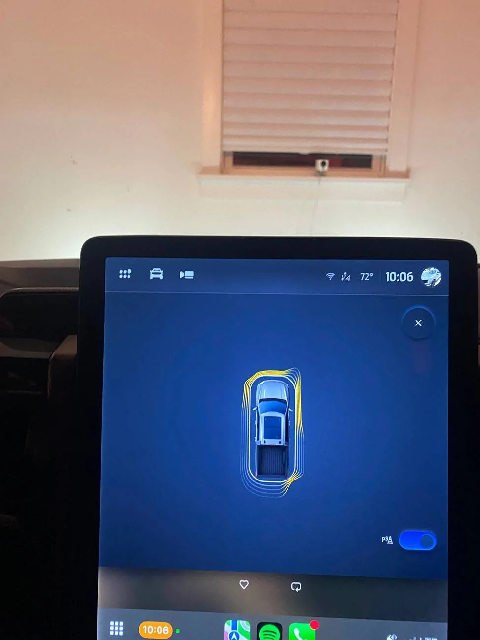

I think it’s worse. My 360 camera is now small and also when I pull up to something in front, like the wall of my garage, the front facing camera no longer pops up. I just get a diagram of the truck showing which sensors are detecting something.
Well that sucks. I just get nonstop beeping and failed front parking sensor errors until I disable the front parking sensors (and this is post “fix”).
