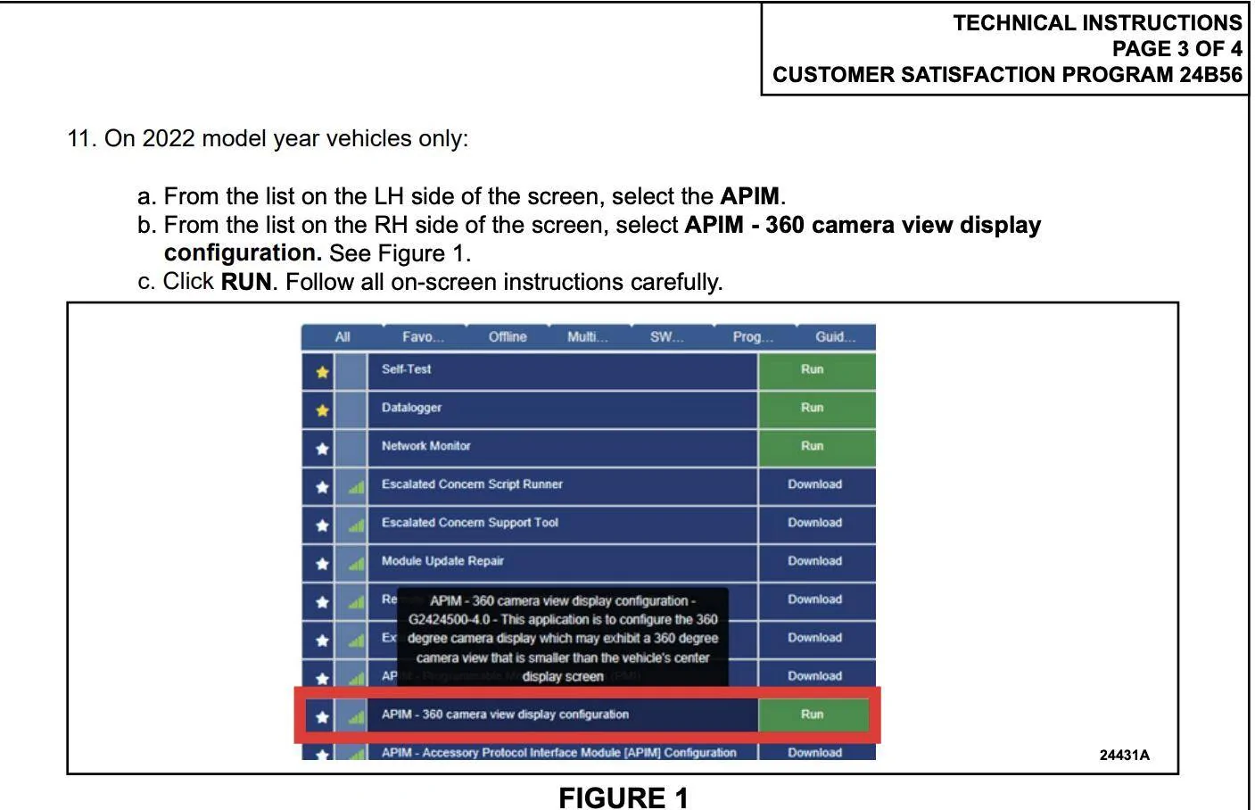

It's interesting folks are reporting this as it's called out in the tech document for 2022 model year vehicles.
Clearly the techs are not fully reading/comprehending the clear instructions.
Thanks for this. I will go back to my dealer next week and try to have this configuration updated. Sounds like this should be quicker.
Anyone else considering this CSP should check their camera carefully before they drive off after this update. Perhaps even good to verify with the service/tech that they would complete all the items on this list... in a nice way of course. Don't want to tell anyone how to do their job but it does seem like this one is falling through the cracks.

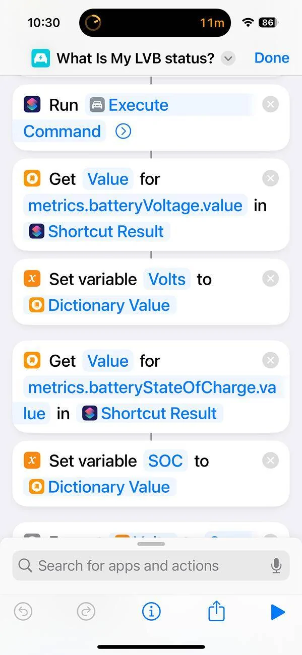

Reading my receipt over it appears they replaced the 12v battery yesterday to try and address the situation with the IPMA not updating. This morning the LVB is 14.62v and 27% SOC. running truck now to see if I can improve the SOC. Maybe they did not reset the BMS? Thoughts?
215
15,751
17,666
Was truck [ON] / [ready to drive] mode, if so I suspect the voltage you see in the DC/DC inverter actively charging the LVB. Shut down the truck and measure the LVB to see its resting voltage.
VTRedWingsFan
Jul 7, 2022
246
205
Vermont
2023 F-150 Lightning Lariat ER, 2020 Escape
IT delivery
The Truck was not on at the time. I got the numbers from my IOS shortcut.
215
15,751
17,666

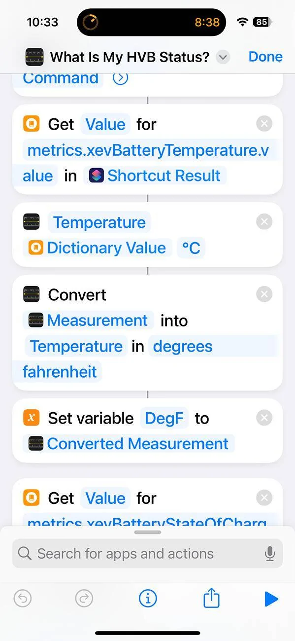

If you're using the value on your Ford.com / Account screen, that's no longer the LVB, they fixed the programming and now it represents the SOC of your traction battery.
VTRedWingsFan
Jul 7, 2022
246
205
Vermont
IT delivery
No, Ford API more or less.

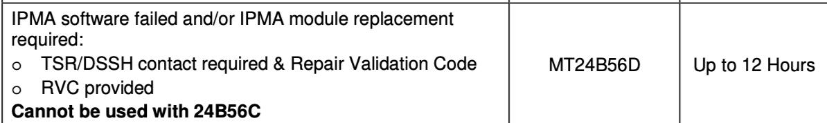

Update on mine, update is still going we are at 20 hours. Dealer wants to keep it running until the afternoon. Seems insane as I'm reading this bulletin... I am I wrong for telling them to stop it and try again?
