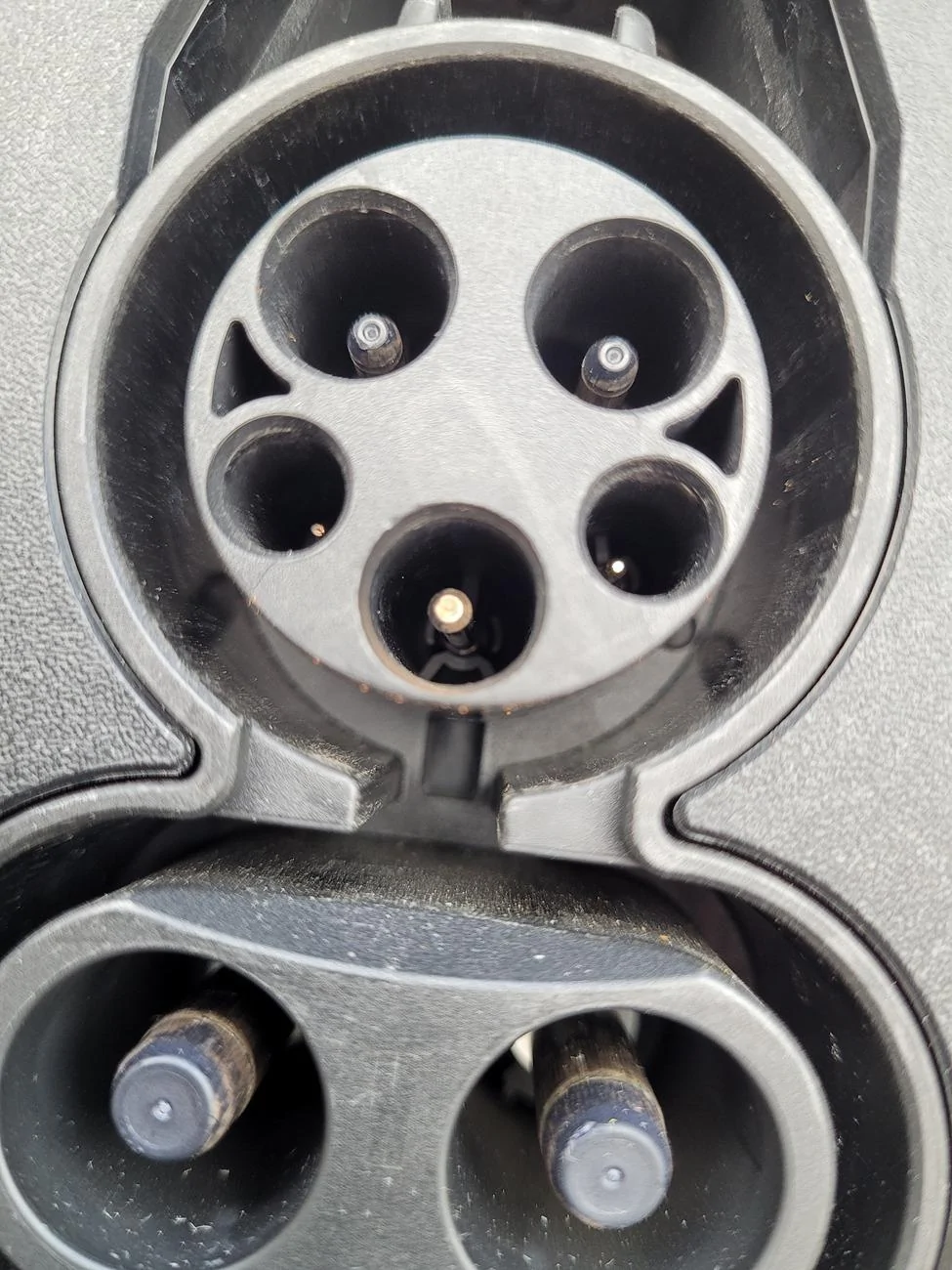

It's hard to tell. The large on on the bottom looks like copper. So are the two little ones on each side of it. The two upper ones look silver colored. The 2023 truck has been parked outside for it's whole shot life. It's rains frequently here (PNW)
Ford F-150 Lightning "Current Leak" fault with Emporia 48A EVSE, ? dirty or damaged J1772 terminal? 20240819_142443

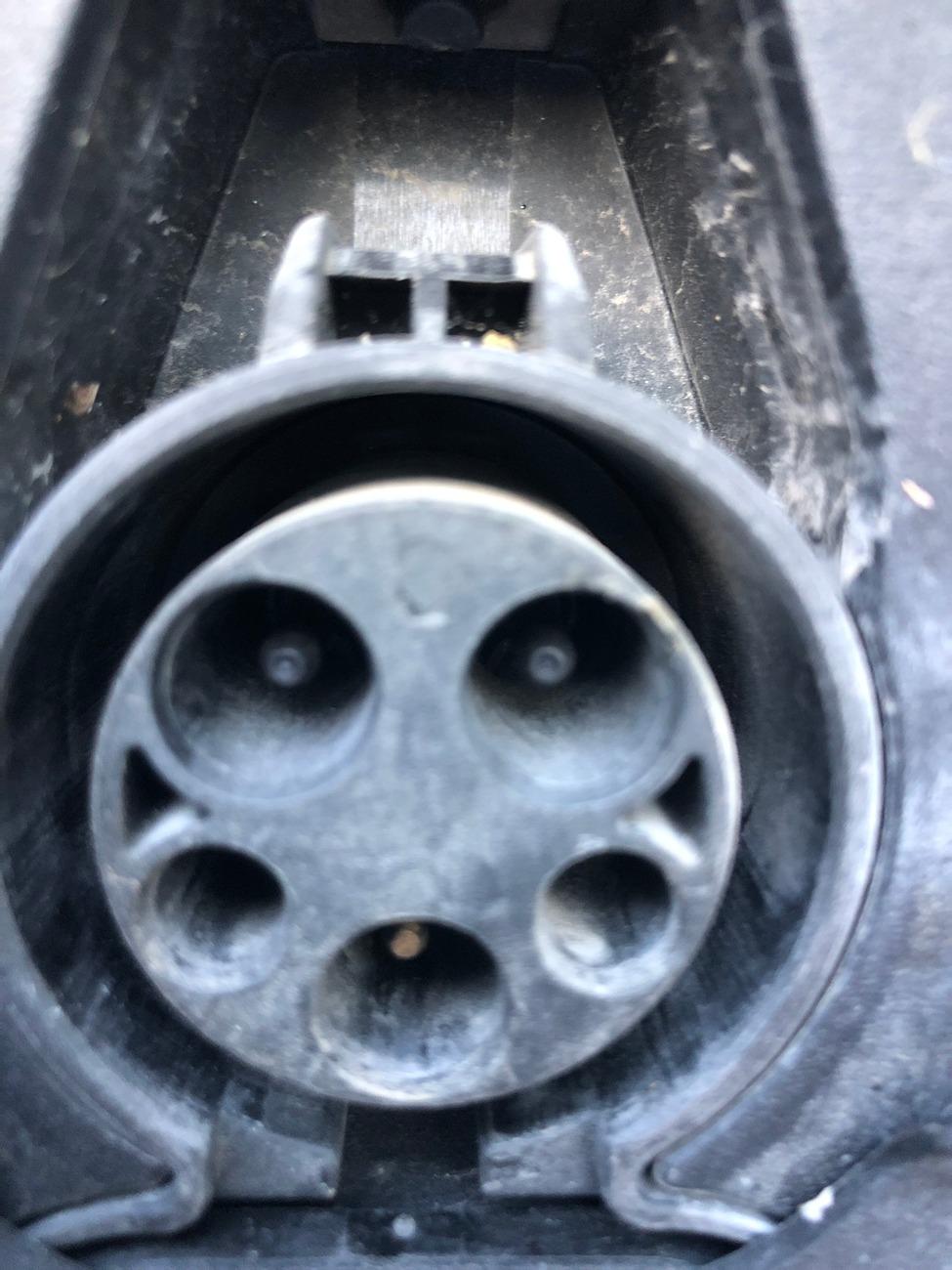

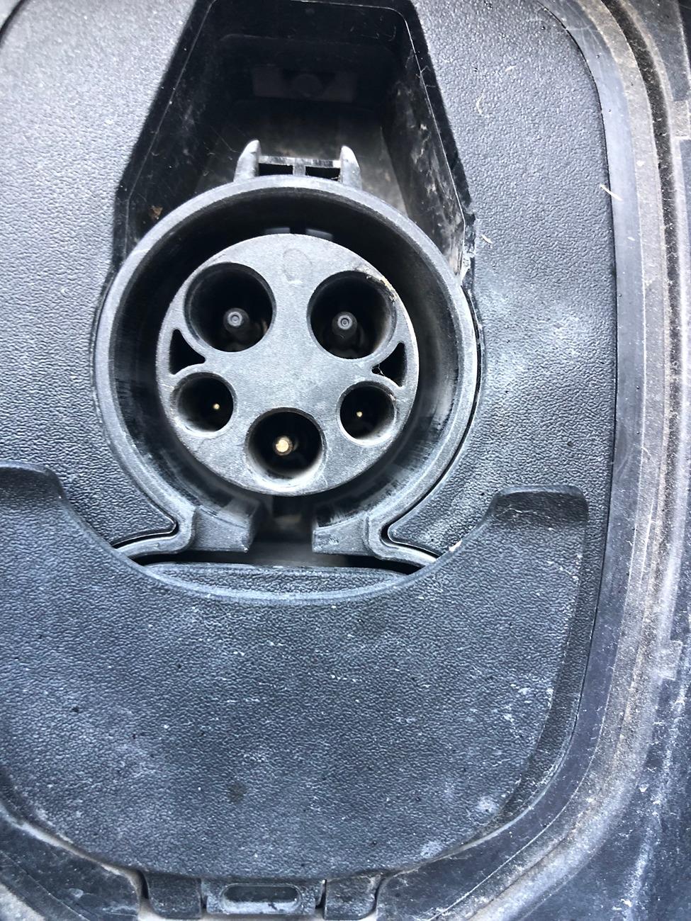

Ford F-150 Lightning "Current Leak" fault with Emporia 48A EVSE, ? dirty or damaged J1772 terminal? 1724114967272-jo
Ford F-150 Lightning "Current Leak" fault with Emporia 48A EVSE, ? dirty or damaged J1772 terminal? 1724115036833-ii
Looks nasty compared to the other guys photo. This Lightning lives in a dusty dirty environment. Not much dust when charging, but the charge cover on the Lightning leaves something to be desired.
I'm researching how to clean these correctly, and I am contemplating derating the 80A charger to reduce the heat that must be happening.
One thing -- NO WAY am I putting grease on a terminal out there. Out there, grease attracts the dust. Makes things worse. Read one thread so far about just using isopropyl etoh and q-tips. Still looking to find out it a spray "electronic parts cleaner" would be safe. I would think so, but.....???? We have a lot of trouble out there with dirt.
