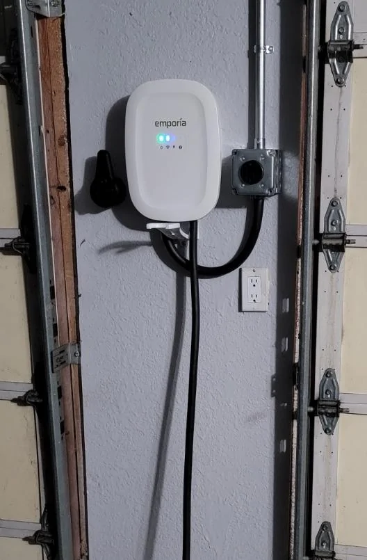

Bought the Emporia EVSE and hard wired it for 48 A operation. The knockout hole for the power cord it came with is the size needed for 1" conduit which worked out well as I planned to use 1" PVC as it had more than enough space for a pair of #6 and a #8 T90 Nylon conductors.
Like @Pioneer74 I liked it so much I bought their home energy monitor for my main panel and subpanels for several reasons, but it allows me to monitor our "dumb" 32 A EVSE for my Focus Electric.
Ford F-150 Lightning Tell me about your 48A EVSE EVSE2
Con: The hanger for the plug leaves it exposed, and though it comes with a rubber cover, who really is going to put it on after each use? I bought a unit that mounts on the wall that you plug it into when not in use that cost CAD$25 on Amazon
Initially a con: The front cover is held on by screws that must be installed from the backside of the cover's overhang from the box. This is somewhat awkward when installing, but it probably discourages anyone from tampering with it (not that this should be an issue!).

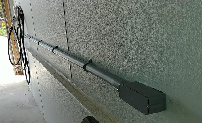

I bought the Emporia EVSE and have had Zero problems with it, it's hard wired for 48.
bought it for the reviews, price and I all ready have there home energy monitor which I love.
I like to charge after 12am so I have Emporia set to charge at 12:01 am.

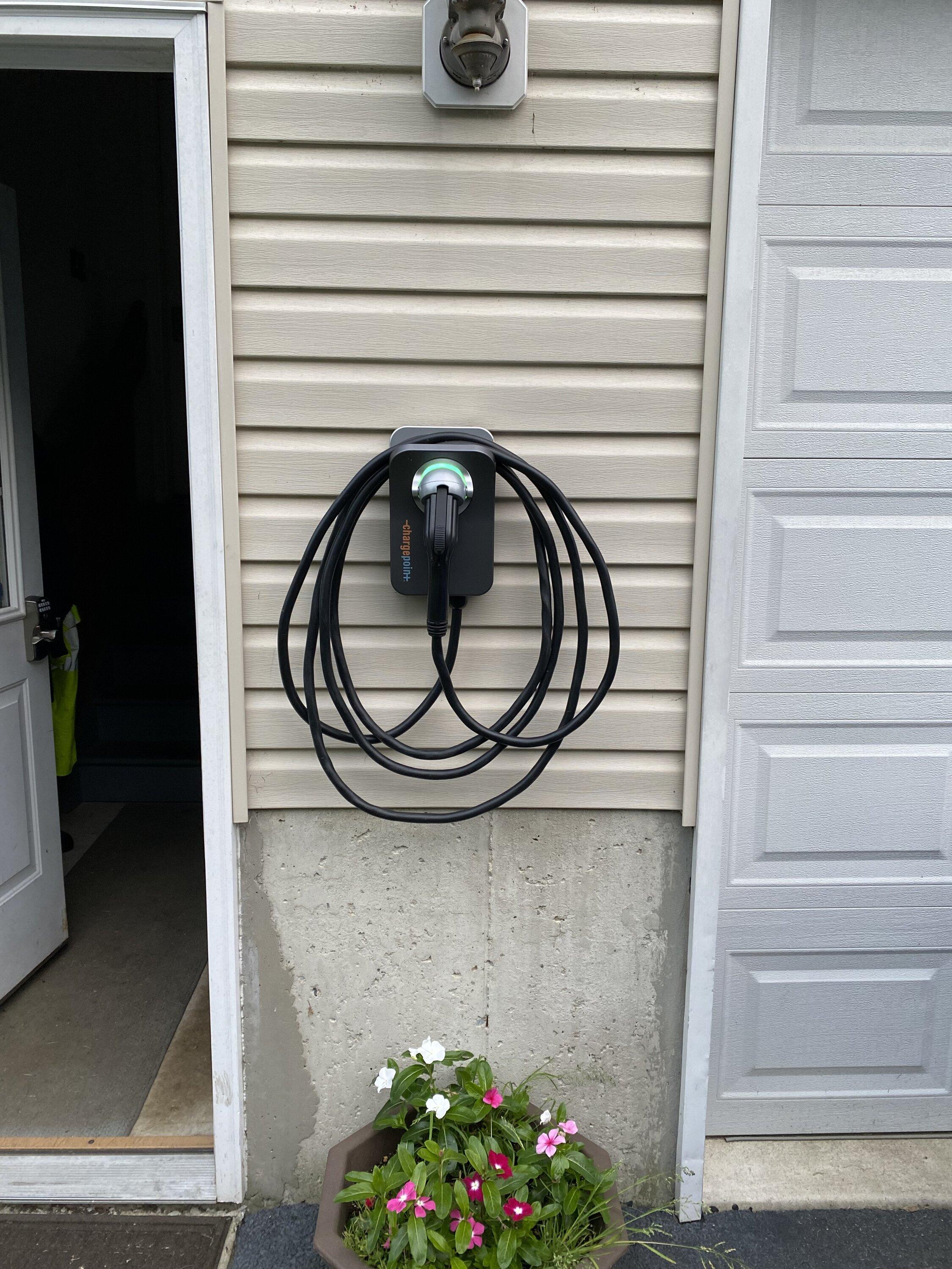

Very happy with the ChargePoint. Sends 48A to the truck when connected to a 60A breaker, also like the cord and plug storage.
I was unable to get the EVSE rebate as others have mentioned in conjunction with the $7500 rebate. Did get a $500 incentive from my utility toward the installation as well as $250 from New Jersey for the ChargePoint.
works good for me as we have ChargePoint 6KW chargers at my work, so most of my charging is on the one app.
