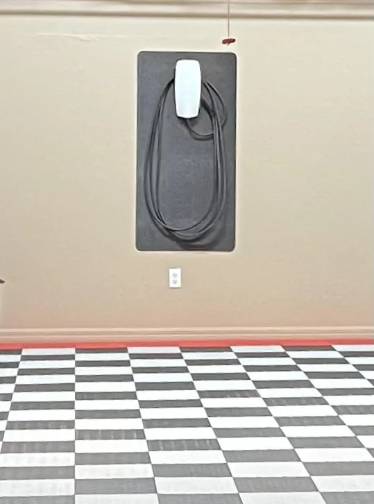

Tesla Wall Connector. Best value on the market- use Lectron NACS:CCS adapter, or order the CCS version of Wall Connector.
