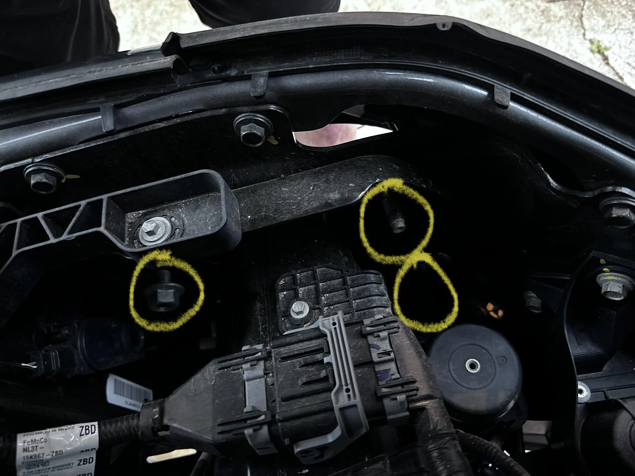

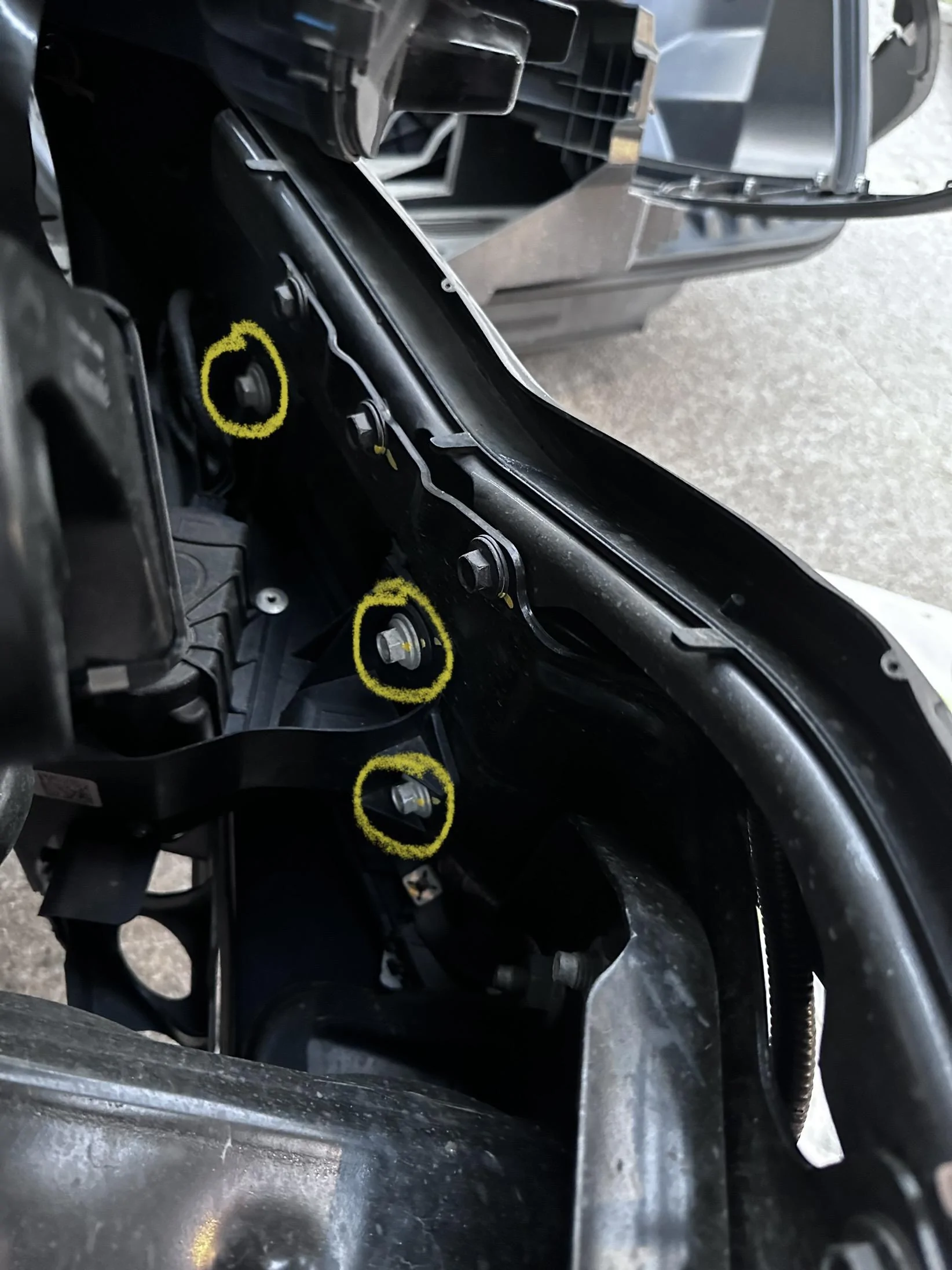

I have the parts in and will do the deed on Friday with my 22 XLT Lightning. Where exactly are the six bolts located on the bumper?
steveje
Steve
Mar 25, 2023
Greensboro, NC
2022 F150 Lightning XLT
I tried taking a few pics. There are 3 on each side. You can see them once you take some trim off at the top of the bumper. One of these pics already has the nuts off.
Thank you very much.
Thanks for these pics, is it a requirement that the frunk tub comes out or can these be accessed withjust removing that piece of trim?

The frunk has to be removed. I can’t see how to get to the trim without removing the frunk tub.
