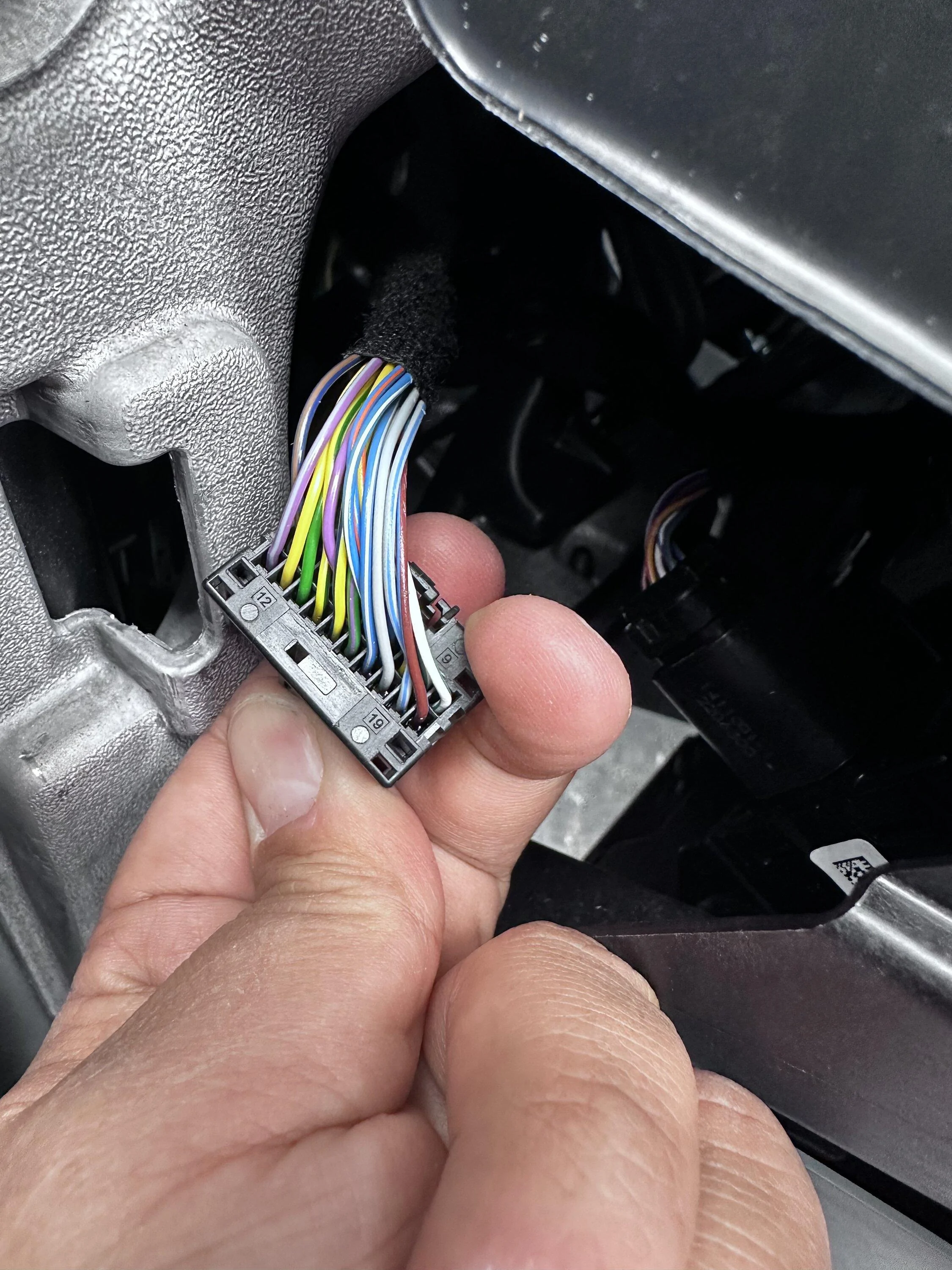

@BennyTheBeaver and @Brotato , I checked my harness going into my IPMA. It looks like I'm prewired. Just adding a data point for you if you guys are looking into things.
Thank you, so far it looks like 2022 XLT is good, 2023 Pro needs extra wiring. Unknown on 2023 XLT or 2022 Pro.

Hmm maybe. I have 311a. I just scanned the post you linked and I’ll look closely after work and start checking connectors. I’m comfortable running additional wiring so at least this still should be possible for me. Thanks for the suggestion, that’s a big help.
I checked my 22 XLT and it is populated.

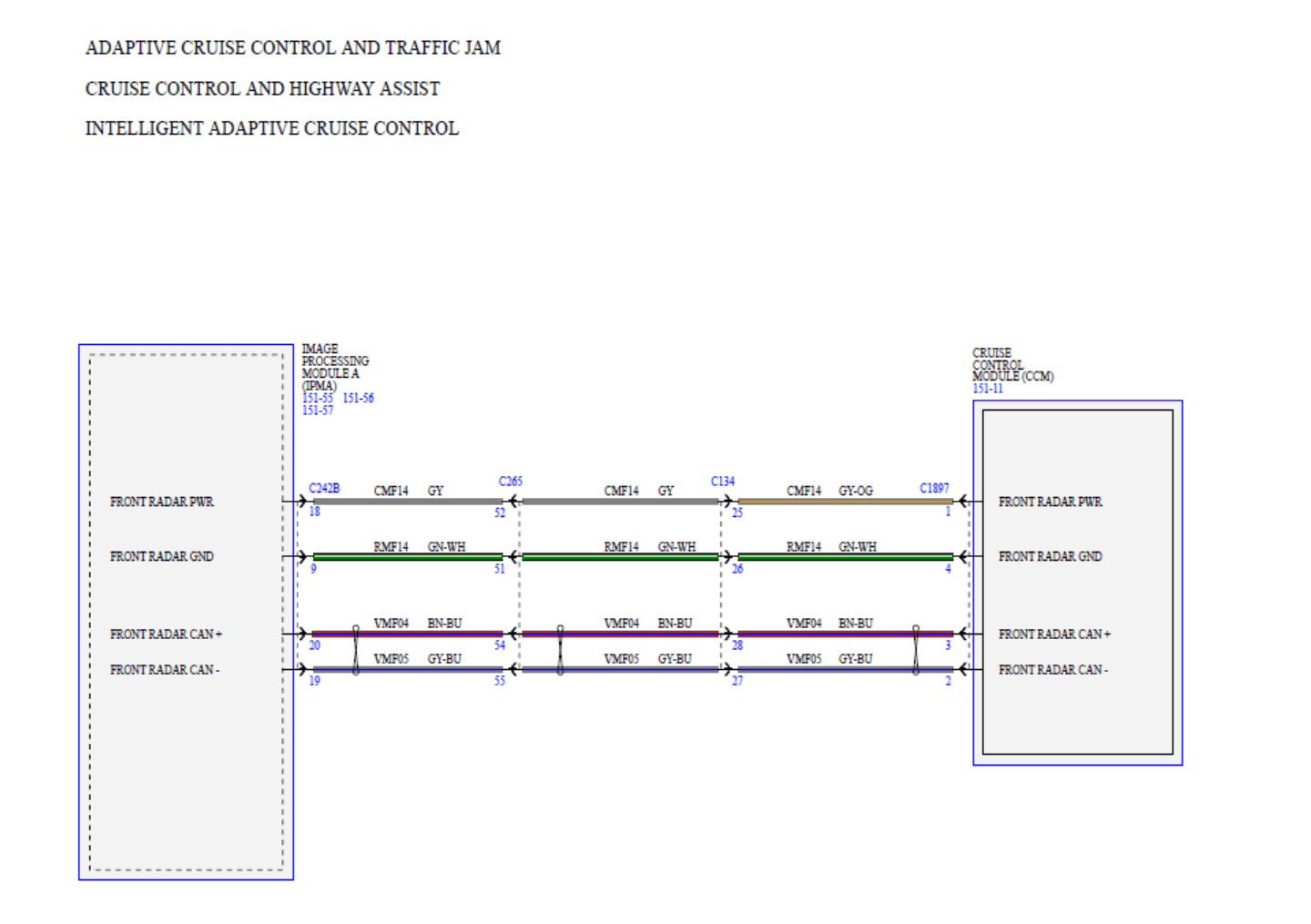

Any idea what my issue could be? I'm still not getting the CCM to be found in forscan.
Missing wires. It's not going to magically appear so you can stop trying.

Haha I love the simplicity. So if I have the right harness plugged into the CCM and I'm prewired for CCM, I'm missing something in between you think? According to the diagram (found on the ICE forum), there are intermediaries between them. Sorry, not sure what I should be saying correctly.
The simplicity of my response is due to not knowing what wires or the solution at the moment. I haven't actually attempted the install yet, just repeating what I've heard and read from another attempting it on a 2023 Pro.
I just saw you repeating your question with no one answering...
Edit: Just realized you have a 2022 XLT, my response isn't applicable to your install. I'm sorry.
