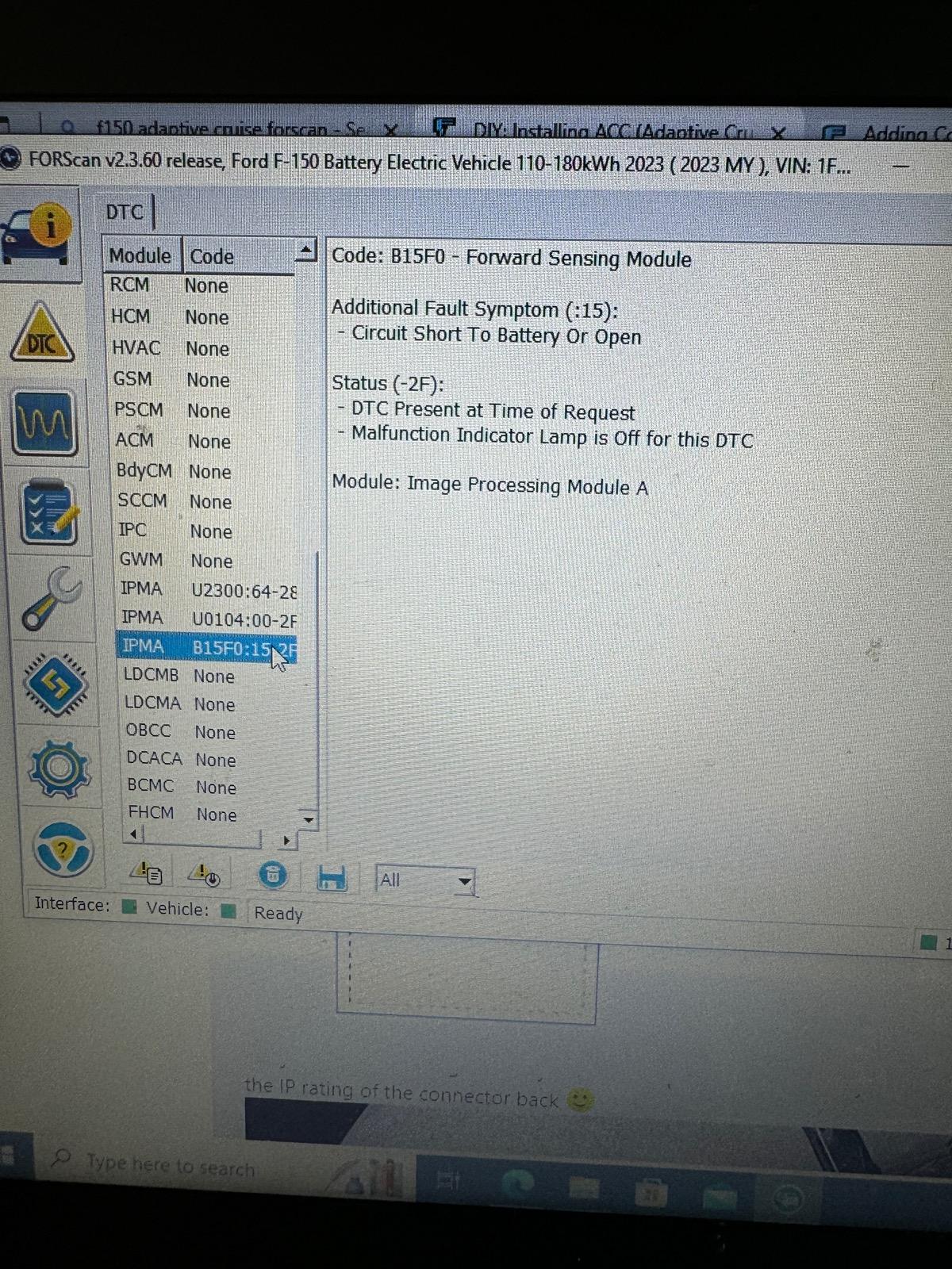

I am having same issue and Forscan throwing Circuit Short Battery error. Checked radar module receiving 12.9v from the IPMA but can't get it to populate. Any help is greatly appreciated and I hate to give up.

Did it work for you?
This has to be a wiring issue. You have to check every pin and wire color all the way from the CCM to the IMPA, EVERY point, verify it with the diagram listed in this thread and make sure you know the pin #'s and which direction you are looking at the connectors or plugs.
@ZSC100 Qaplakh! I had read the numbers upside down 😔 Needed somebody to tell me that. Appreciate you!
