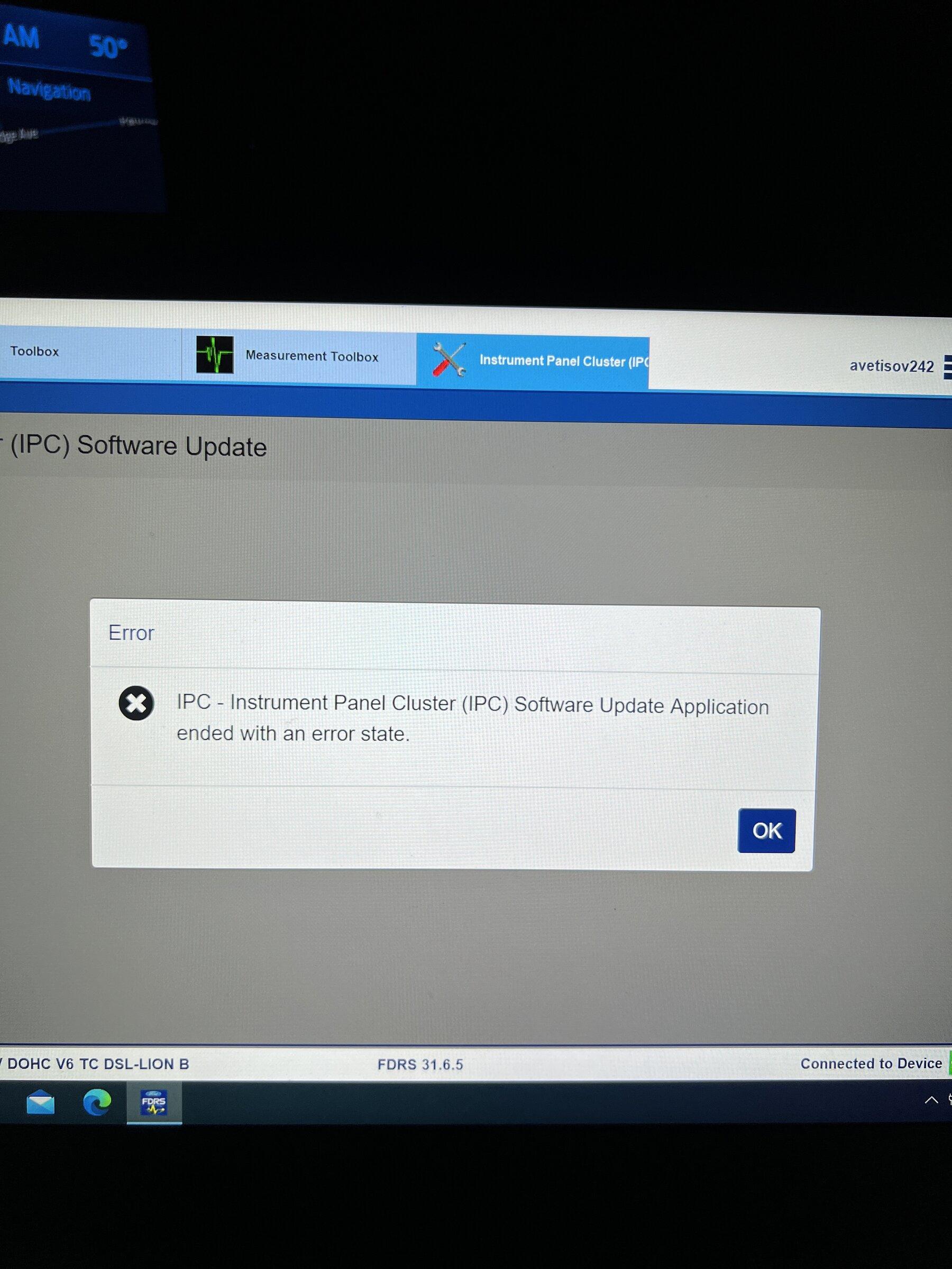

Anyone know why this keeps happening? GWM does this too. I updated the IMPA, PSCM, and GSM And they went through but they won’t leave the list either. Just stay there with a green Run button next to them.
Typically if an update involves multiple modules and fdrs doesn’t run through them all sequentially it claims the update ended in an error state because the other updates didn’t run
Not sure if what I said made any sense
People are also NOT paying attention to the posts in this thread where some modules like posted by @Platinum Peasant will still show up even after a successful update. I am personally getting hammered via Conversations from many and they're thinking a PMI is going to resolve the issue.

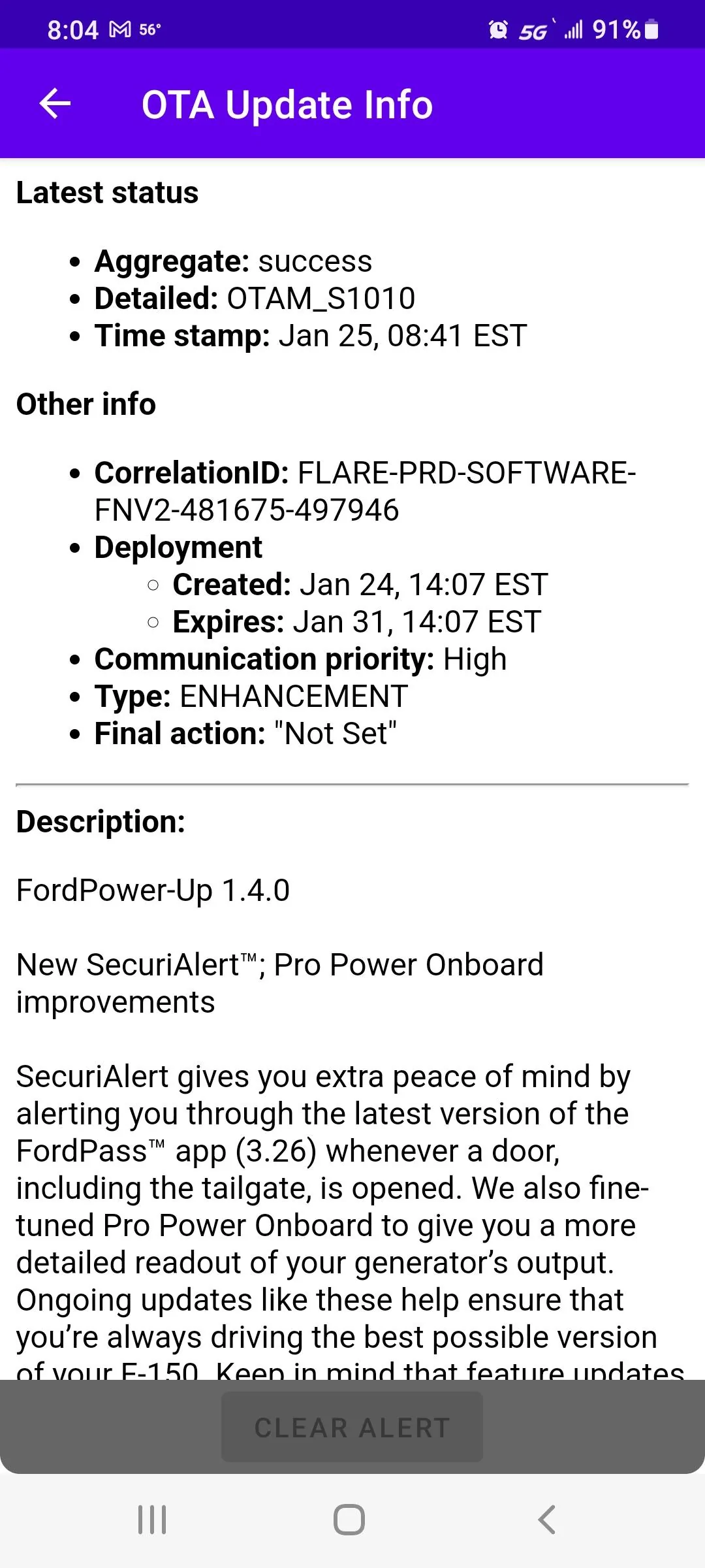

So according to the widget this is the last OTA
Ford F-150 Lightning ECU module programming guide using FDRS Screenshot_20220318-080436_Mach-E Info
I got. I have done all updates via FDRS with a mongoose. Im showing Handsfree in my sync screen

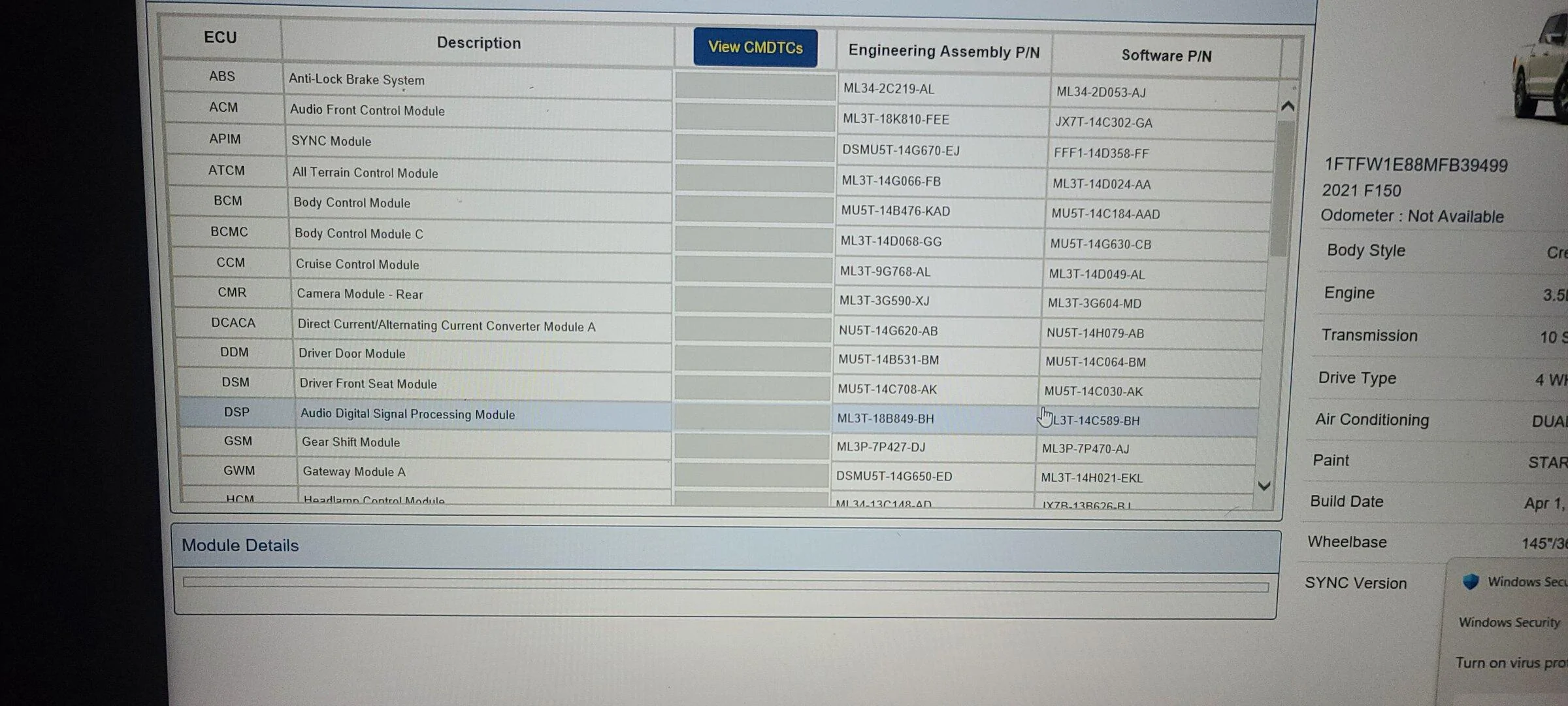

available until 10/9/2022 but not a word in my connected services or email or notification in Fordpass showing Bluecruise is available. I went for a ride on known Bluecruise Highways and got nothing. Not even my regular adaptive steering was working as usual. Now it was pouring rain so not sure if that had anything to do with it. I tried looking at my history in fdrs but I just noticed that the last session saved was March 4th. Im on FDRS daily as I have a year license. Not sure if initial GWM update failure
Ford F-150 Lightning ECU module programming guide using FDRS 20220317_171216
has anything to do with Mothership not being updated. I know my updates went through. But I am showing minor corruption reported in my apim as shown here
Ford F-150 Lightning ECU module programming guide using FDRS 20220318_060333
. Not sure what to do from here.

I dont see corruption in your apim unless I am missing something.
Should the Software PN be FFF1-14D358-FF
Thats what FDRS was reporting this morning. Yesterday after updates it was ML3T- and nothing else
This is a known quirk of the APIM. It will cycle between three values. But it isnt corruption.
