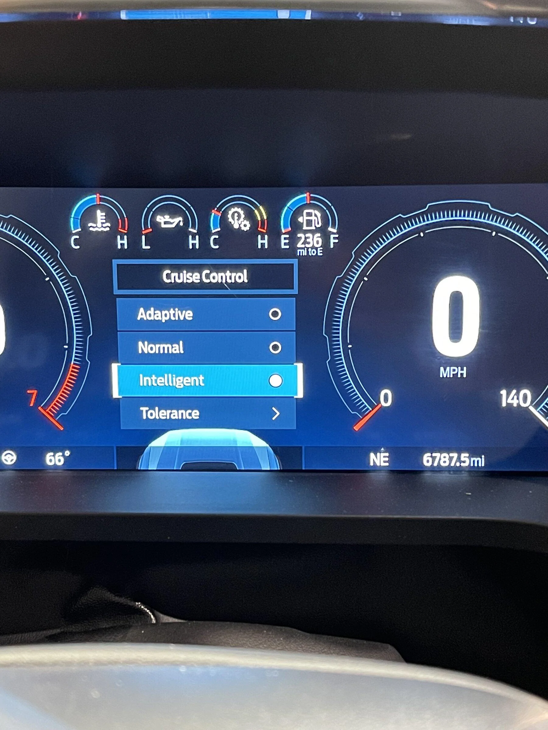

Didn't I just read that none of the raptors will ever get BlueCruise?
@antho
Did you enable the settings in the cluster or do the raptors come with them in the IPC by default
