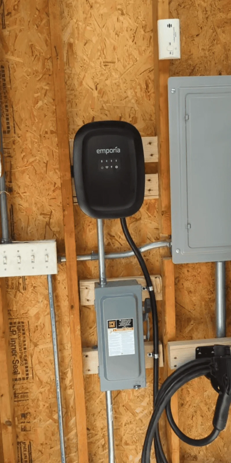

Ford F-150 Lightning Electrician wants to put in a Disconnect for the FCSP 1713468560902-zl

All three FCSPs I have installed were with disconnects per code requirement. The energy audits required a new transformer at one site, thankfully no cost to me.

That is not a propor disconnect.
Which is why I wanted to bring it to the attention of the op.
These disconnects are designed for AC units and not for 100% usage, invest in a knife-style lockable disconnect.
Yeah I've seen the video a few times. That's exactly the reason why I posted it, so the op wouldn't end up in the same situation as the poor man in the video.

Really appreciate all of the information as I am may be spending a little more money on the install but I will have a lot less stress knowing that what I am getting is going to be correct. Plan on copper the whole way and getting a fused disconnect. My electrician was very happy to talk about each component and can’t wait for it to go in. Thank you all for the great information.

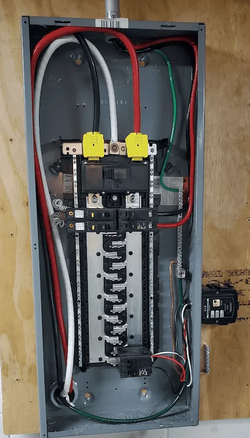

I had this installed at the recommendation of my electrician.
For maximum effectiveness, the wires from the surge suppressor to the breaker should be as short as possible, not looped like that.
