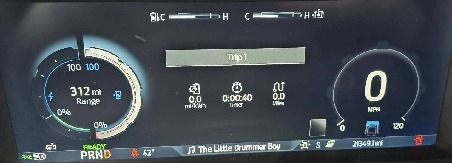

Thanksgiving trip preparation this morning including departure time precondition

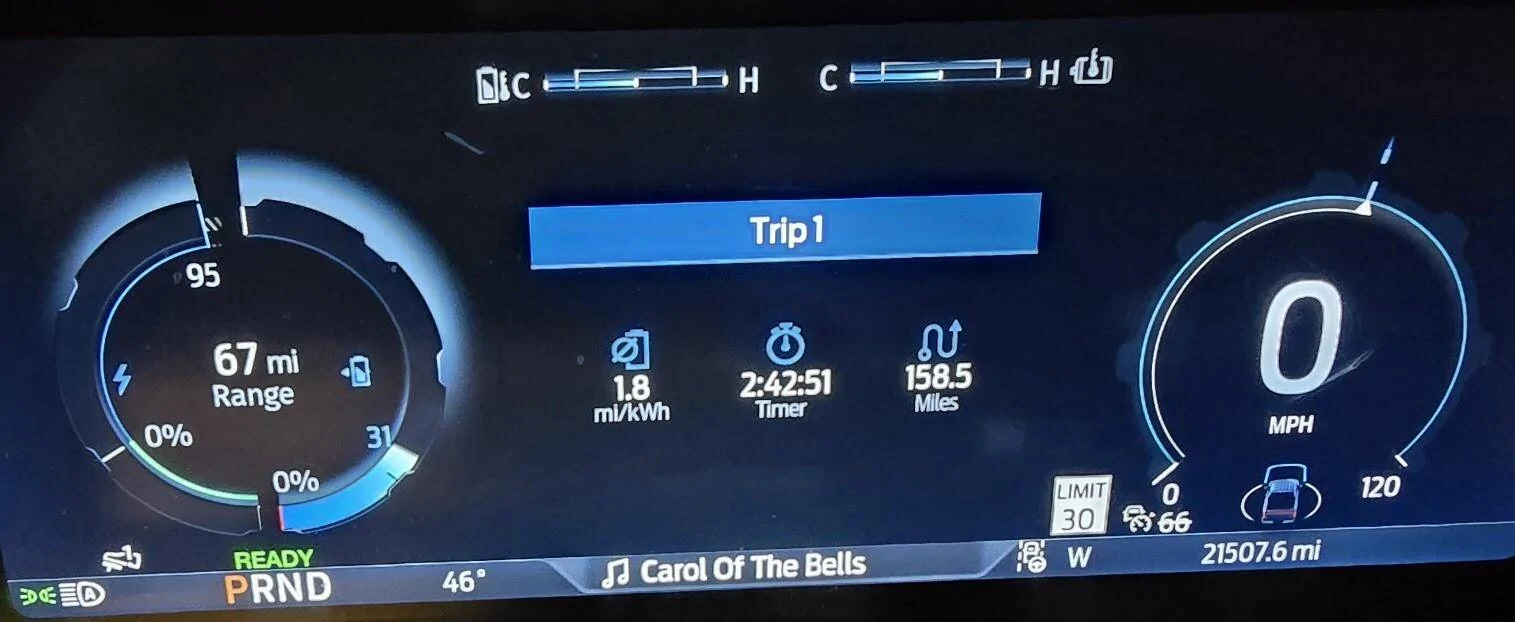

The actuals, cabin temp ~75°
Blue Cruise setting at 66 MPH mostly highway
Ford F-150 Lightning Extended Range 320 Miles??? 1732835596382-hk
Used 69% of 131 kWh ~= 90.39 kWh
Traveled 158.5 miles with 90.39 kWh = 1.75 MPK {mi/kWh}
At that pace driving to zero, (not that I would) remaining capacity 40.61 kWh goes 71 miles
Real life range per my style and operating conditions ~230 miles
That's the reality for me.

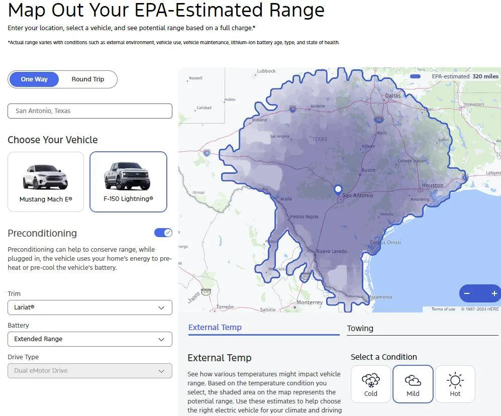

Ford provides a good idea of range on their website: (turn off the precondition and you see the range drop even more)
(y) The map display of the area you can cover is the thing. More tediously, between chosen points, you can find out similar info with ABRP.
What would be great with the Ford map, @Ford Motor Company, would be if you could add further filtering conditions for people like me, e.g., where can I go round-trip using the 80% to 20% SOC range without having to worry about charging to make it back to where I started.
I see they do have the round-trip option, just not the opportunity to specify how much battery % SOC you want to use...
Here we go one-way:
Ford F-150 Lightning Extended Range 320 Miles??? 1732855908387-j5

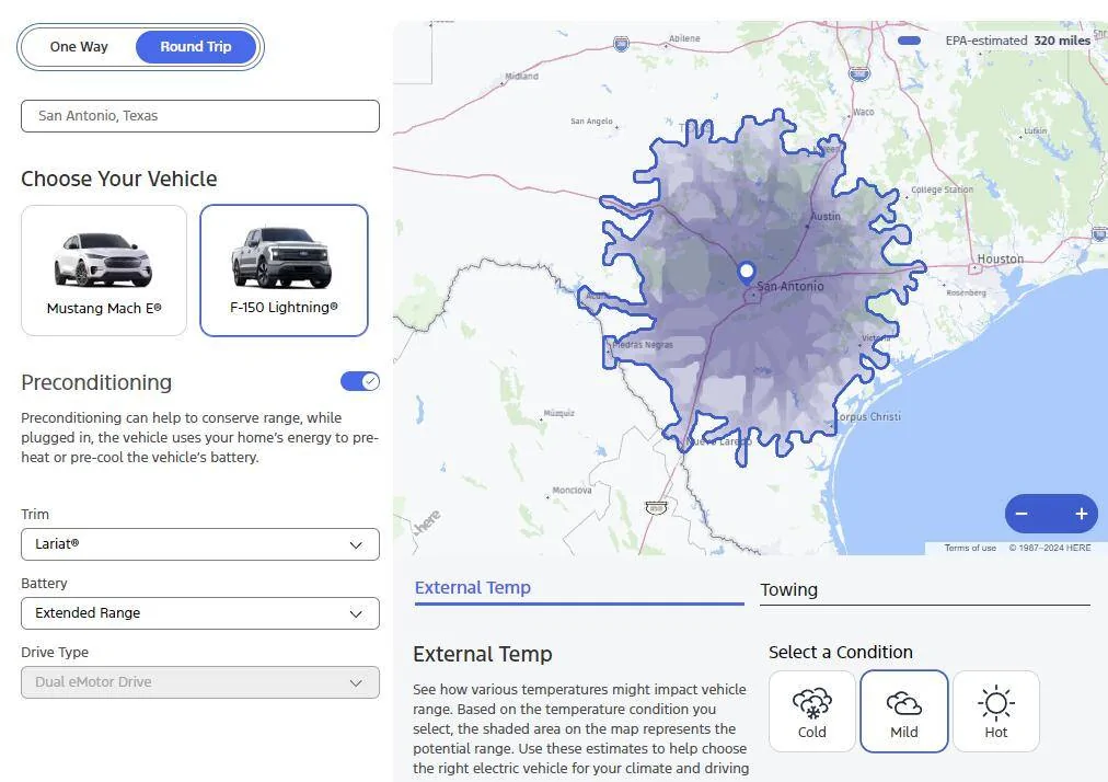

And here's round-trip:
Ford F-150 Lightning Extended Range 320 Miles??? 1732856090840-b7
Source: Ford Electric Vehicles | EV Range & Battery | Ford.com

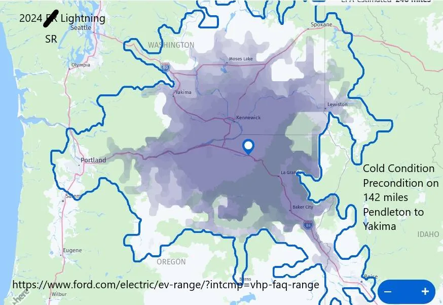

The Blue Line of Optimism. Some one should do a road trip.. following the line.
