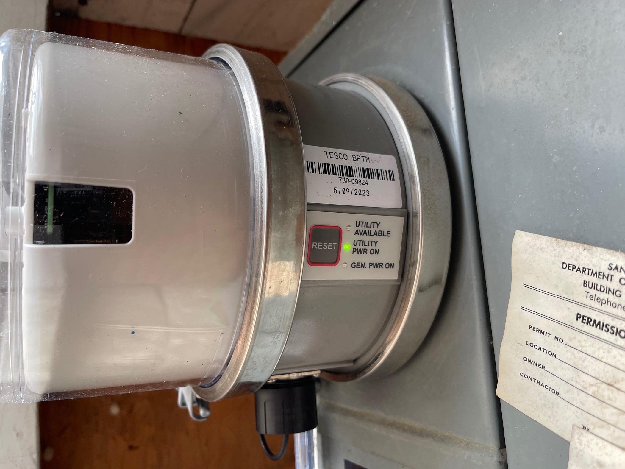

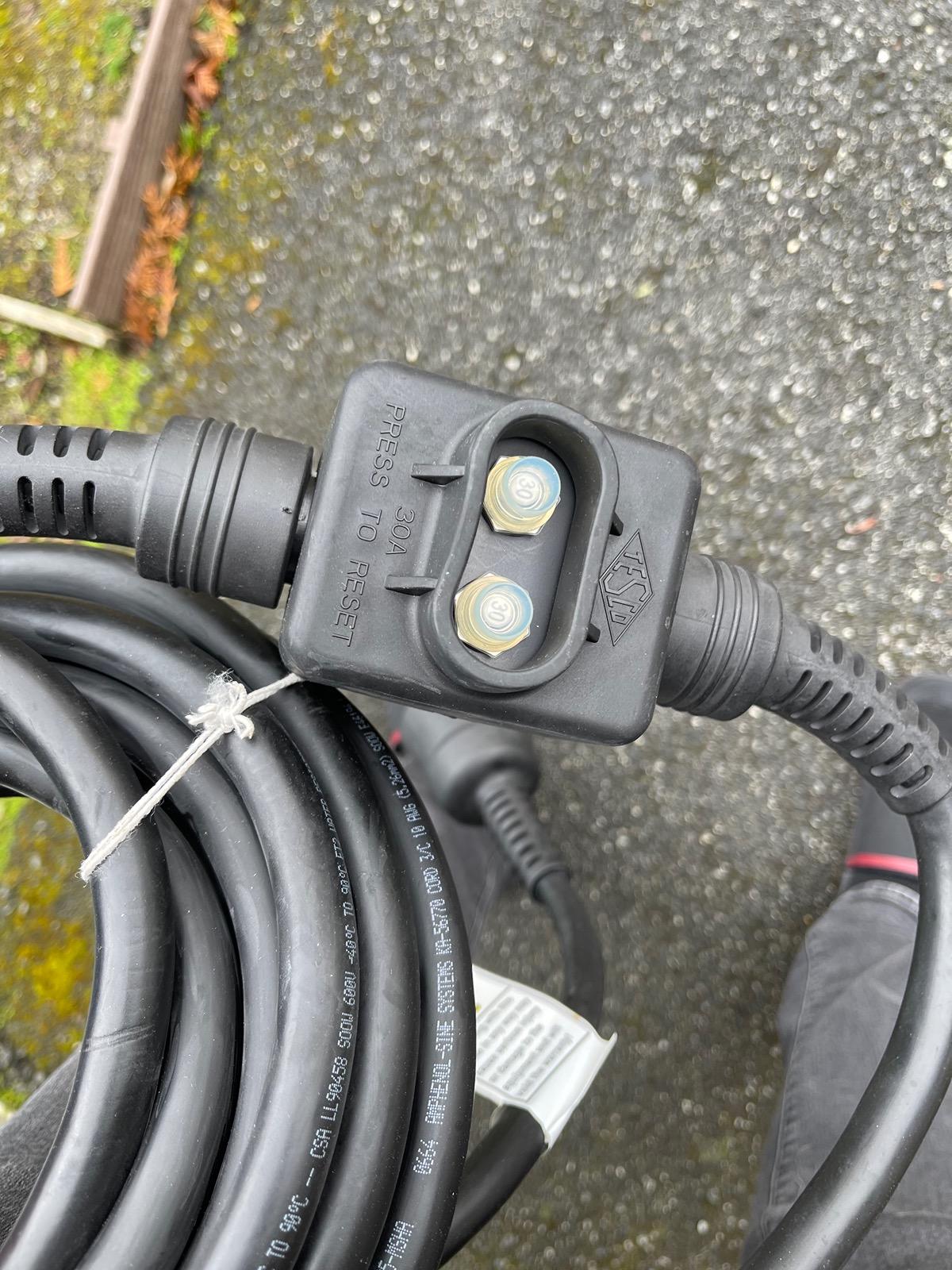

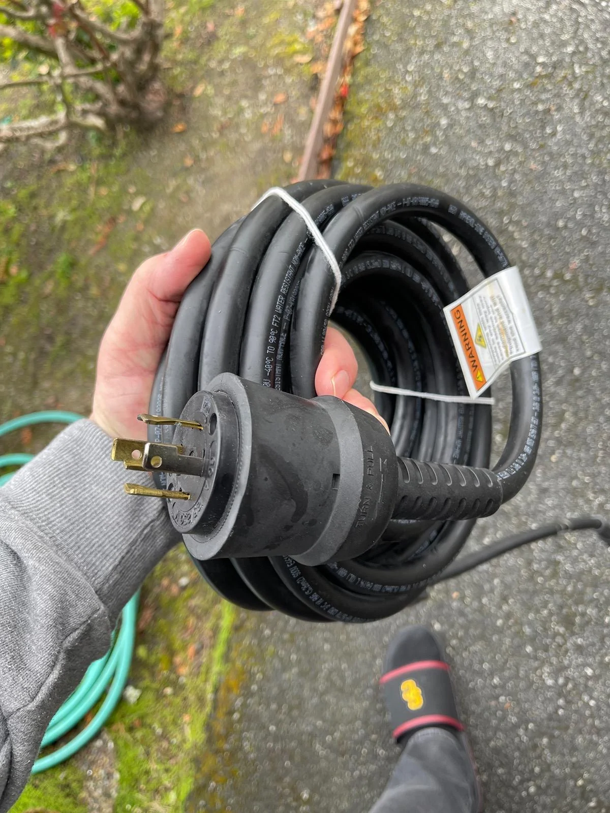

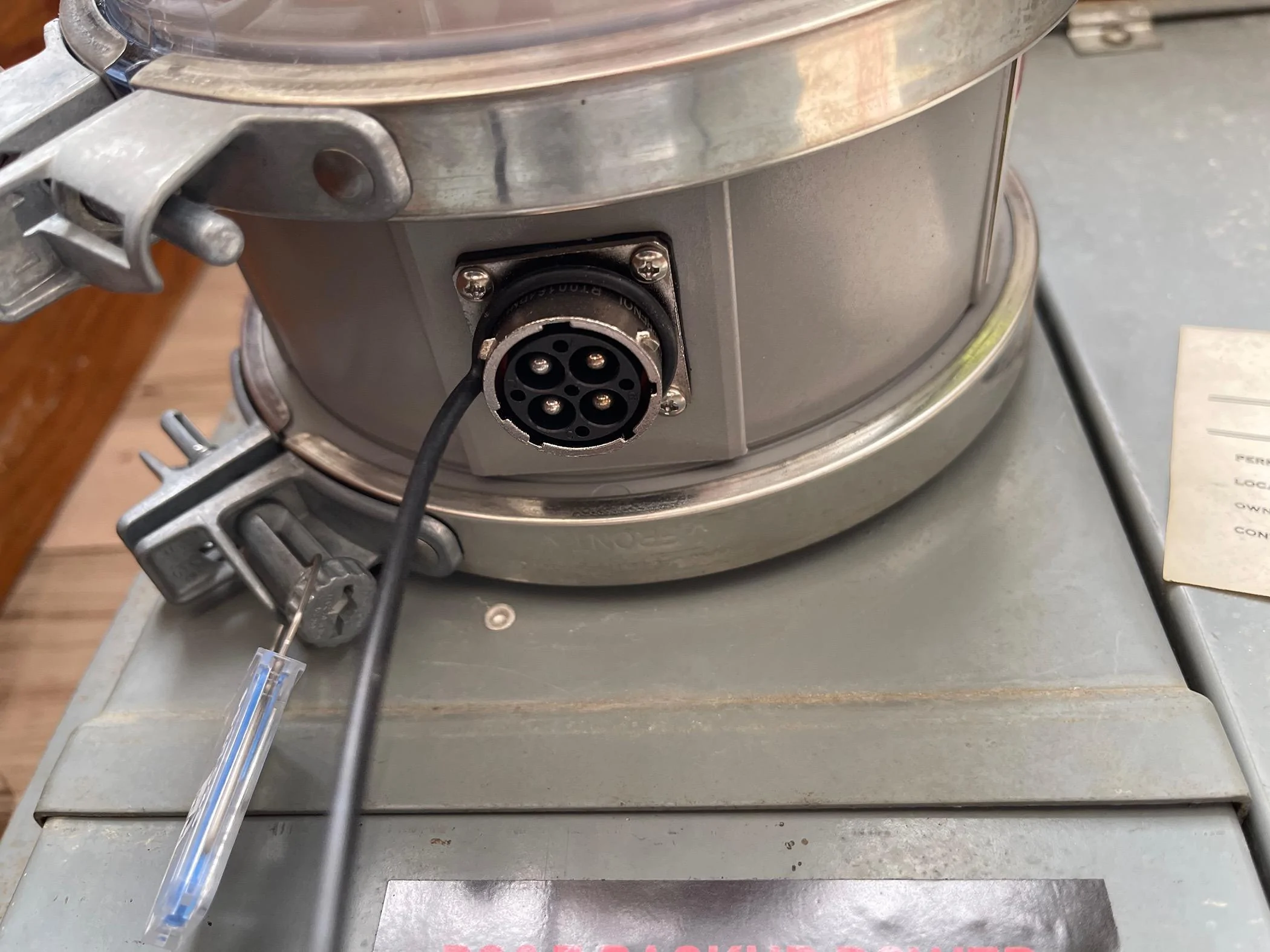

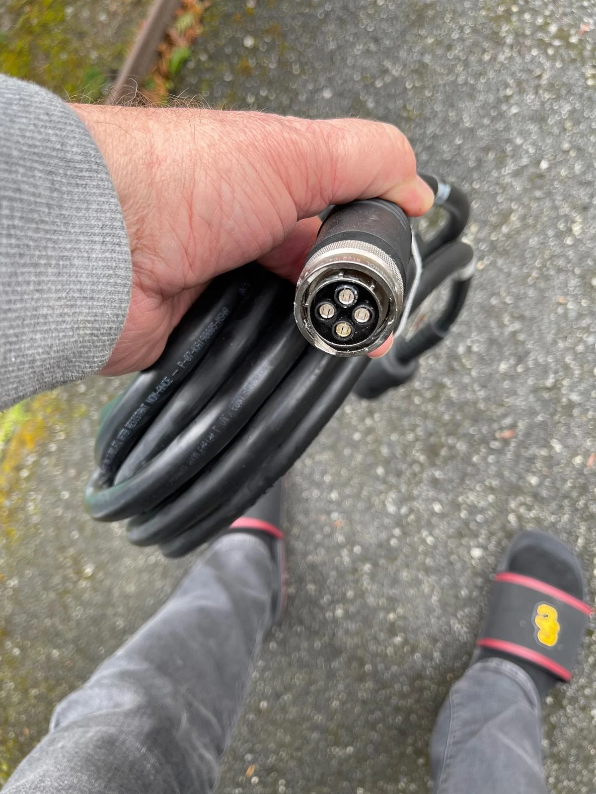

You want one of these. It handles the neutral bonding issue as well. Works for a standalone generator or the 30A Outlet in the bed.
These have to be provided or authorized by the utility company. Mine was installed at no cost by PG&E here in Nor Cal.
If you add solar panels you can create a configuration to charge the truck during the day. This is an advanced topic though.
