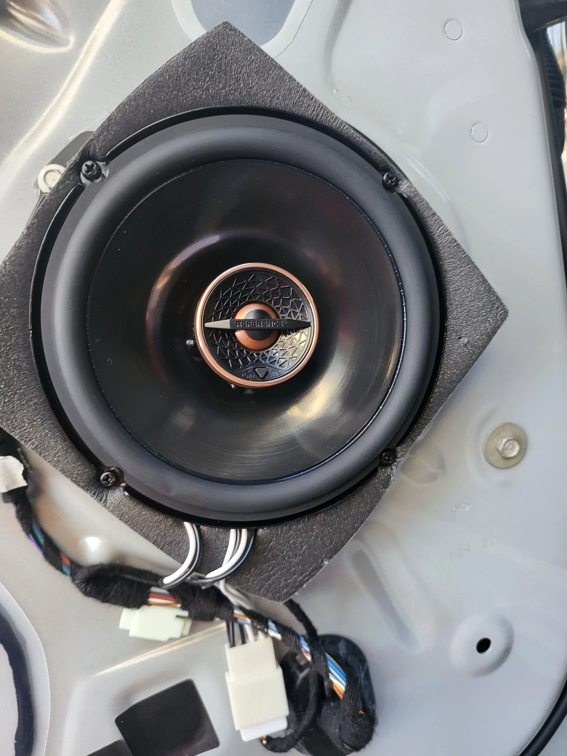

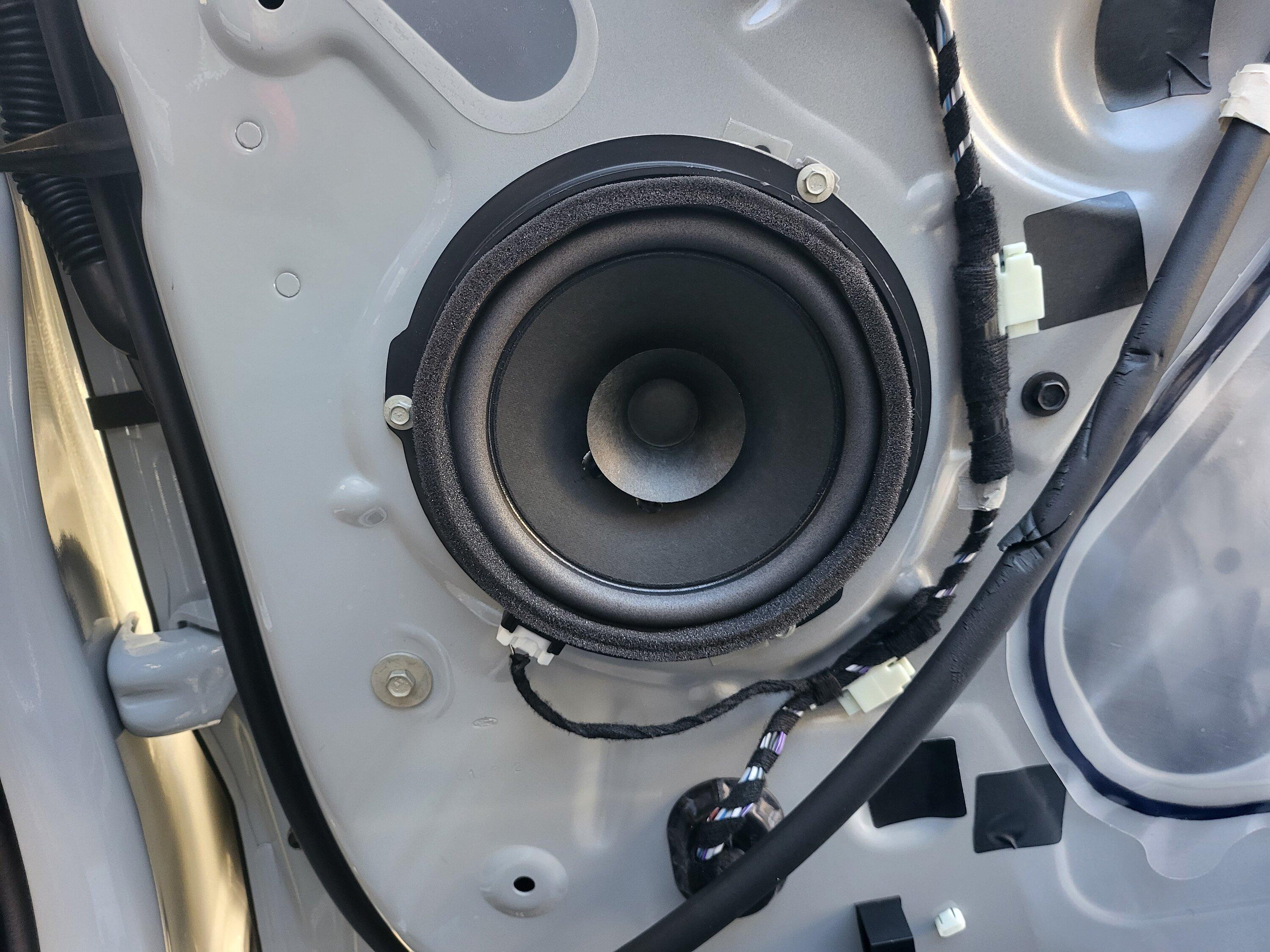

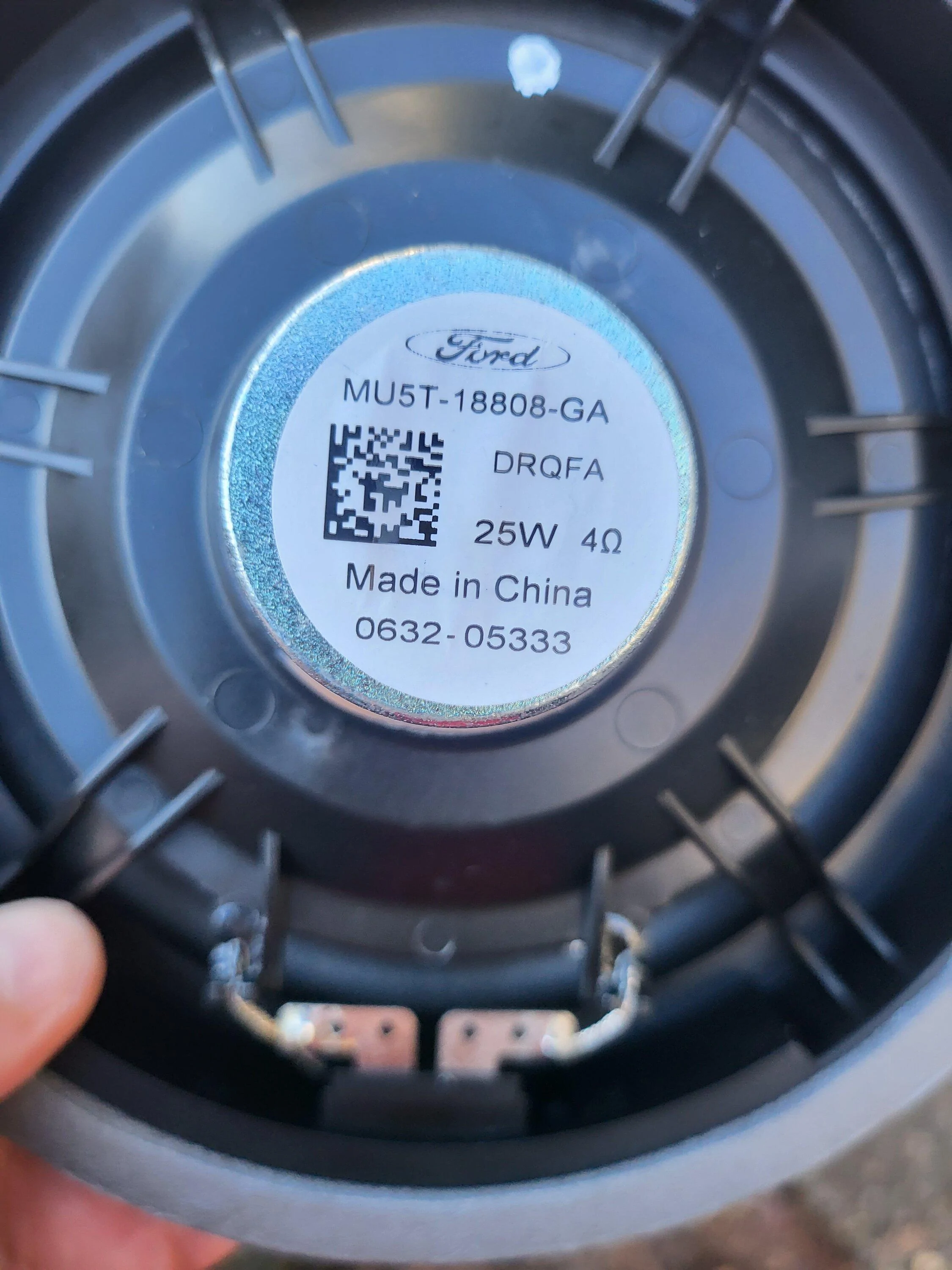

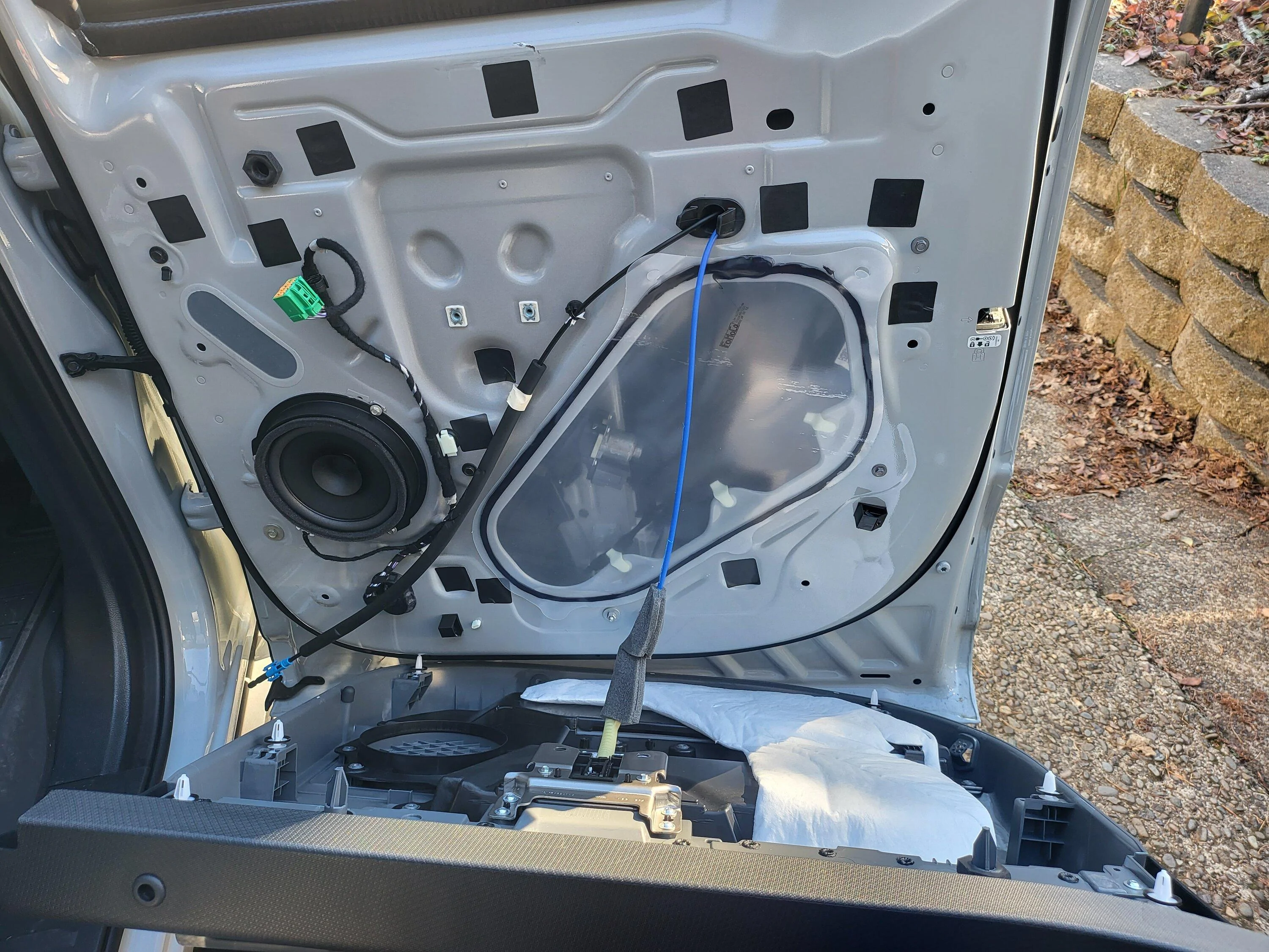

I swapped out my rear speakers today (for a pair of Infinity Reference):
Installed new rear speakers on my Pro today. The stock front speakers actually sound fairly decent, the rear ones are garbage. Here are pics including the speakers I pulled if anyone is interested. Sounds much better now.
