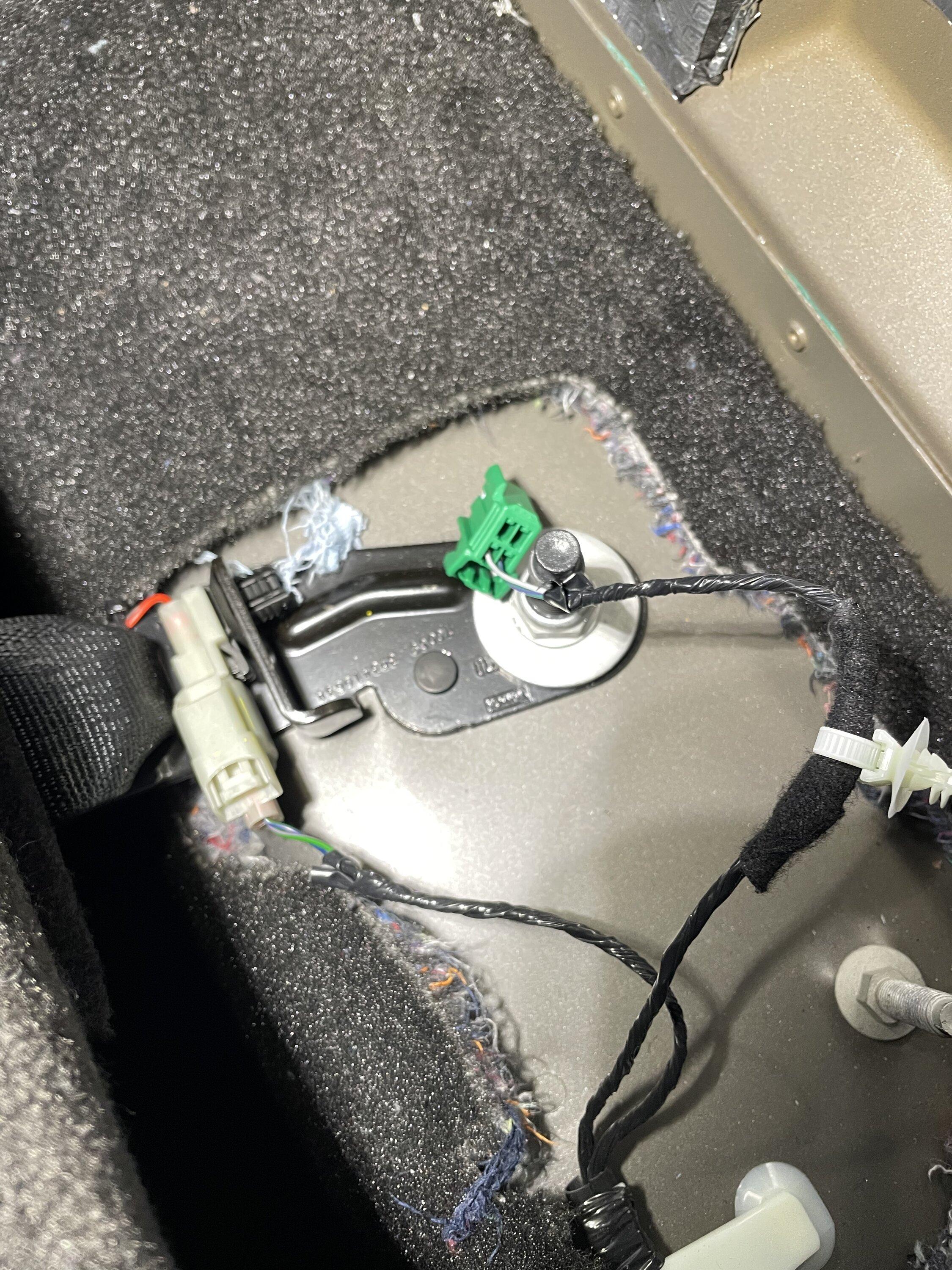

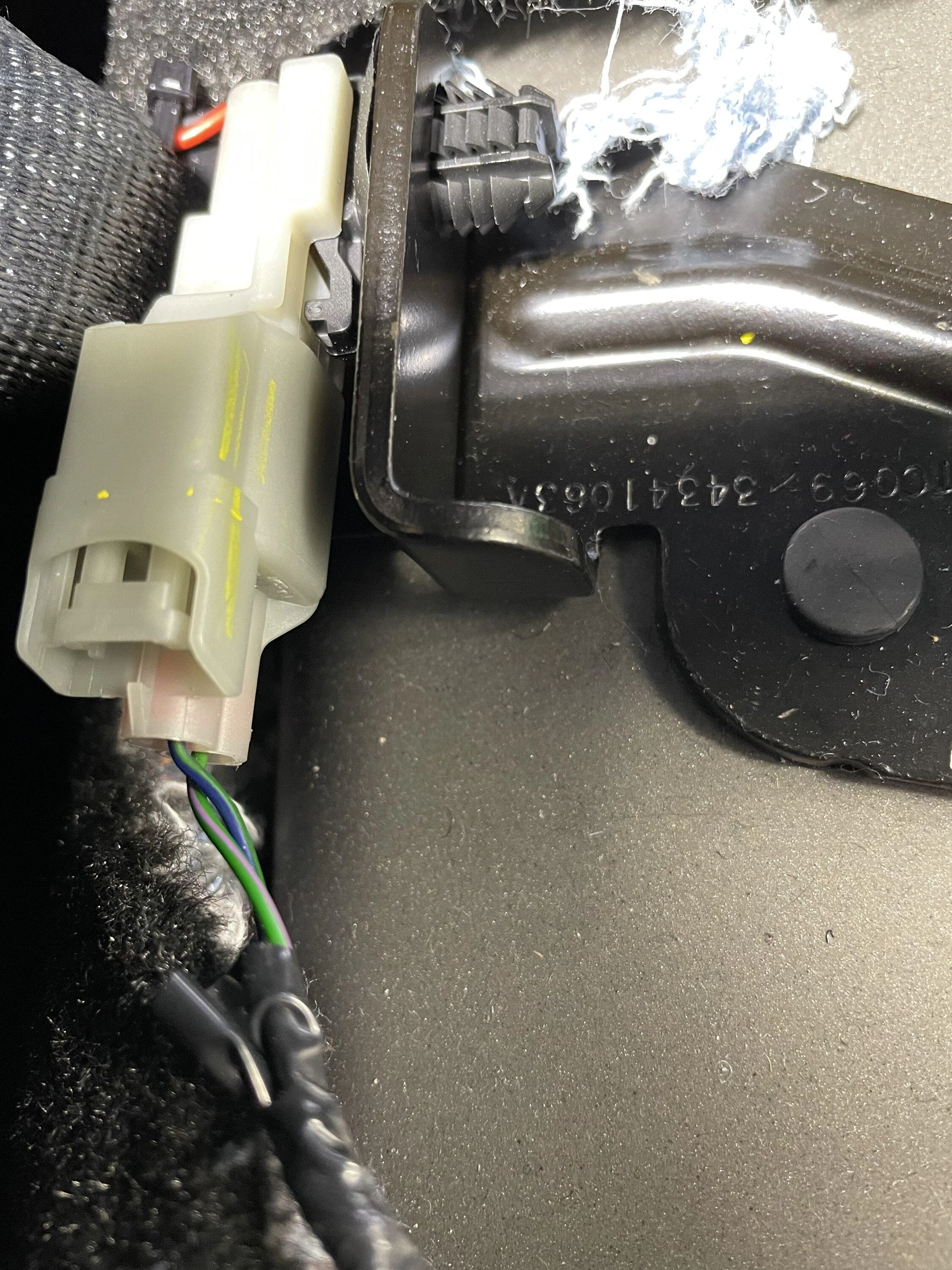

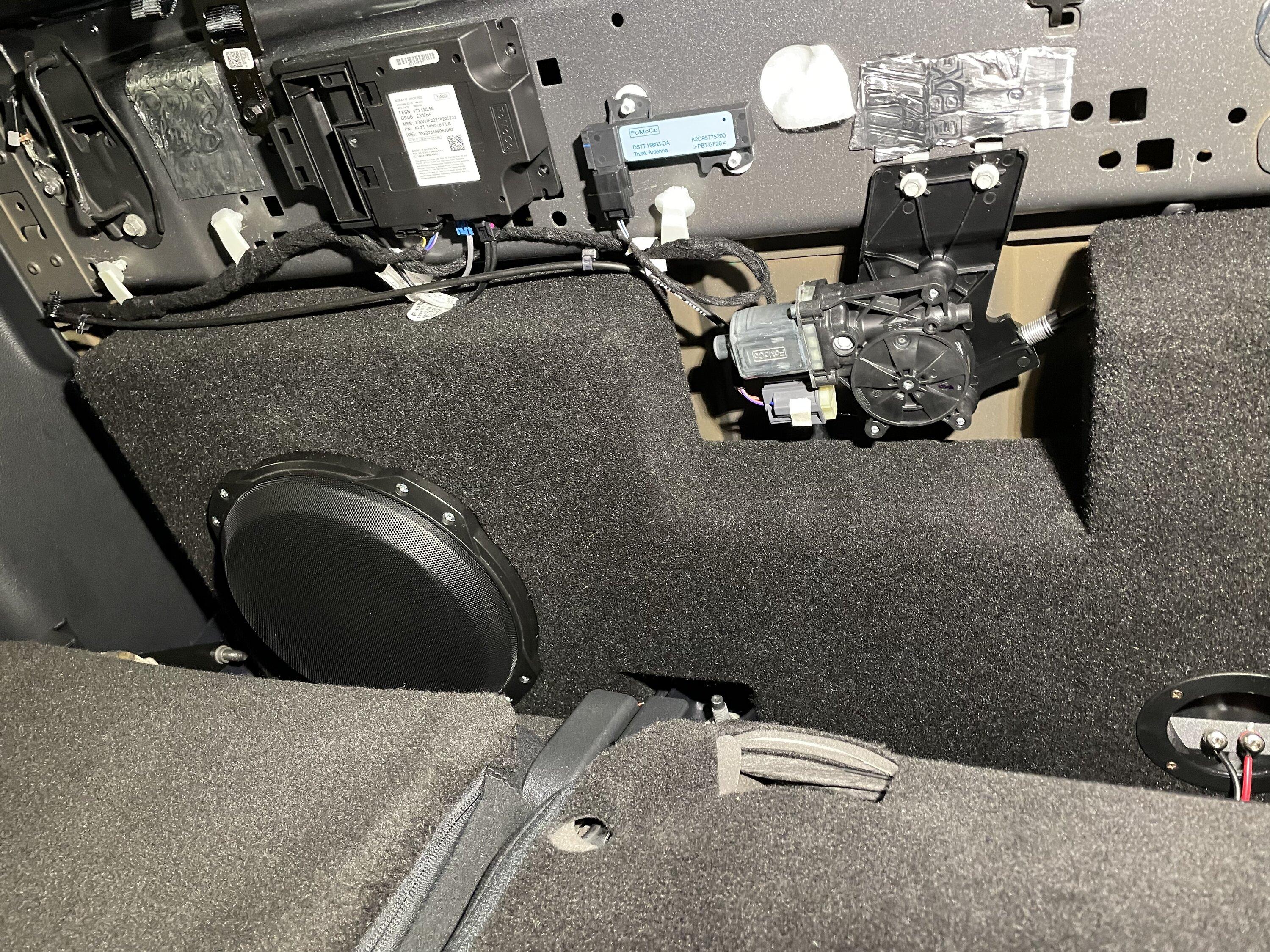

Anyone know where this plug goes? I originally thought the subwoofer had two connections, but it turns out this plug just goes back under the rear seat. I’m pretty sure it’s is a speaker lead, but doesn’t connect to the sub. Just the green connector does.

I followed it, and it goes into the drivers rear seat belt buckle. Must not be a speaker but a seat belt minder.

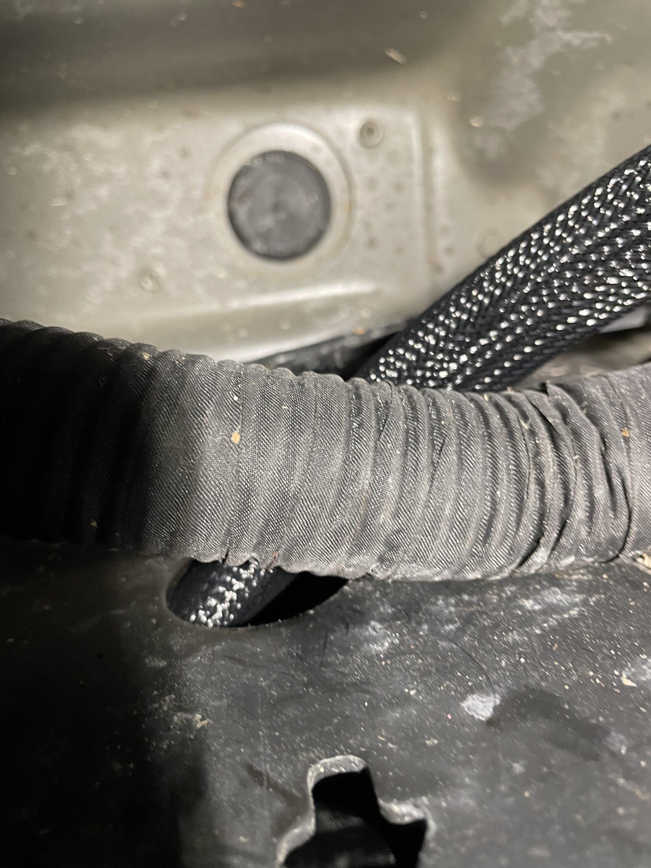

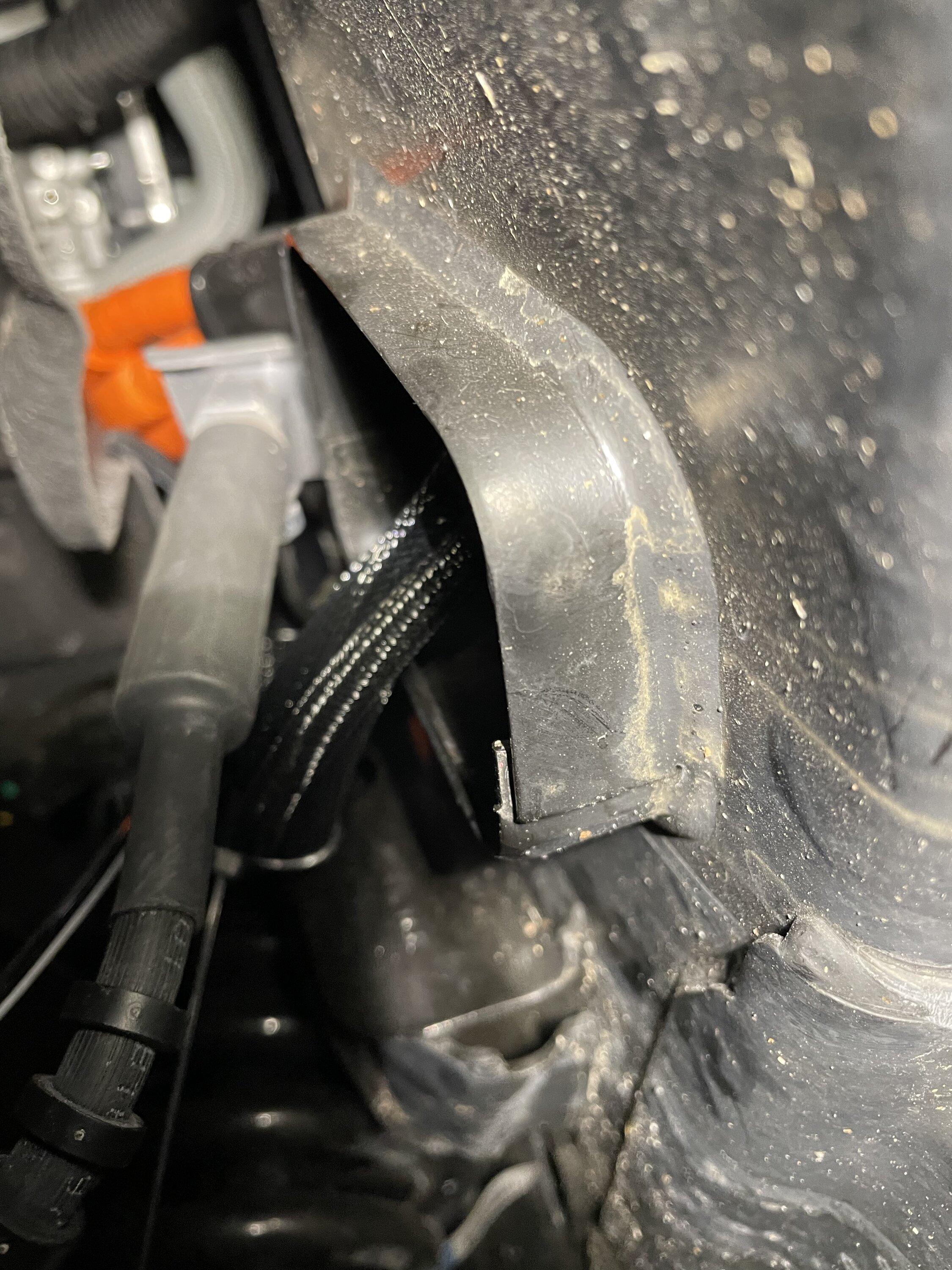

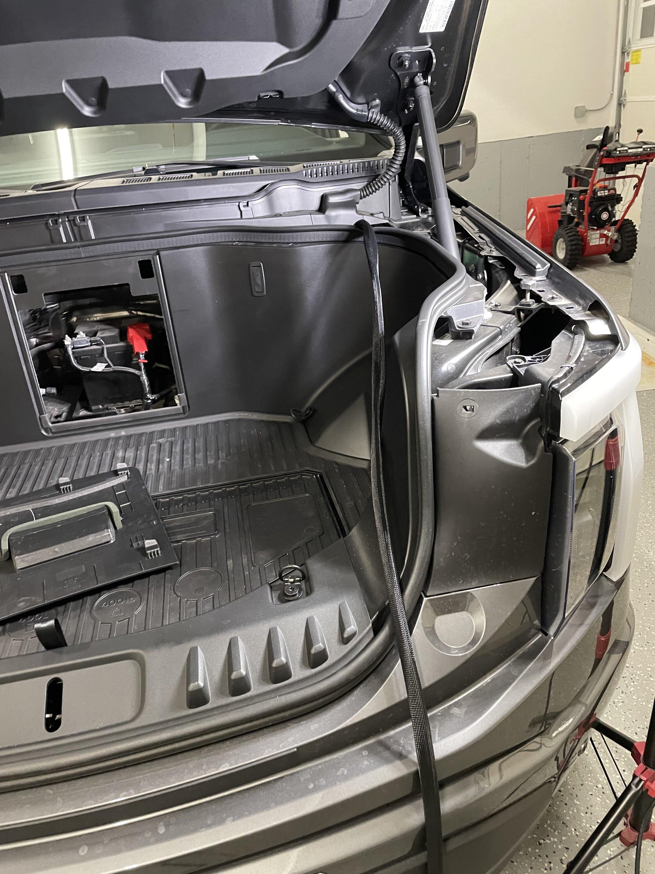

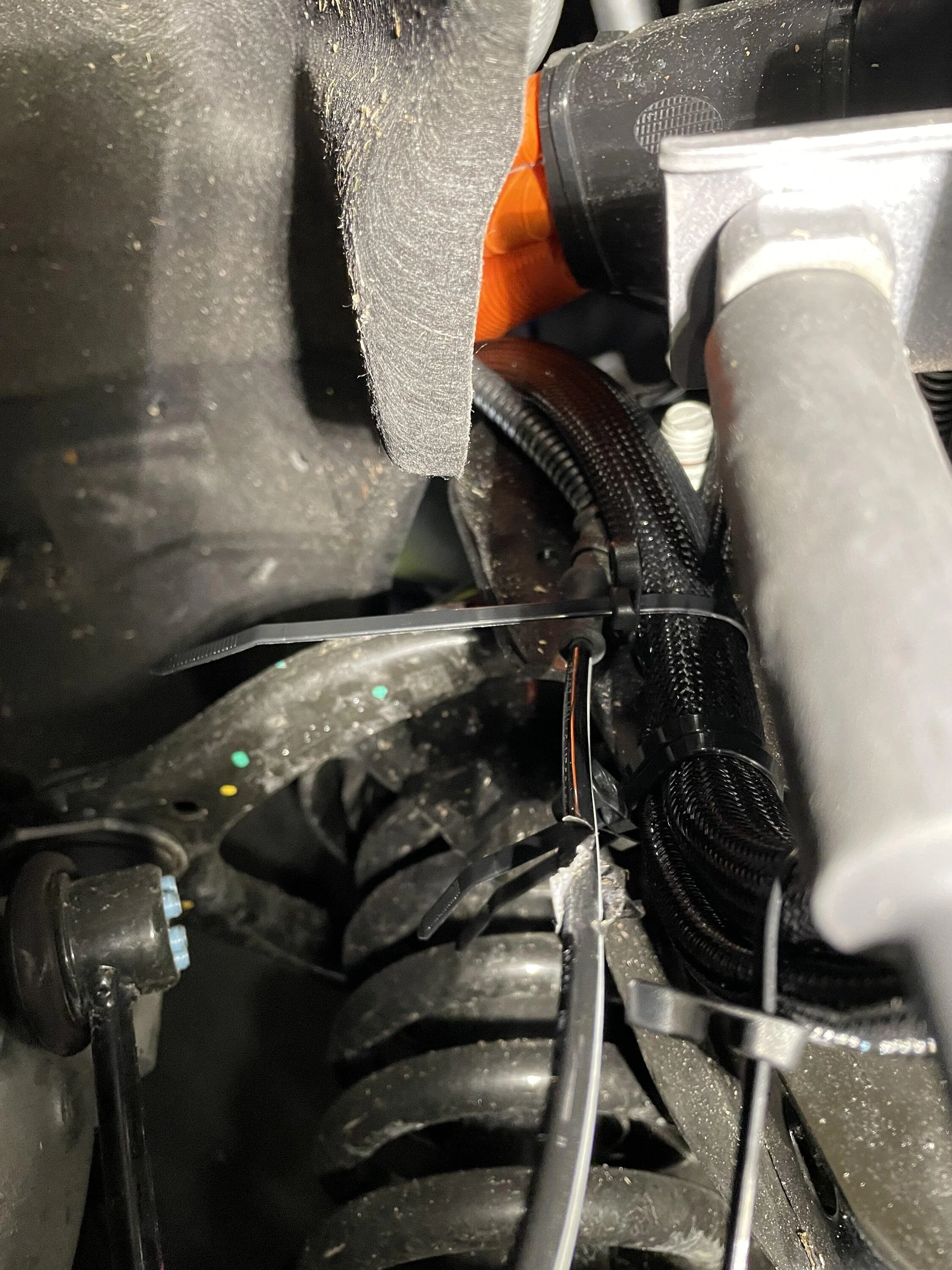

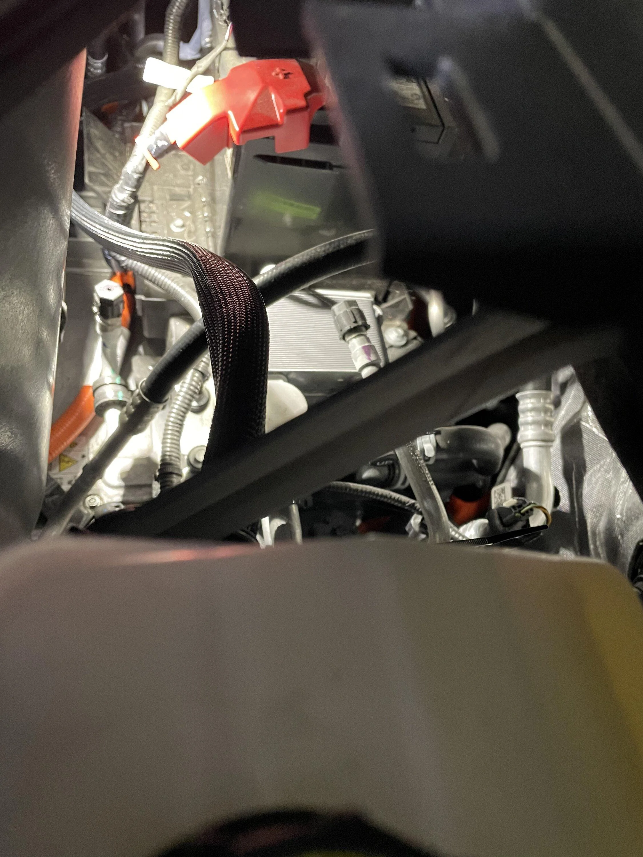

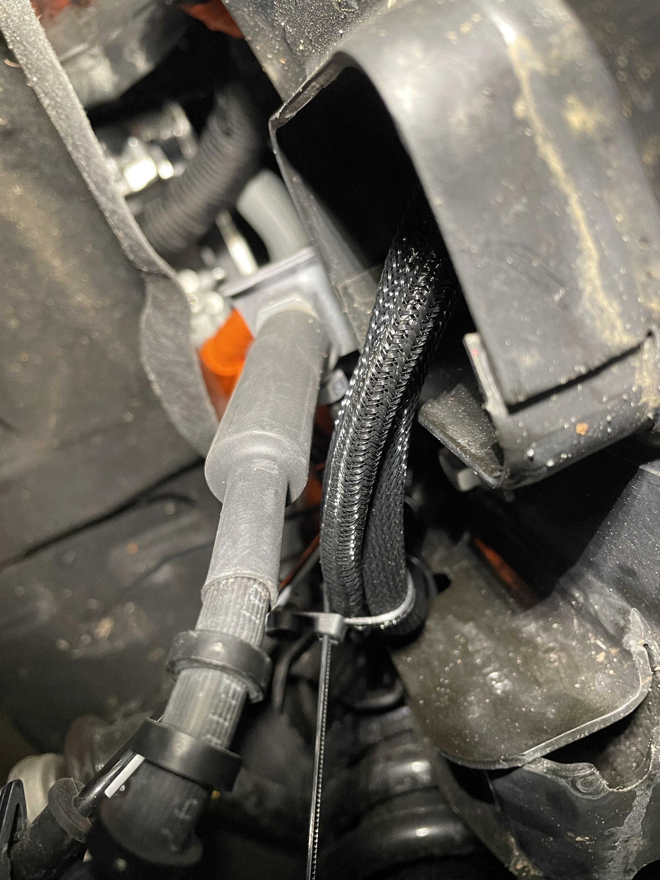

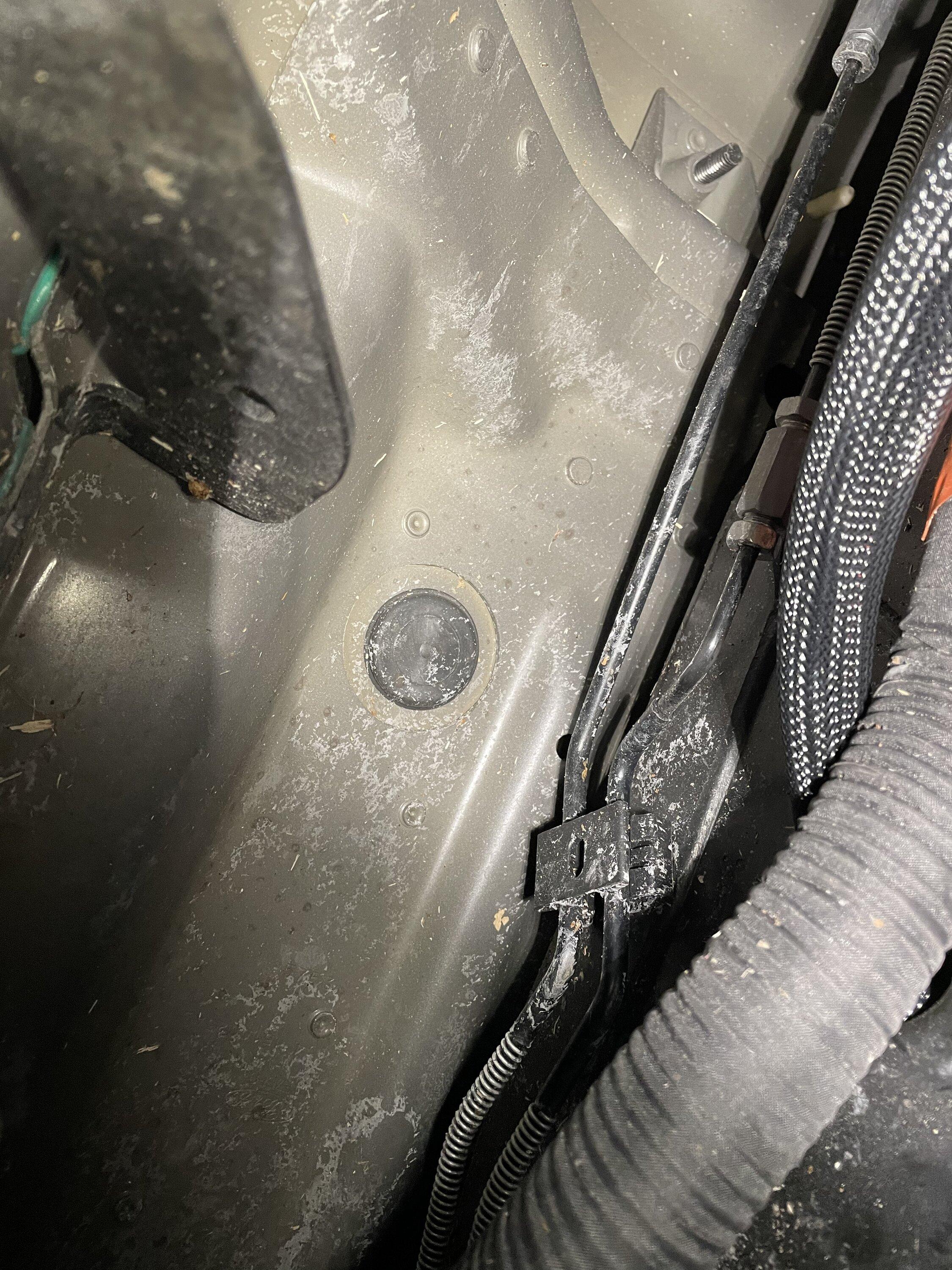

Ok here we go. Just started tonight running some 4ga. See some picks. Drivers side down into frame. Then pop out under drivers feet into the grommet.
stay in between brake Resivour and coolant resivour to avoid steering yoke.
I double techflexed the 2 runs .

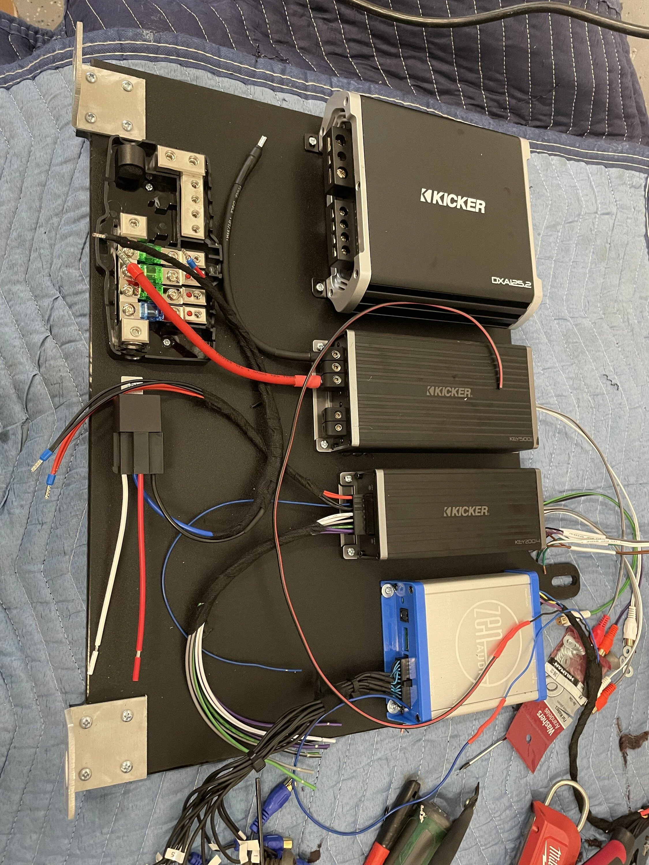

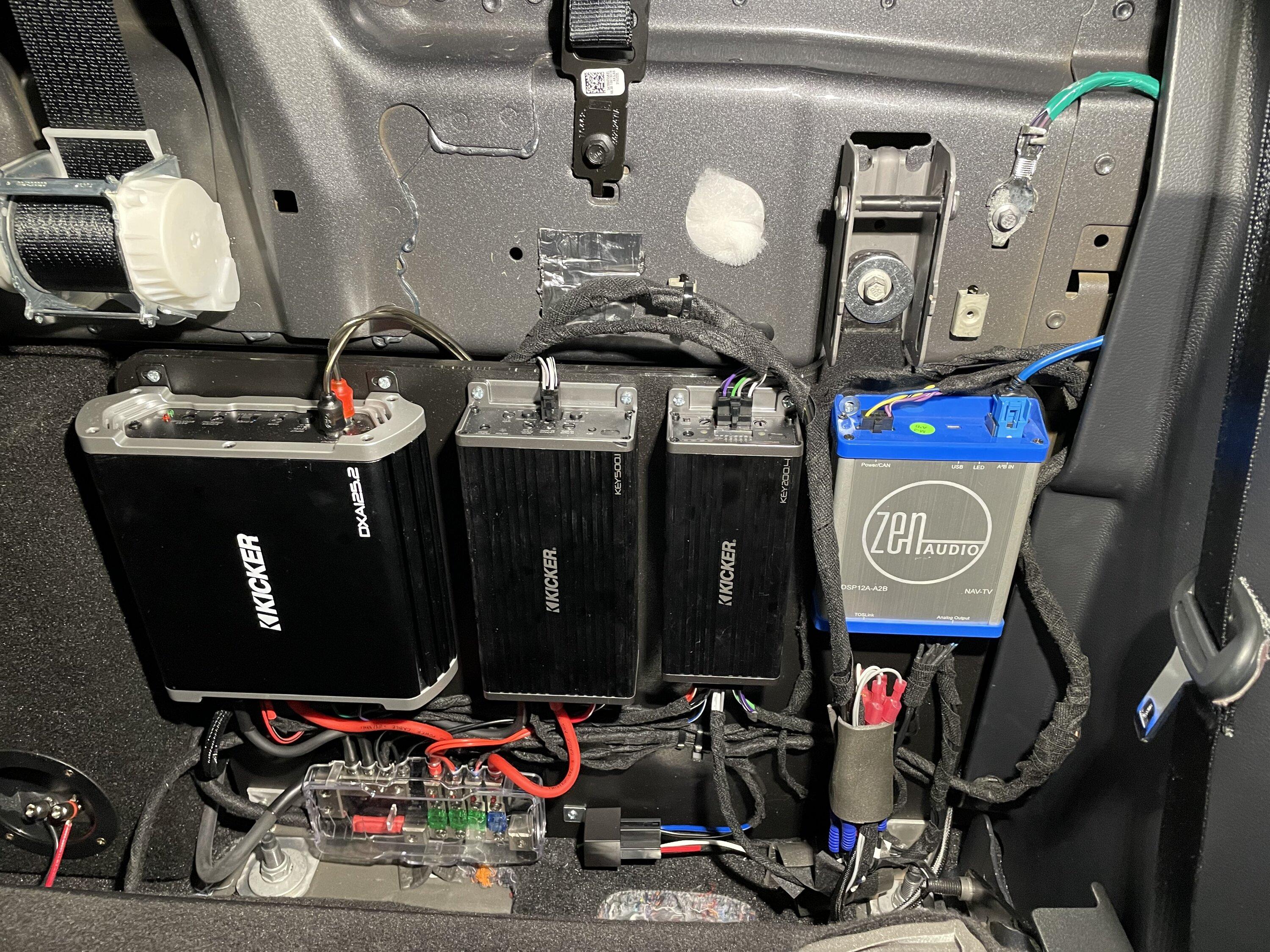

Ok finished this up this weekend. I’m pleased. Believe it or not, I wasn’t crazy about the kicker key time alignment. So I turned that off and put in the ford “surround” setting and that sounds best for my taste.
Also, don’t hate on the quick disconnects for the tweeters, sometimes you do what’s necessary to get the job done :)
