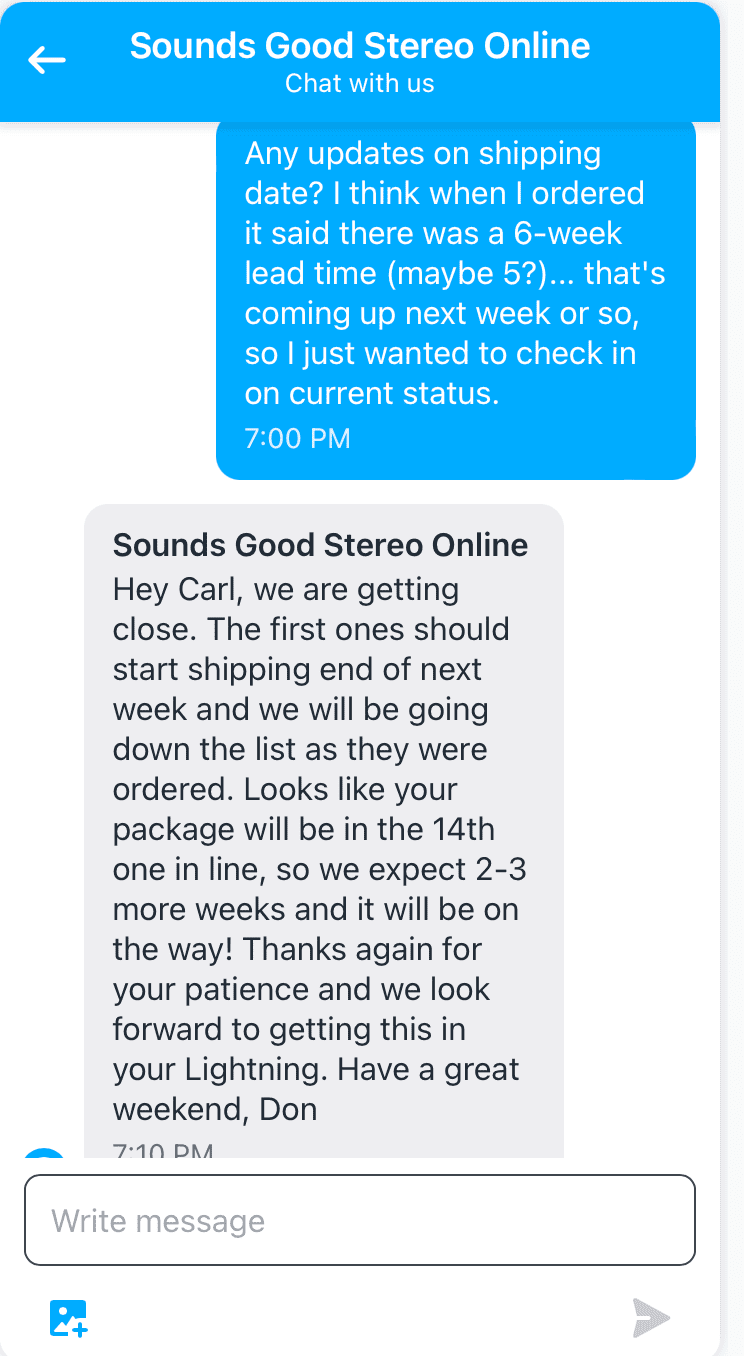

I checked in with SGS today:
Ford F-150 Lightning F150 Lightning Audio Builds (Anybody Done One?) Why Not? Screenshot 2022-12-29 at 7.18.08 PM
Sounds like it might be a while yet...

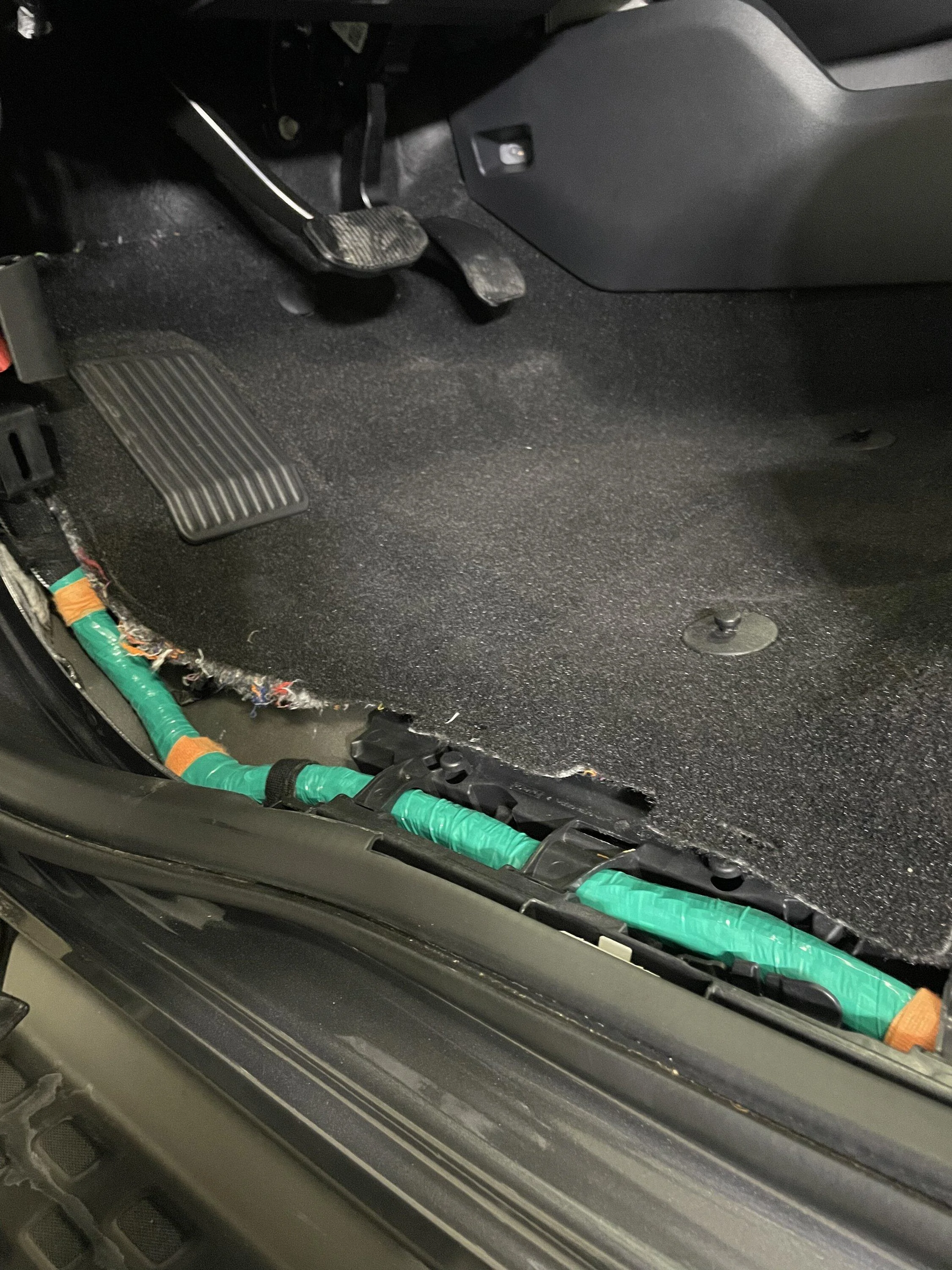

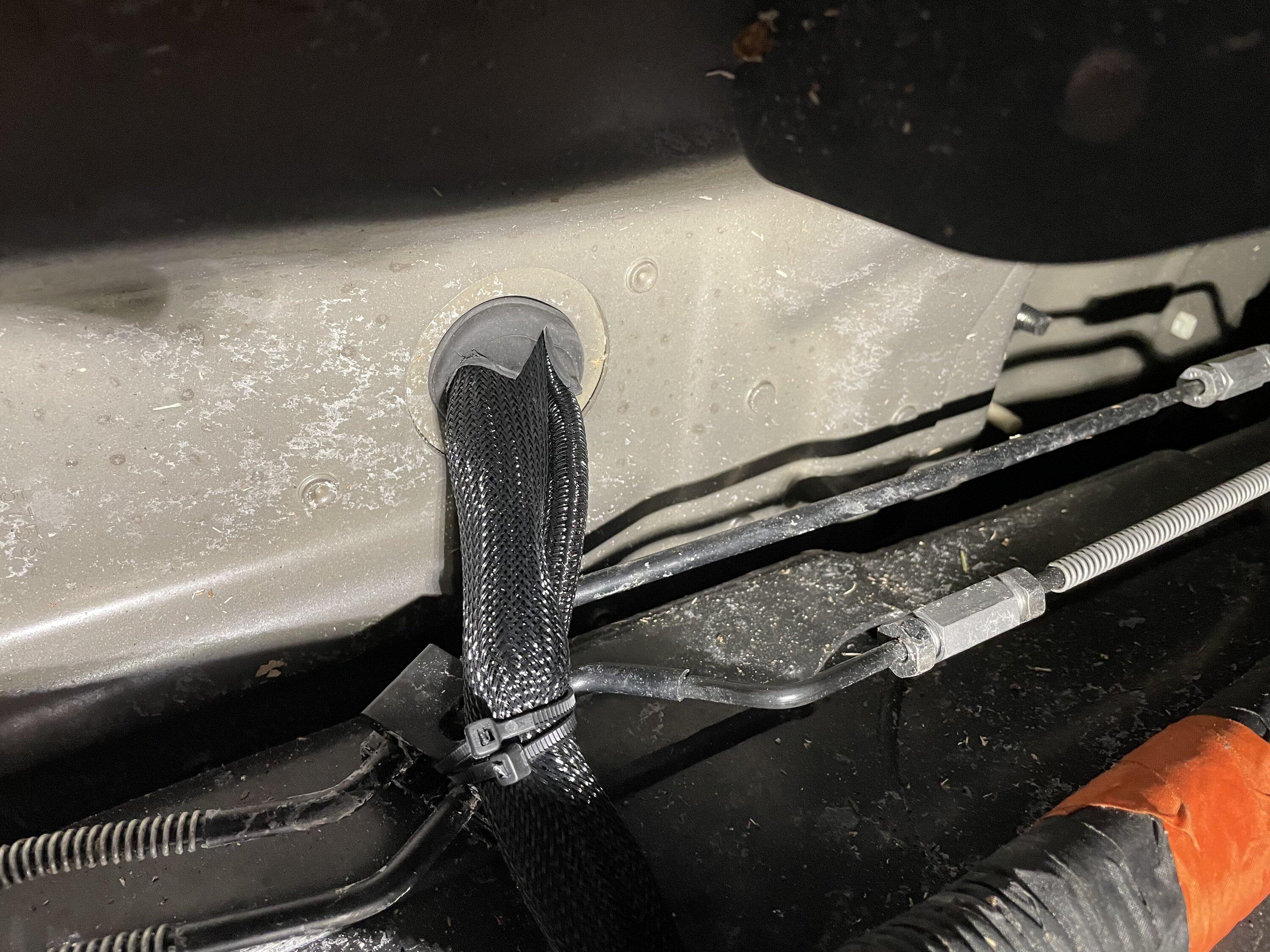

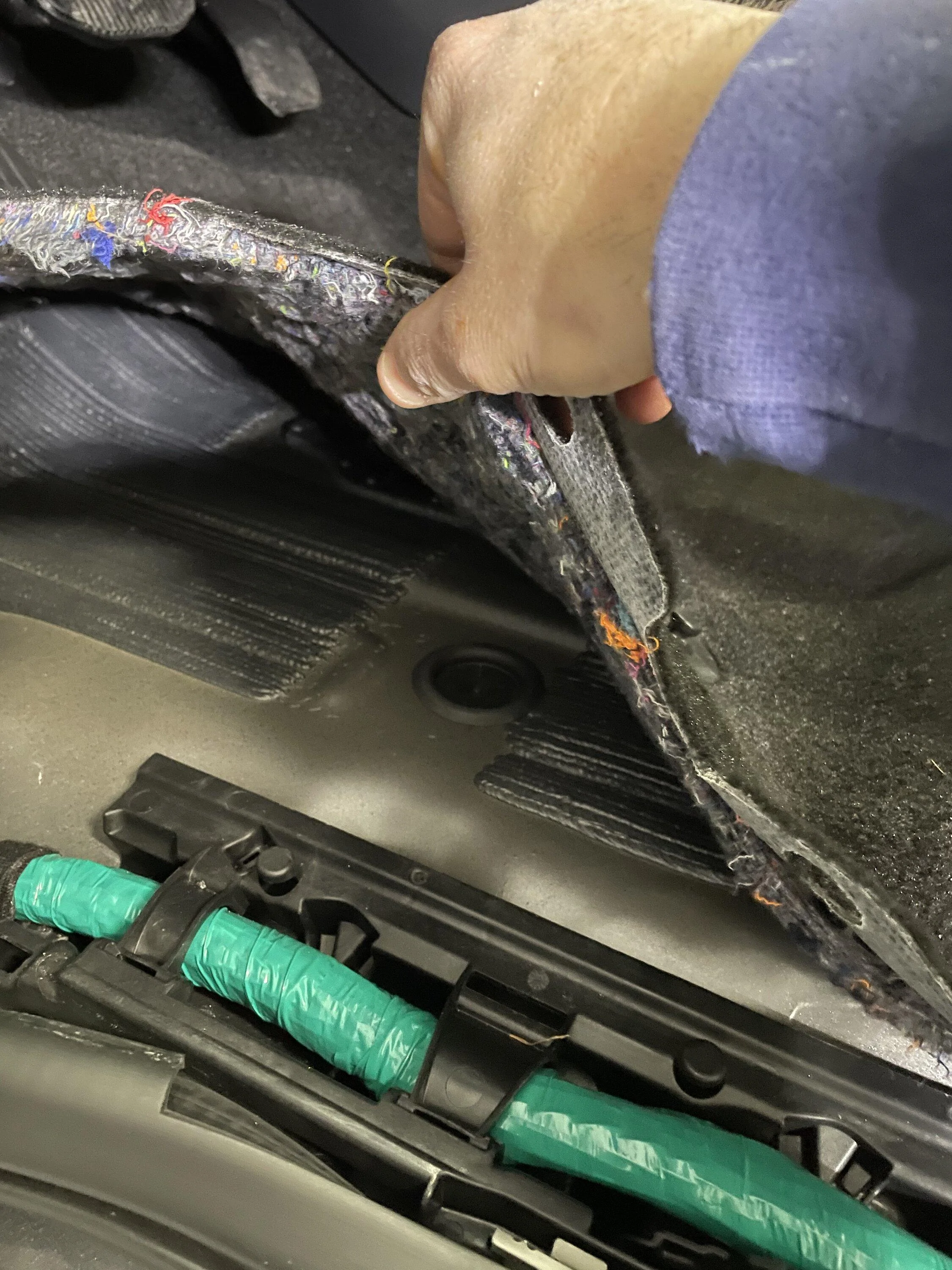

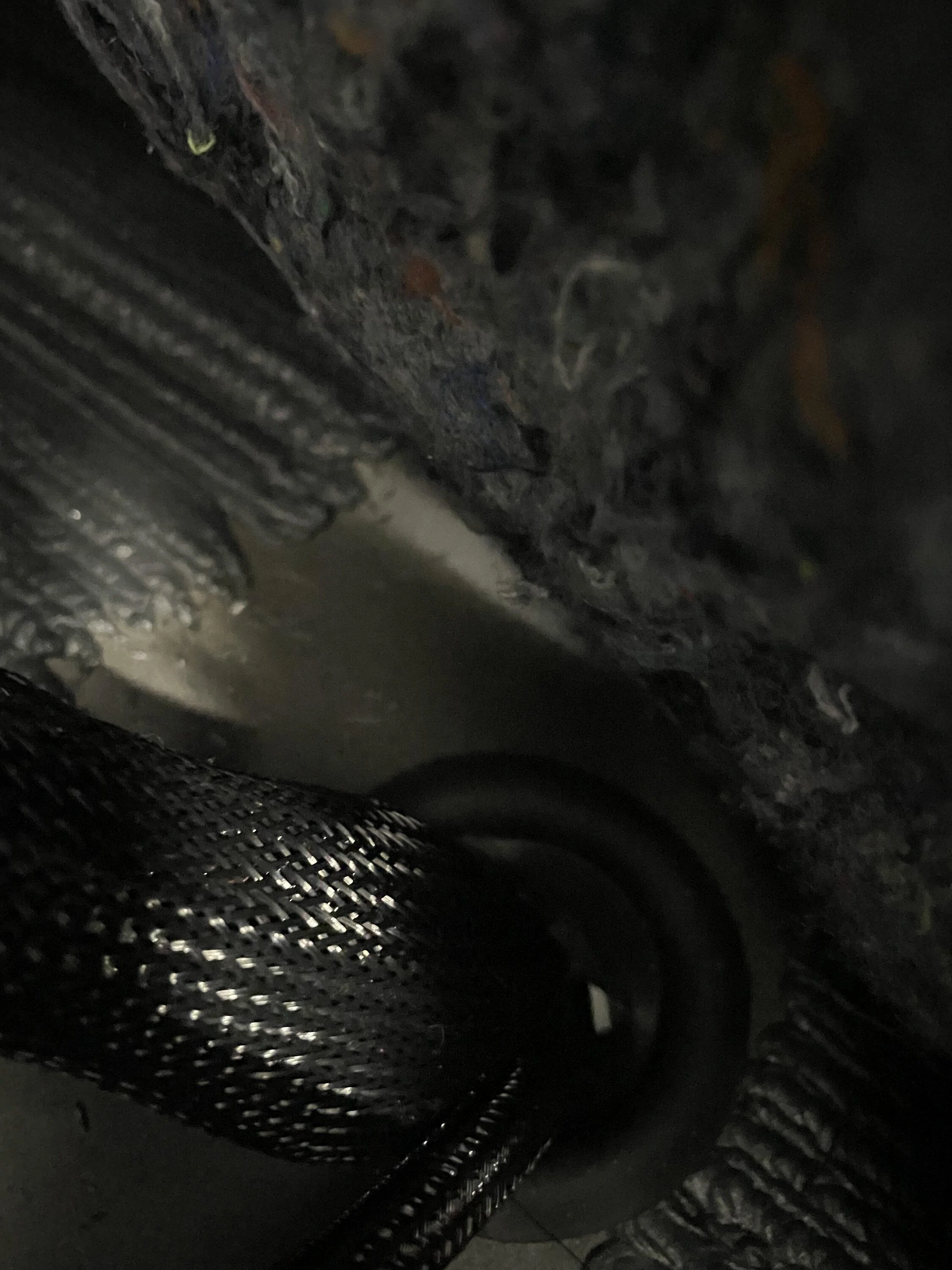

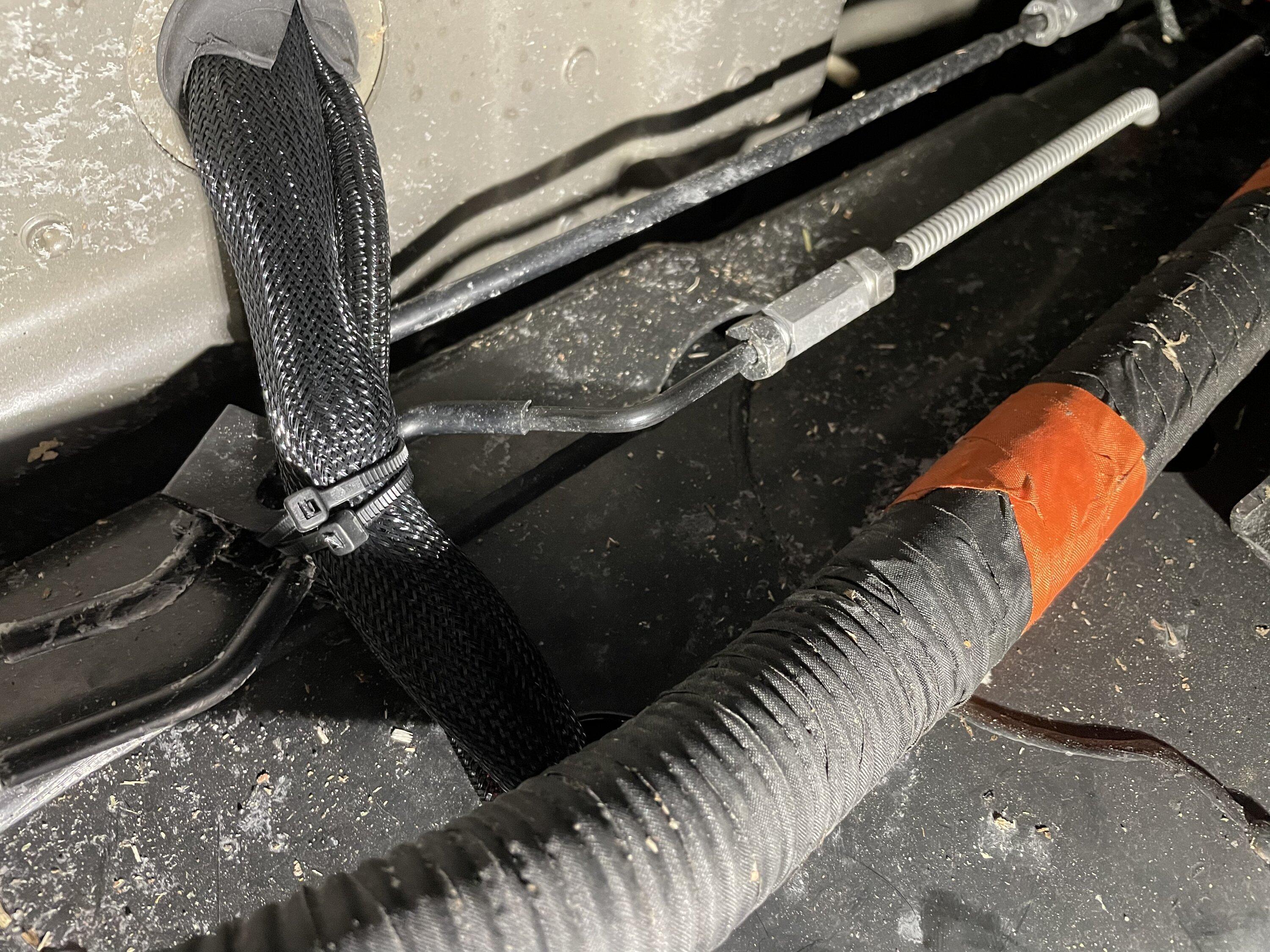

Ok here we go. Just started tonight running some 4ga. See some picks. Drivers side down into frame. Then pop out under drivers feet into the grommet.
stay in between brake Resivour and coolant resivour to avoid steering yoke.
I double techflexed the 2 runs .
Already a great idea - I've got to go back and document mine. I already was thinking about a reroute and I was curious how you had access in there, I didn't think to even take the cowling off on the drives side for easier routing in that area. I will likely work on mine a bit and add some documentation.
Thanks for sharing !

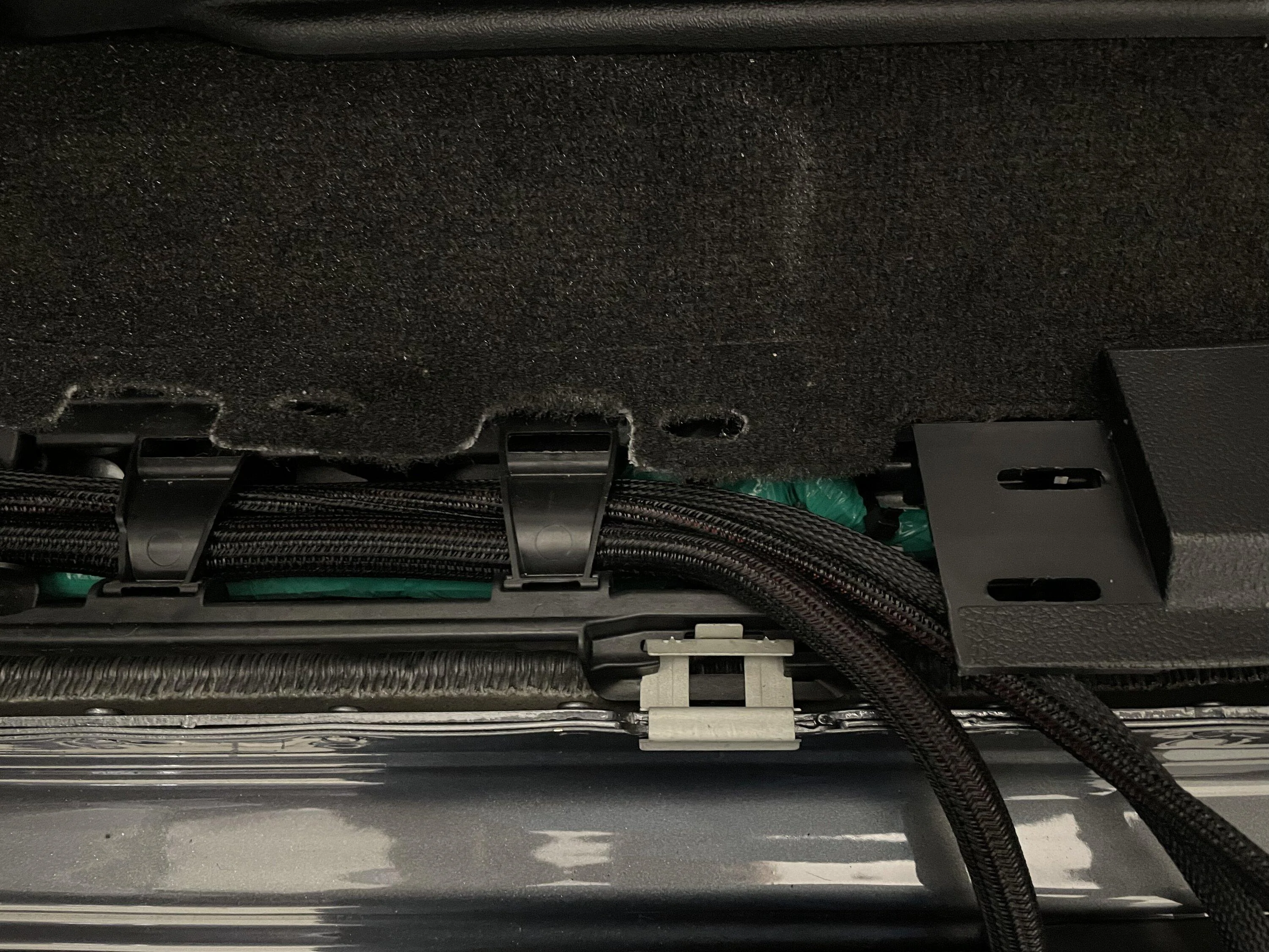

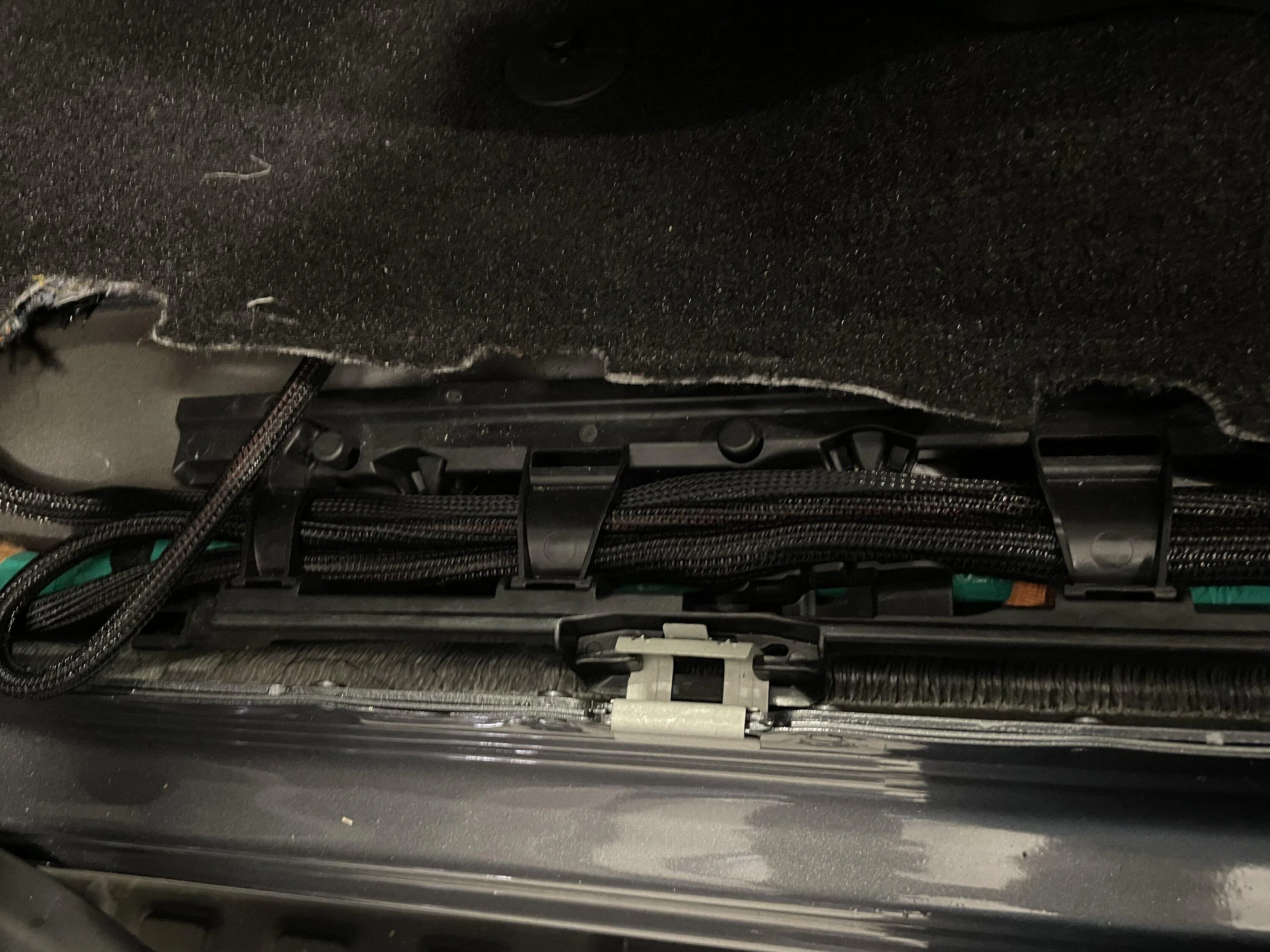

Here are some more pictures. Running 2 runs of 4 GA is really thick coming up under that carpet. I managed to get everything back but it is tight.
That other small cable is a 2 conductor 16 ga for the led emblem. Running that as a test, as the fuse box hook up messes with the radio reception.
