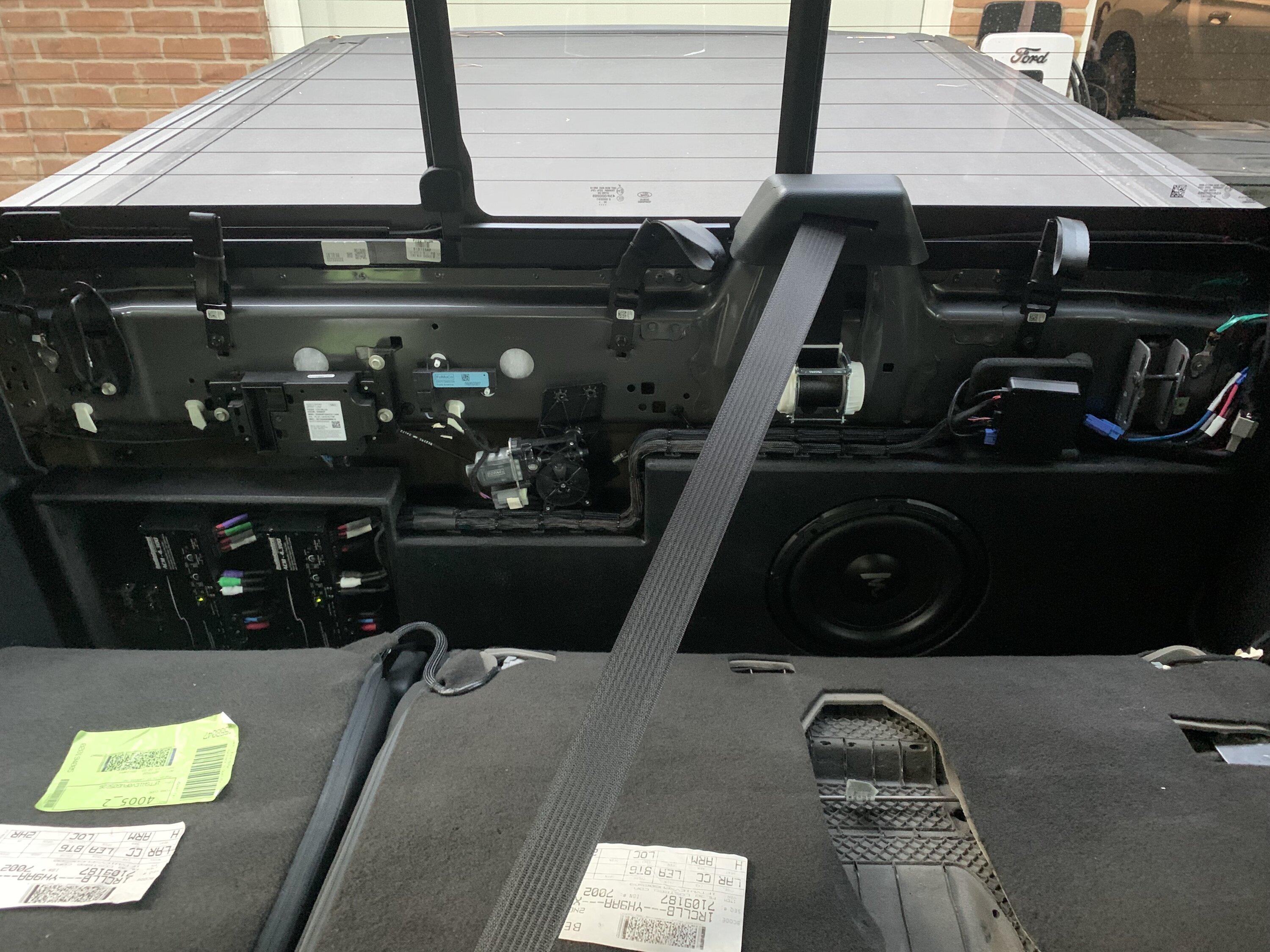

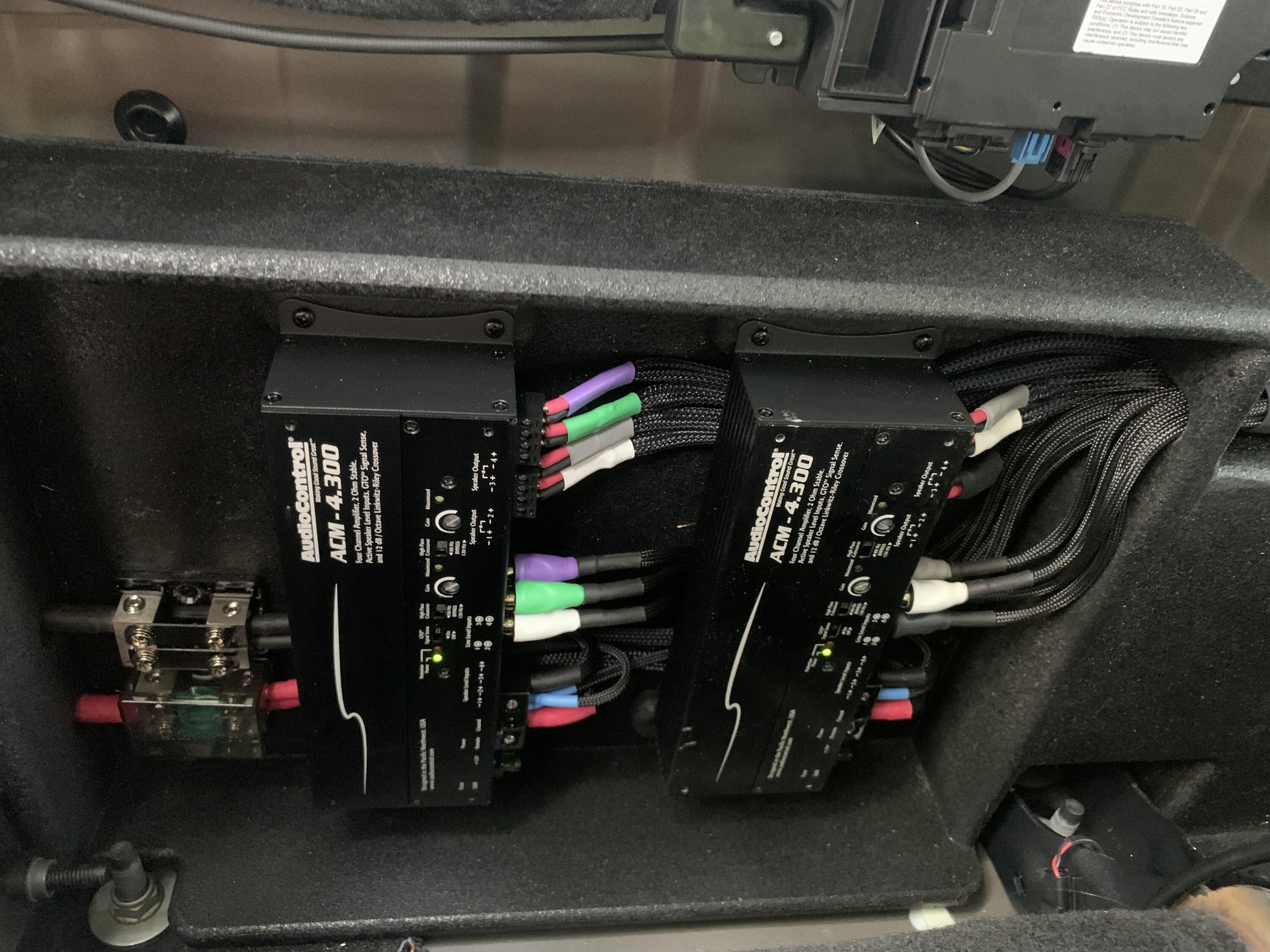

Finally got my setup installed. I went with the Metra Axxess AXDSPX A2B2 DSP, 2 AudioControl ACM 4.300 amps, Focal Slim Sub 10 Slim, focal 2 way active components up front and focal coaxial in the rear doors. The sub box and amp rack are a custom DIY from MDF and spray bed liner that fits behind the back seat, allowing full fold up and fold down. It’s all wired up with knukonceptz wire wrapped in tech flex and heat shrink from wirecare.
Ford F-150 Lightning F150 Lightning Audio Builds (Anybody Done One?) Why Not? 0E8189D1-EC32-4CAF-BA94-8AB8AA0953CB
Ford F-150 Lightning F150 Lightning Audio Builds (Anybody Done One?) Why Not? 801B0B99-9C80-4DEE-B73F-B87719A91DC9
Metra Axxess AXDSPX-A2B2: This unit is a solid DSP that quickly integrated with the truck. I was only able to set it up via android (iOS app does not work), but the android app is pretty self explanatory. It does have a few drawbacks relative to the the stock setup and appears to come up short relative to the NAV-TV Zen. It routes all of the chimes through the front, so you lose the directional notifications. It does not attenuate the base audio when presenting a chime/notificatio, so it is easy to miss them. It also seems to struggle to volume balance across sources (FM is way louder than XM). If I was doing it again, I would probably go with the NAV-TV unit. Having said that, the Metra team has been very supportive in a few exchanges while I have been getting it set up and I have sent them a list of suggestions to see if they can improve their software.
Focal Sub 10 Slim: Still breaking the sub in, so may be too early to issue a verdict here. I am not trying to rattle the neighborhood and it’s clear that this is not a sub that could. It does seem to be pretty responsive to the modest power I am pushing and it rounds out the lower end relative to the rest of the Focal speakers. It fits nicely in the shallow/small volume sealed box that I was able to fabricate behind the seat.
AudioControl ACM 4.300: These little guys are fantastic and sound like they probably put out well more power than they are labeled for. Nice amps in a compact package.

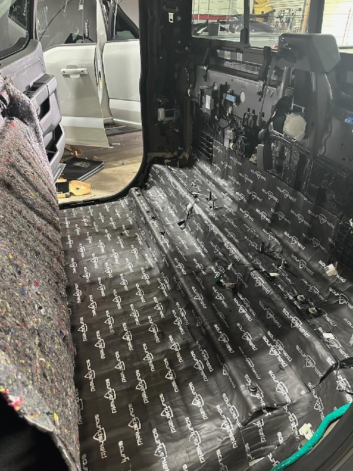

Here is my truck at the beginning of my audio overhaul. The floor and doors will be dampened. I think the roof will be dampened as well. I will check with them tomorrow to make sure.

Drove a few hundred miles today with the audio at a decent clip. Dampening like that definitely isn't out of line with some vibrations I was noticing. Looks good.
