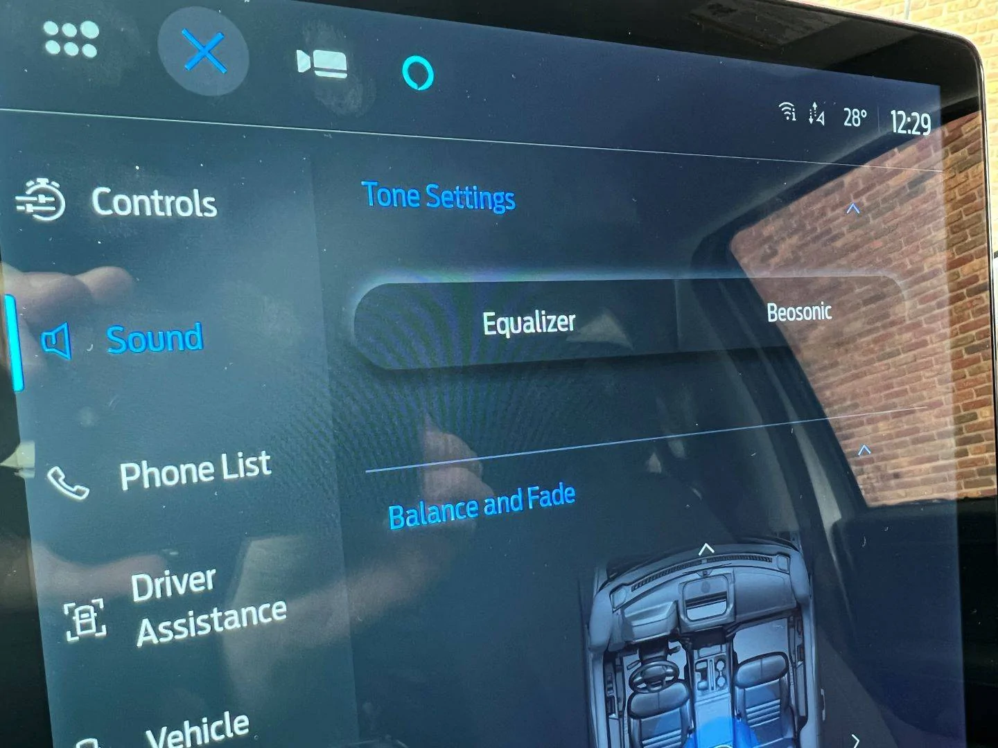

Here's a screenshot of the menu that I am seeing with the below settings:
APIM 7D0-01-01 xxx9 xxxx xx--
DSP 783-01-01 xx1x xx--
Tapping either of them does nothing at all. No beeps or button interactions.
Any thoughts?

What does FORScan show as the part/strategy/configuration numbers for your DSP (see post 47)? You can use FORScan Windows or the free FORScan viewer app on your phone to see these numbers.
DSP - (Audio) Digital Signal Processing Module
Part number: ML3T-18B849-BK
Calibration level: ML3T-18B849-BK
Strategy : ML3T-14C589-BK
I have no idea what this means.

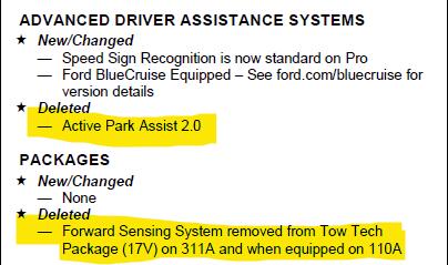

Unfortunately, Active Park Assist was removed entirely in 2024 for all trims.

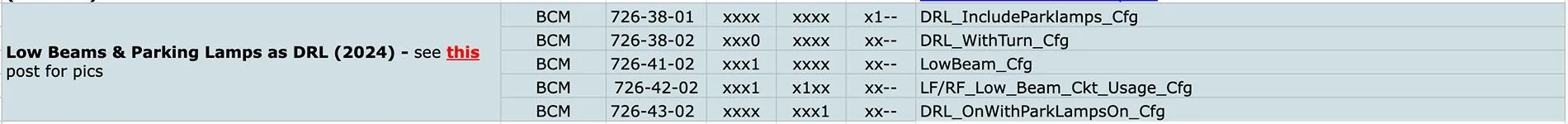

Does anyone know if this is applicable to Lightnings?
Ford F-150 Lightning F150 Lightning FORScan thread - Version 2 Screenshot 2025-01-13 at 8.00.39 PM
Looking to have the DRLs be amber all the time.
