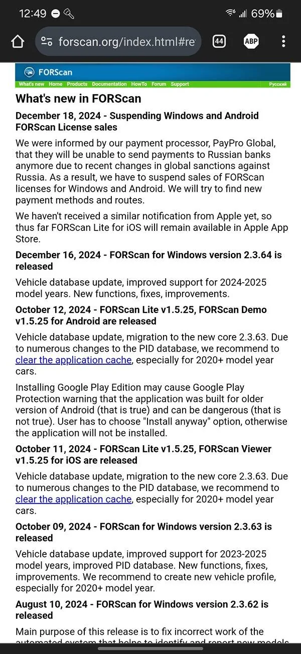

Looks like they're going to quit selling licenses in the US (at least temporarily anyways). Wonder if they're still going to do the two month trial
Maybe Ford should hire them and move them to the US?
I just downloaded and installed the free 2 month trial.

Anyone with a solution for purchasing an extended Forscan license in the US since December 18th? Any resellers that can sell this?
