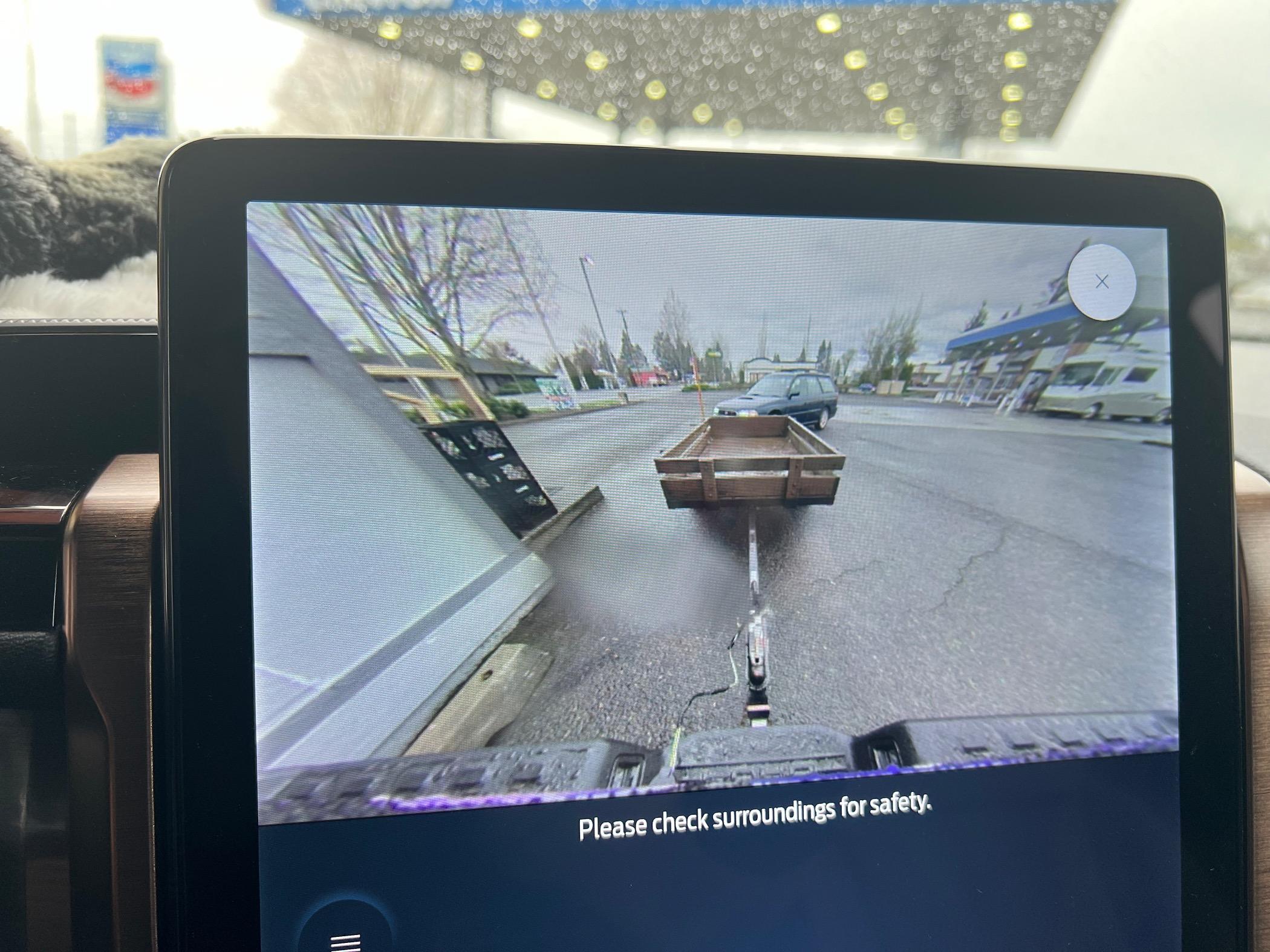

Add me to the list of folks loving the tow camera tweaks.
It’s super useful to see down the side when making a turn with the indicator on, and when driving with the trailer, we’ve erased that “full view not available” warning too.
Why on earth isn’t the signal camera a standard feature?!

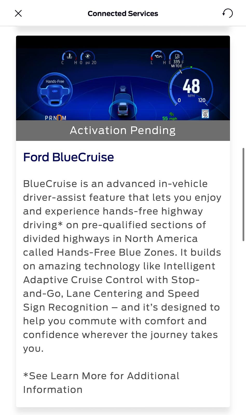

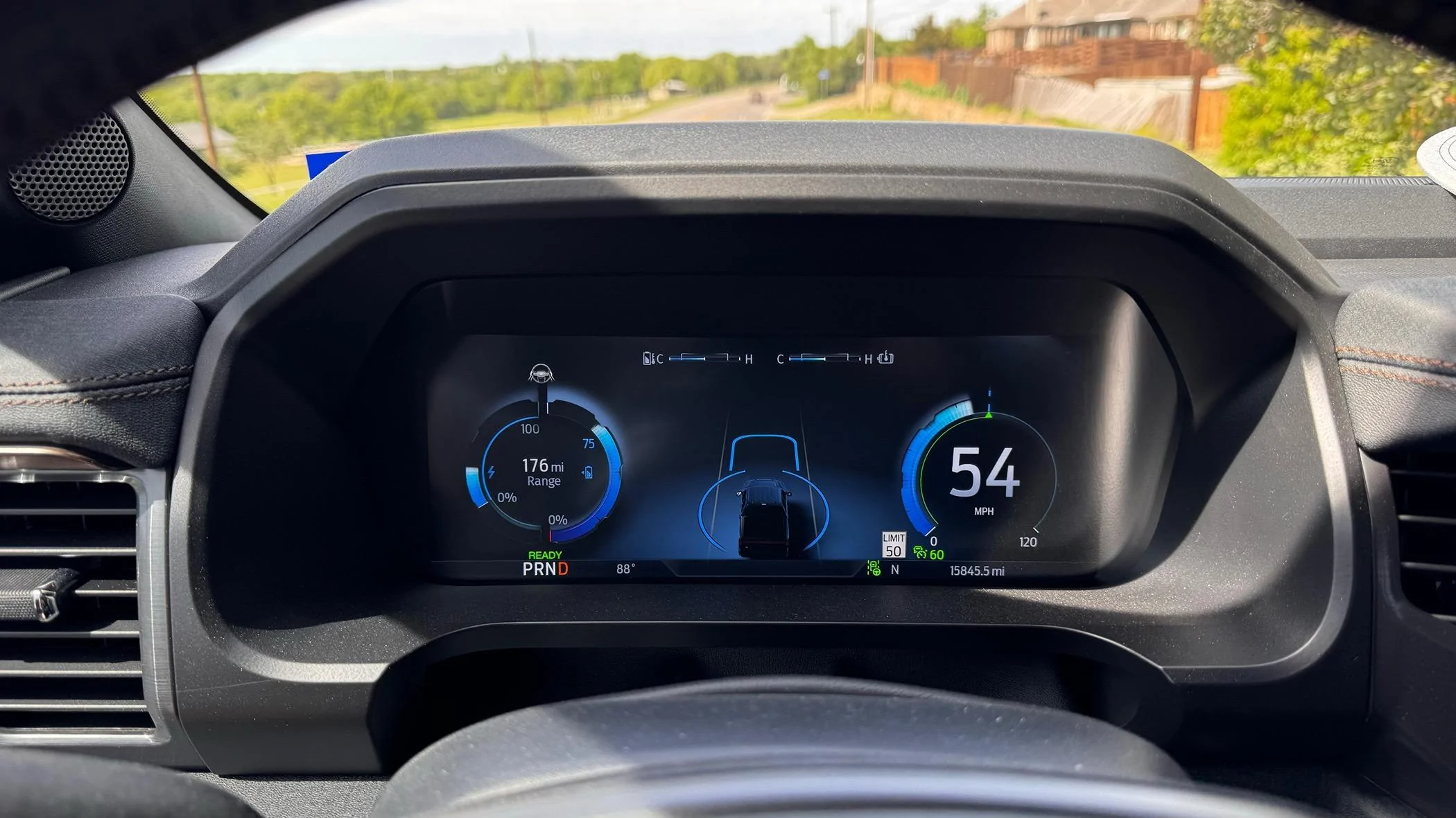

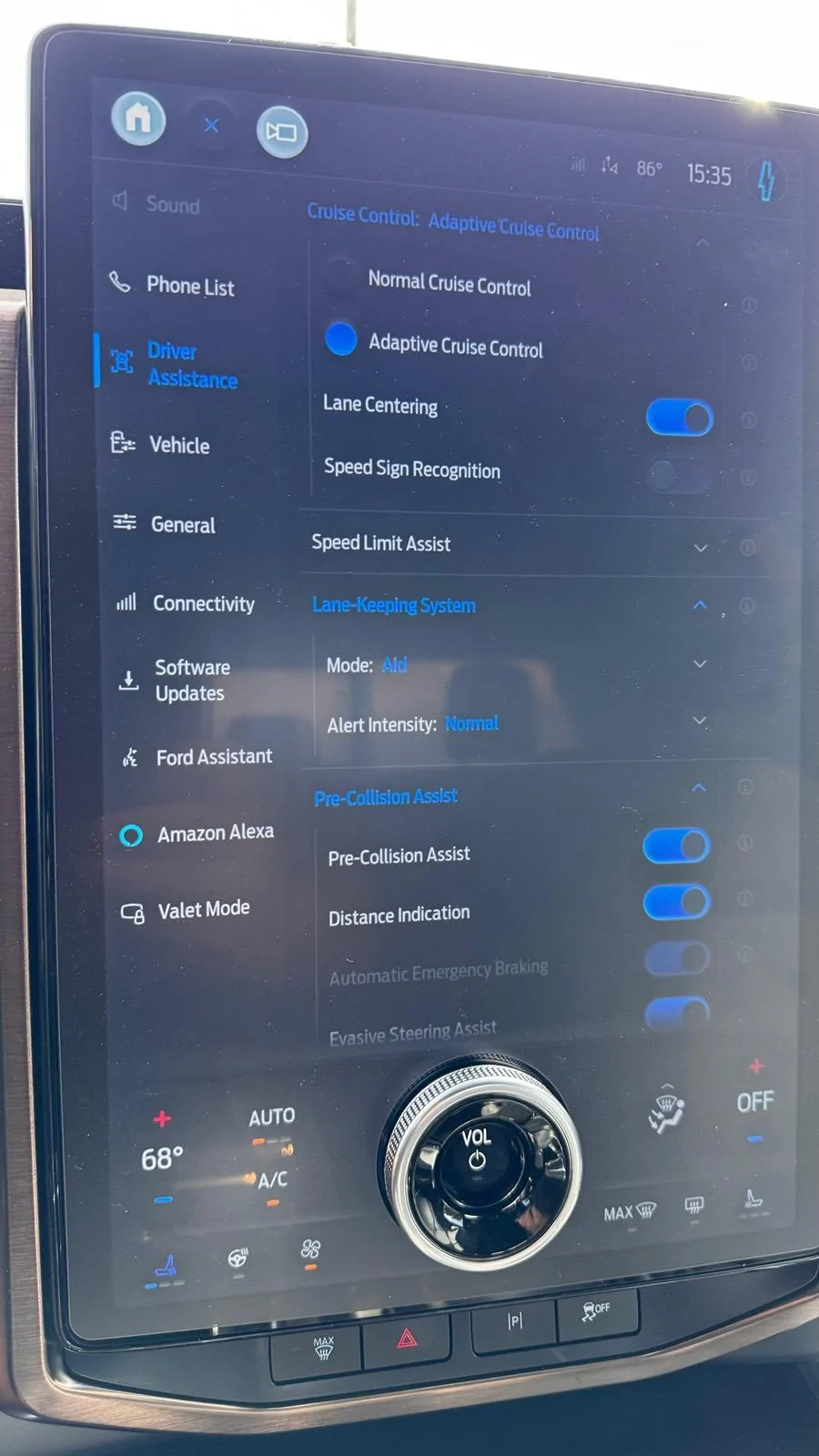

I made the change to my IPMA 706-01-01 to enable traffic jam assist and disable highway assist. I decided I didn’t want to disable Blue Cruise so I tried to enable it again and disabled traffic jam assist. However I don’t get the option in the Adaptive Cruise Menu for Lane Centering Hands Free.
Is there anything I can post here to help troubleshoot?
The Bluecruise steering wheel symbol is showing in my IPC though???

Disregard, seems it’s not my IPMA configuration but rather it’s pending activation in FordPass connected services. Any idea why? Is my truck just waiting for approval from Ford?
Are your other connected features working correctly? Nav, Fordpass?
Hello, yes other connected services are working. FordPass says BlueCruise is still pending activation.
I think I’ve somehow misconfigured something via ForScan for my truck. Does anyone have a list of relevant modules and settings to completely configure the truck for BlueCruise?
Like I said, the only thing I’ve changed recently was I tried out Traffic Jam Assist instead of Highway Assist. Then reverted back to the old settings for 706-01-01…..
I would need the VIN to help.
