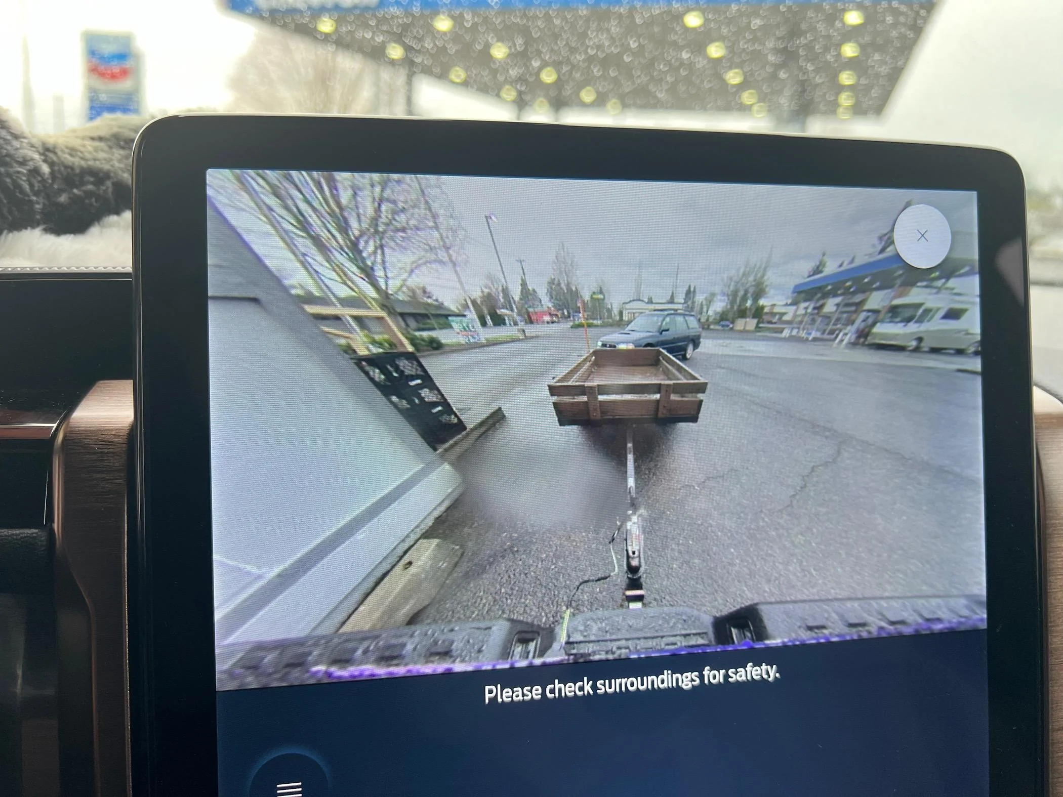

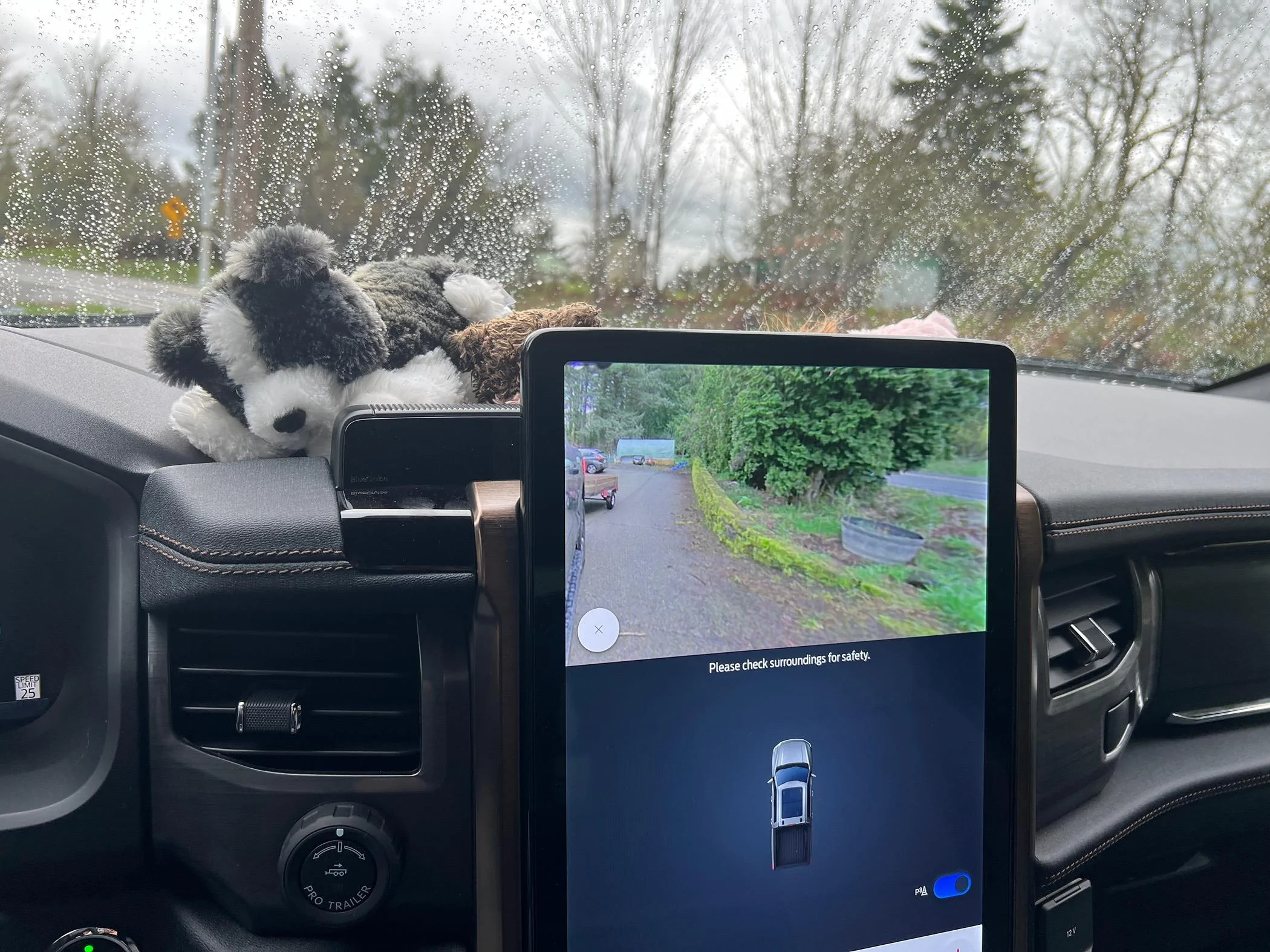

Aminorjourney
Nikki
Jun 6, 2022
326
703
Internet
www.transportevolved.com
2023 F150 Lightning Lariat, 2017 Chevrolet Bolt EV, 2006 Vectrix VX-1
Add me to the list of folks loving the tow camera tweaks.
It’s super useful to see down the side when making a turn with the indicator on, and when driving with the trailer, we’ve erased that “full view not available” warning too.
Why on earth isn’t the signal camera a standard feature?!
