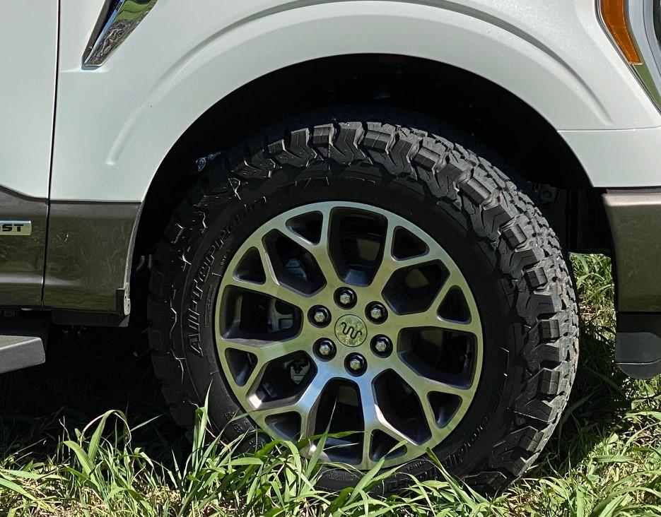

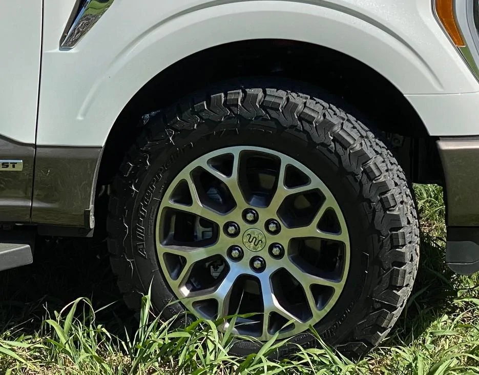

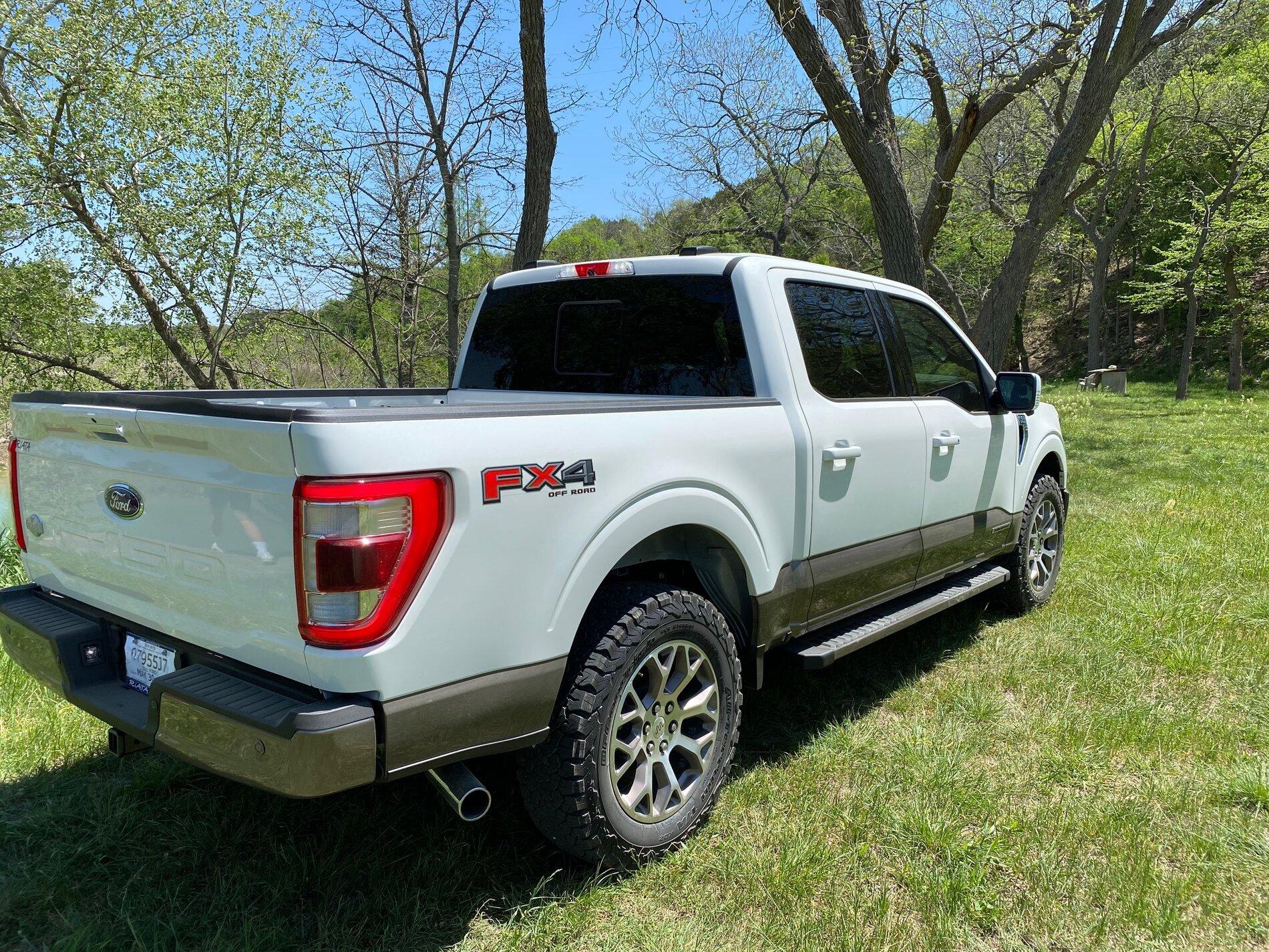

This thread was invaluable to me on confidently moving up to 275/65r20 KO2s on factory KR 20s so I thought I would share pics of Trigger with her new shoes. PB with FX4 definitely plays into the rake or lack thereof - no level (yet) but also no weight in back (bedliner, mat, tonneau) either. No rub, no issues with lane keeping, headlights or other driving aids. All in all - very happy!
Looks great! I was going to go with the 285/65s in the same tire. Do you have much clearance at full lock?
I'm also curious what your MPG and highway noise differences are compared to stock.

@Trigger_the_2021F150_KR -
Thanks for sharing these pics! I definitely like the look of these 285/65 R20 KO2's and am happy to hear there's no rubbing - even before the Levelling. I'd love to hear your assessment of road noise from them, as I have heard conflicting opinions. (I already plan to get this exact size KO2's too!).
Also, if you'd driven on them, I'd be interested in your opinion of how these tires compared to the stock 275/60 R20 (Hankook? Spider?) tires. Mostly curious about road noise but any other observations would be greatly appreciated!
As an aside, I really like those KR Wheels. They are far better than those I (only vaguely) recall on the Platinum I'd ordered oh so many months ago ...
For Madman and GolfR - too early to tell about gas mileage as my driving is still way more aggressive than usual given 435 hp + Hybrid = late onset adolescence.
Remember, mine are 275/65r20, replacing stock Pirelli Scorpions that were 275/60r20 - increases diameter 1.1 inches per TireRack.
Road noise is negligible over the 200 miles I put on the non-E load rated Pirelli Scorpions the KO2's replaced. The ride is slightly rougher due to the E load rating and 10 plys, as is to be expected. Discount Tire aired them 35 psi, per door jam sticker but there is another thread on here (and many others elsewhere) debating where one should air E load rated tires as opposed to what the sticker says (many insisting that 45-55 psi is needed when the max psi is 80). On my 2007 F150 FX4, I put over 50k on the same exact tire at 35 psi without a problem. Trigger rides MUCH BETTER than the 2007, FWIW.
Thank you for the response, Trigger Dad. ;)
Very helpful. I don't expect to tow much so will take your advice and go with 35 psi.
(I will still covet your KR wheels over my Platinum wheels, though.)
