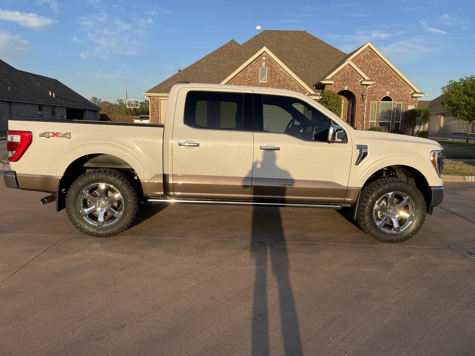

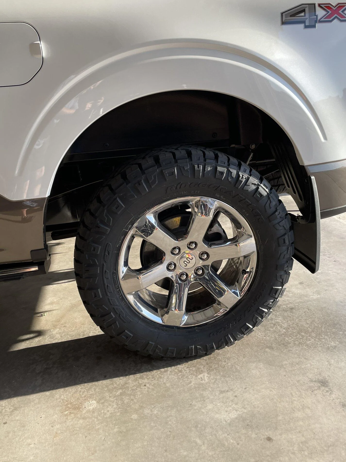

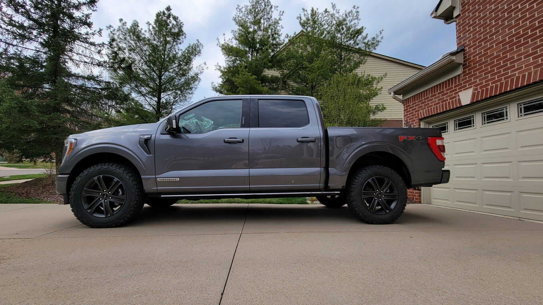

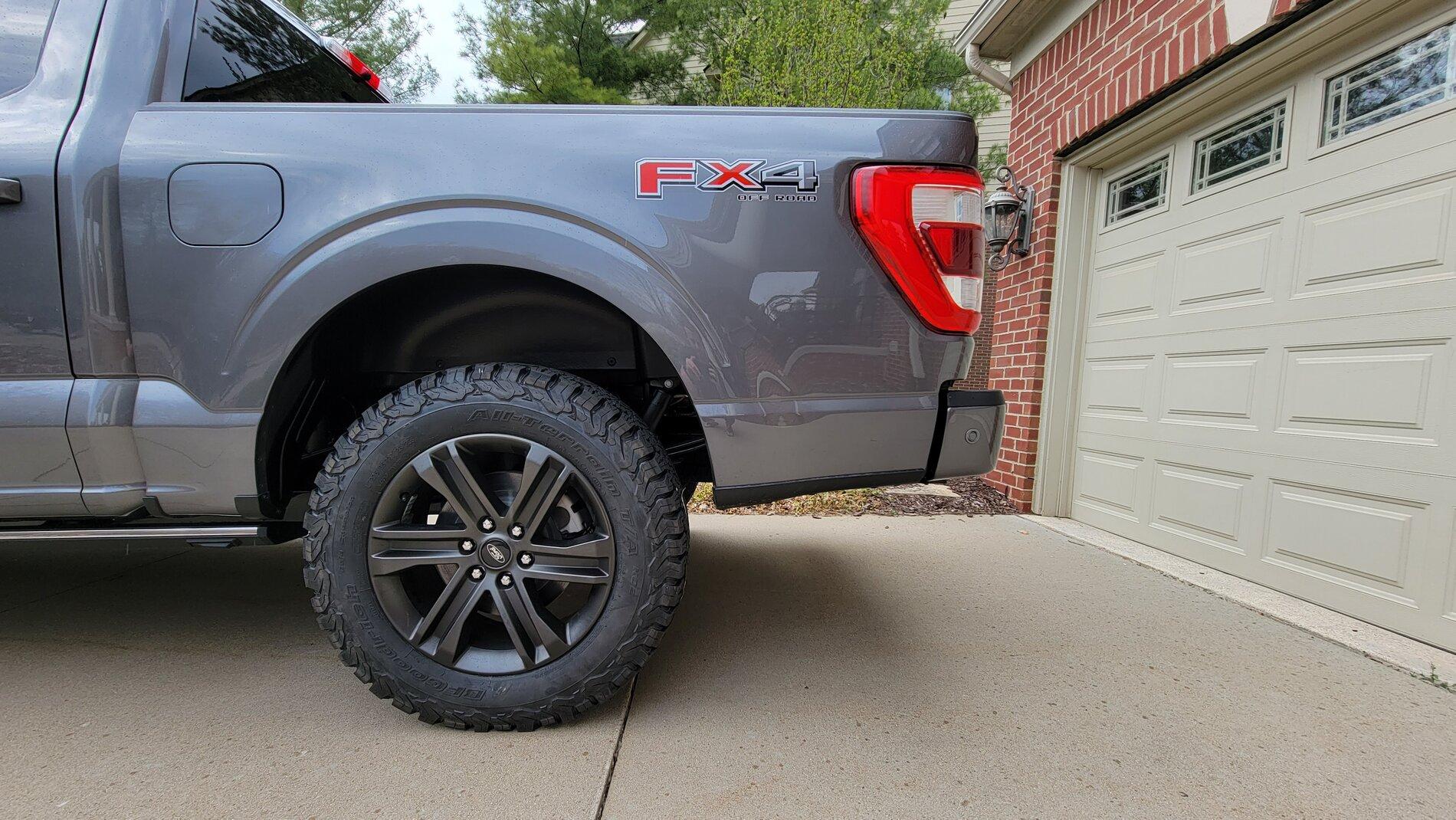

295 60 R20 Nitto Tera Grappler G2 tire.
On level kit.
On level kit.

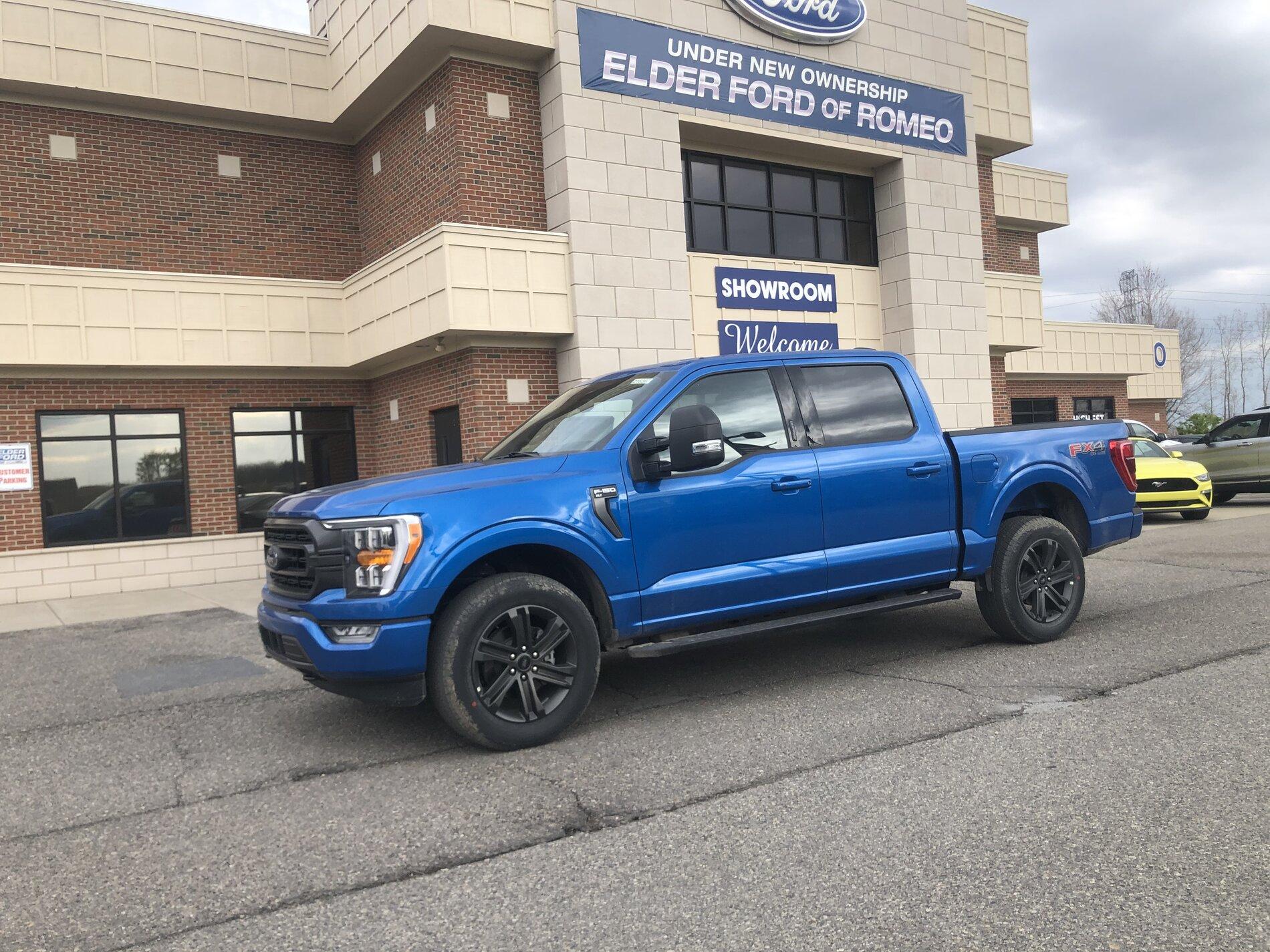

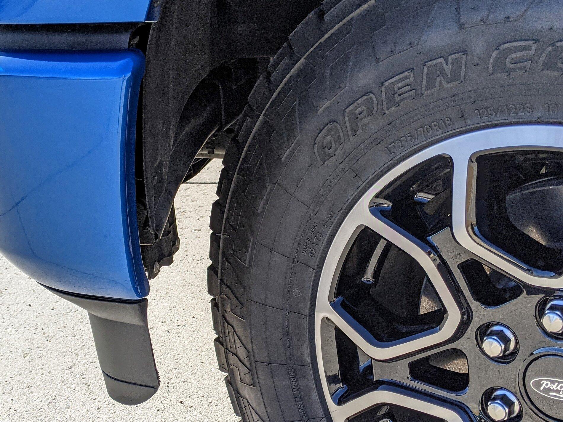

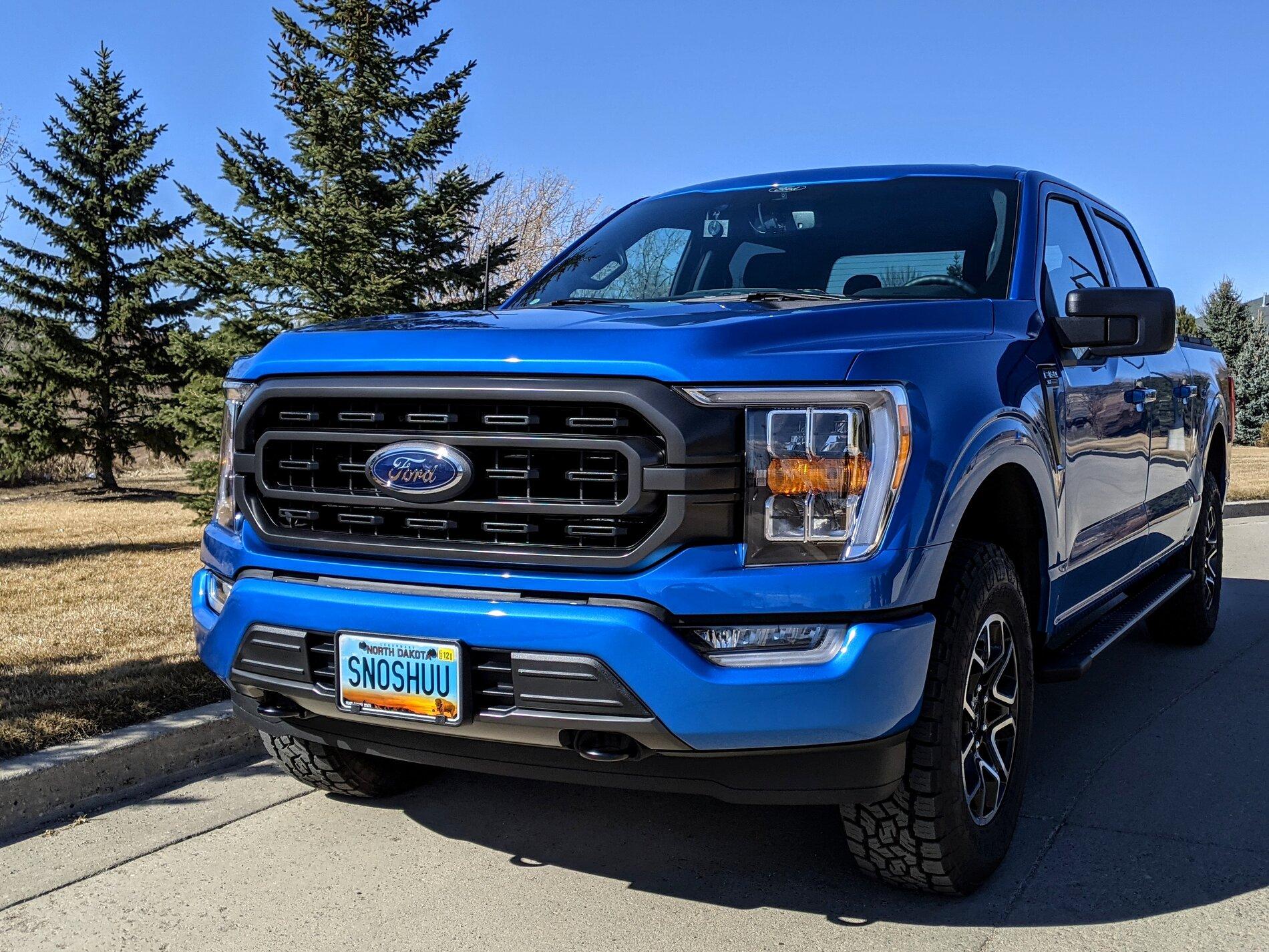

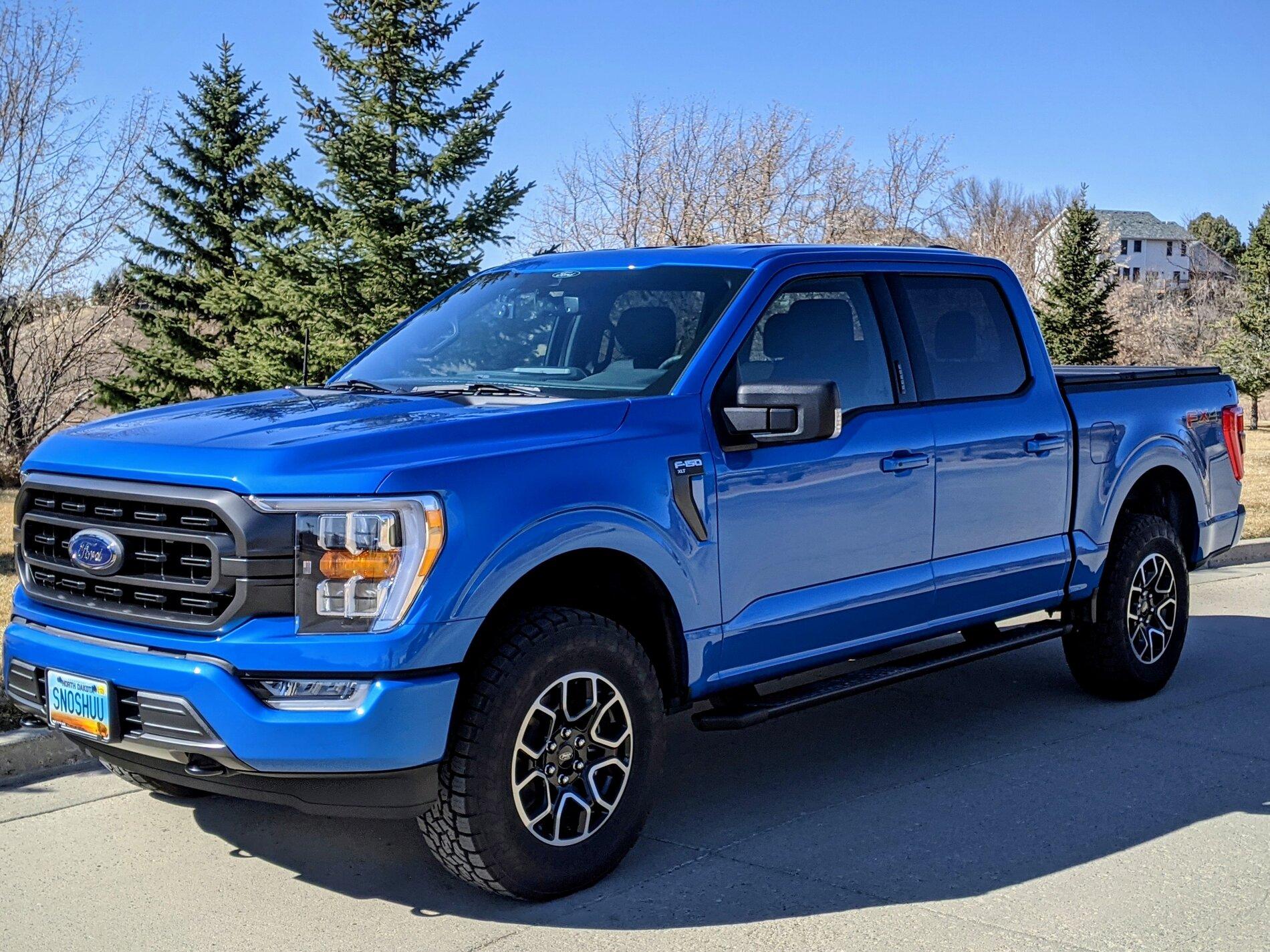

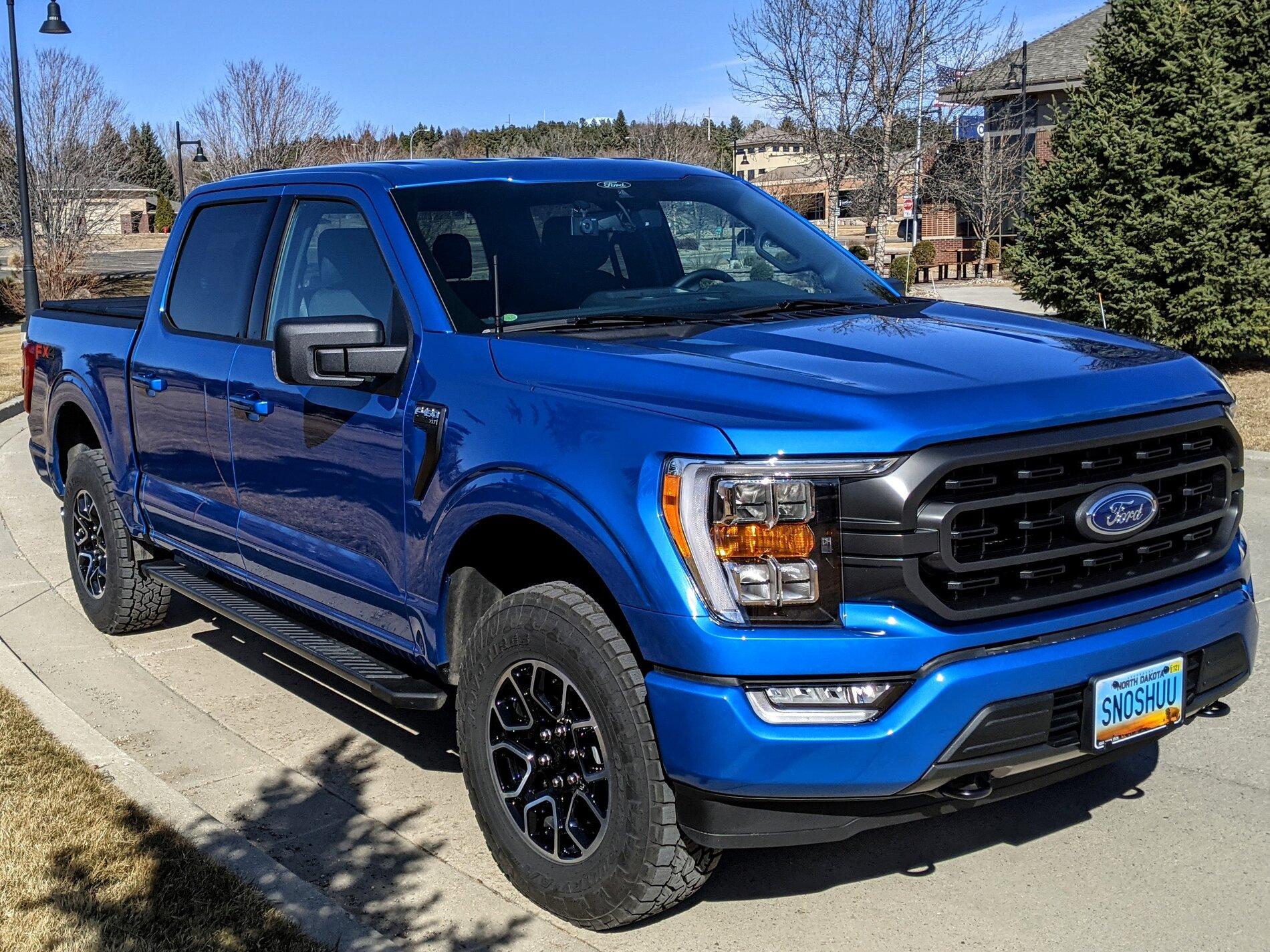

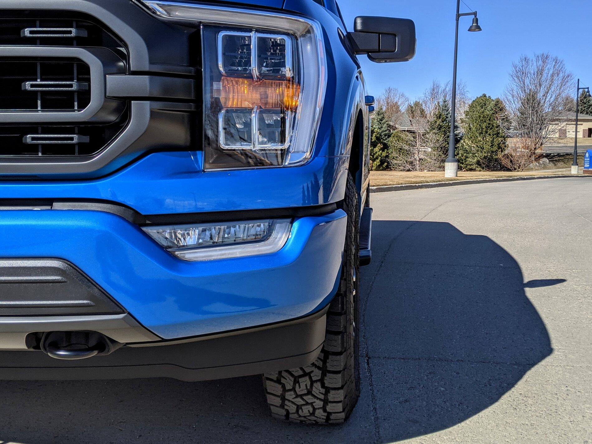

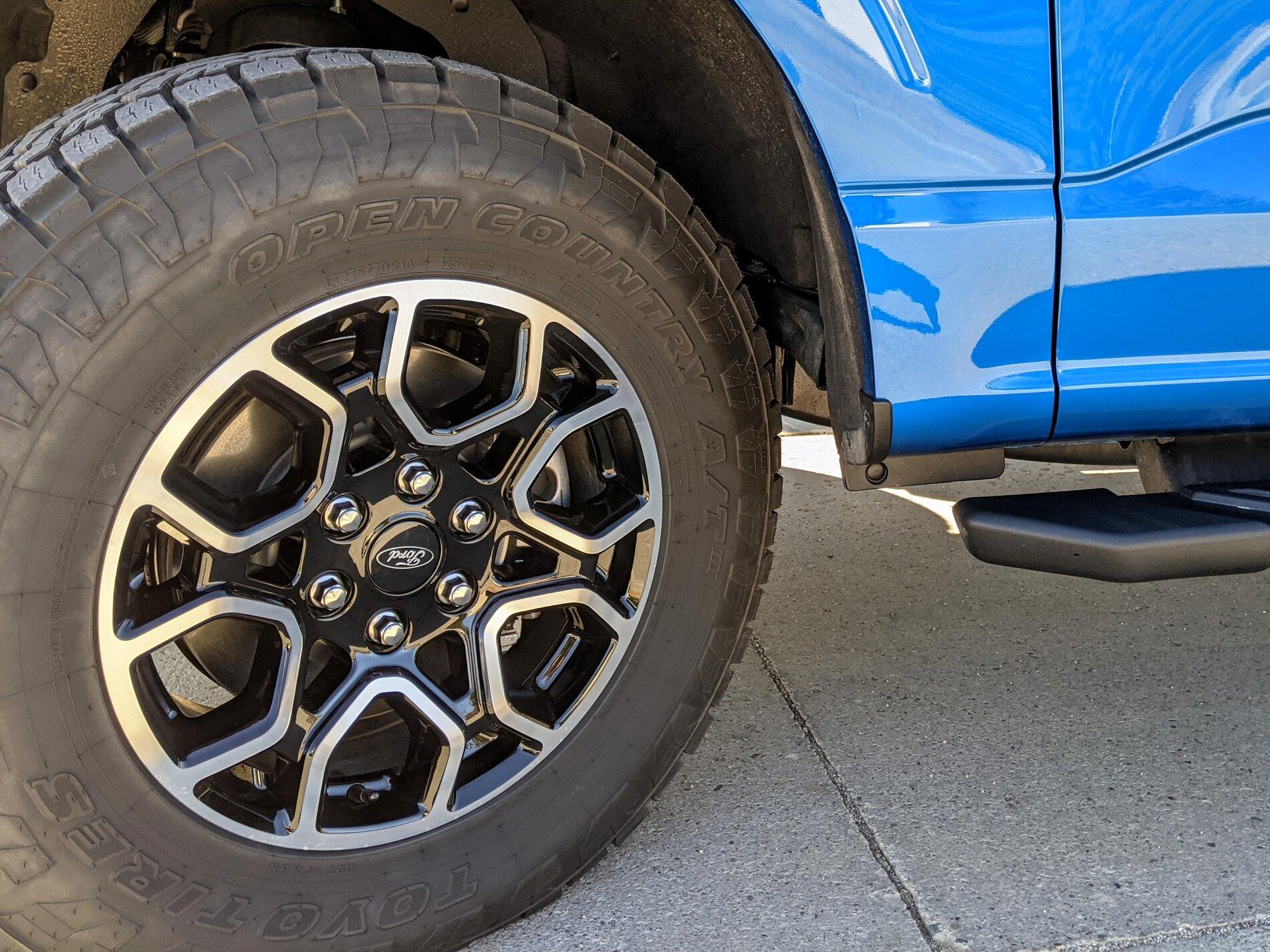

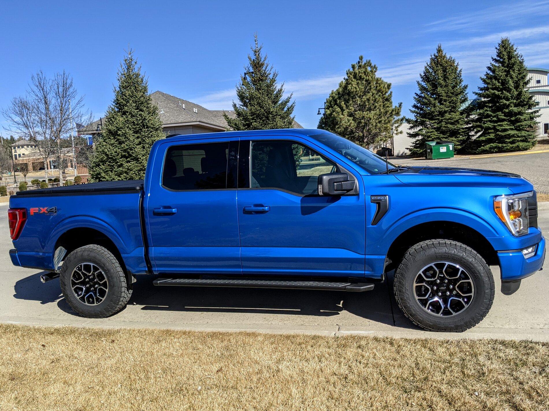

This is the exact setup I’m looking to have. Thanks for posting these photos!Toyo AT3 275/70/R18
2" RC Level Kit
No trimming, no rubbing.

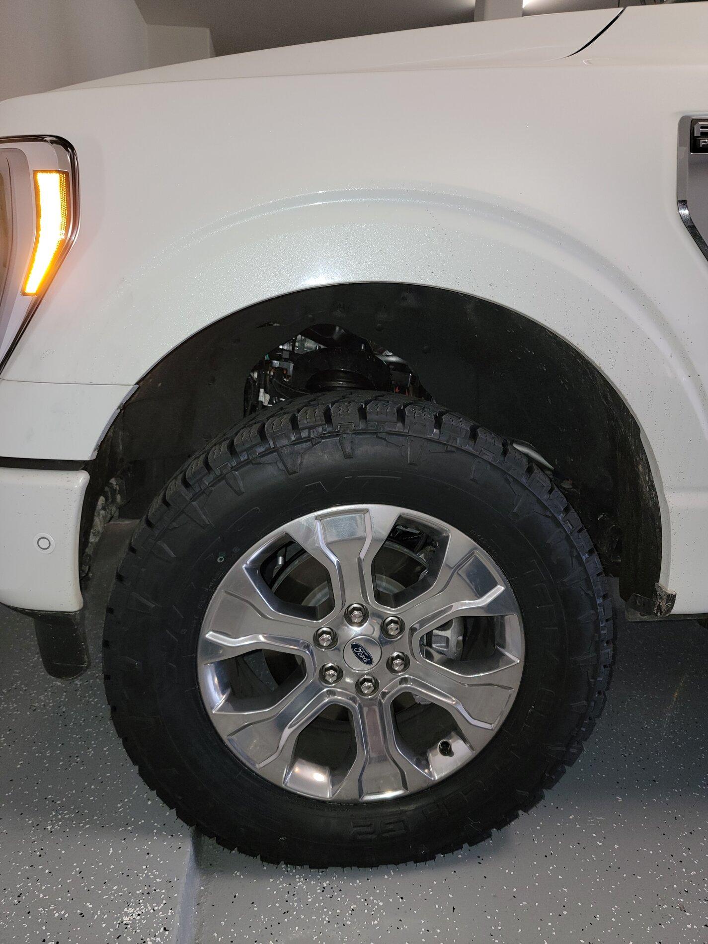

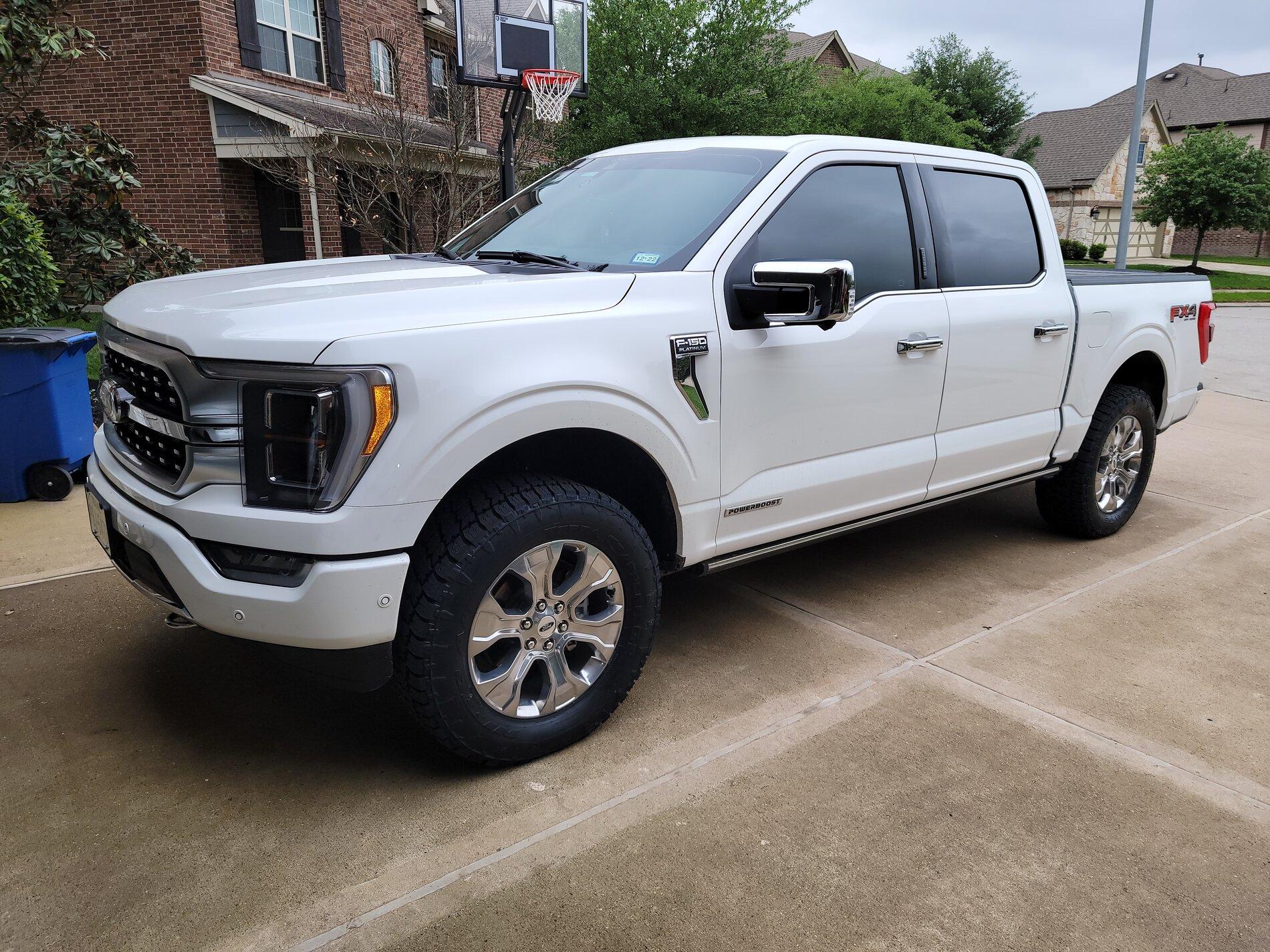

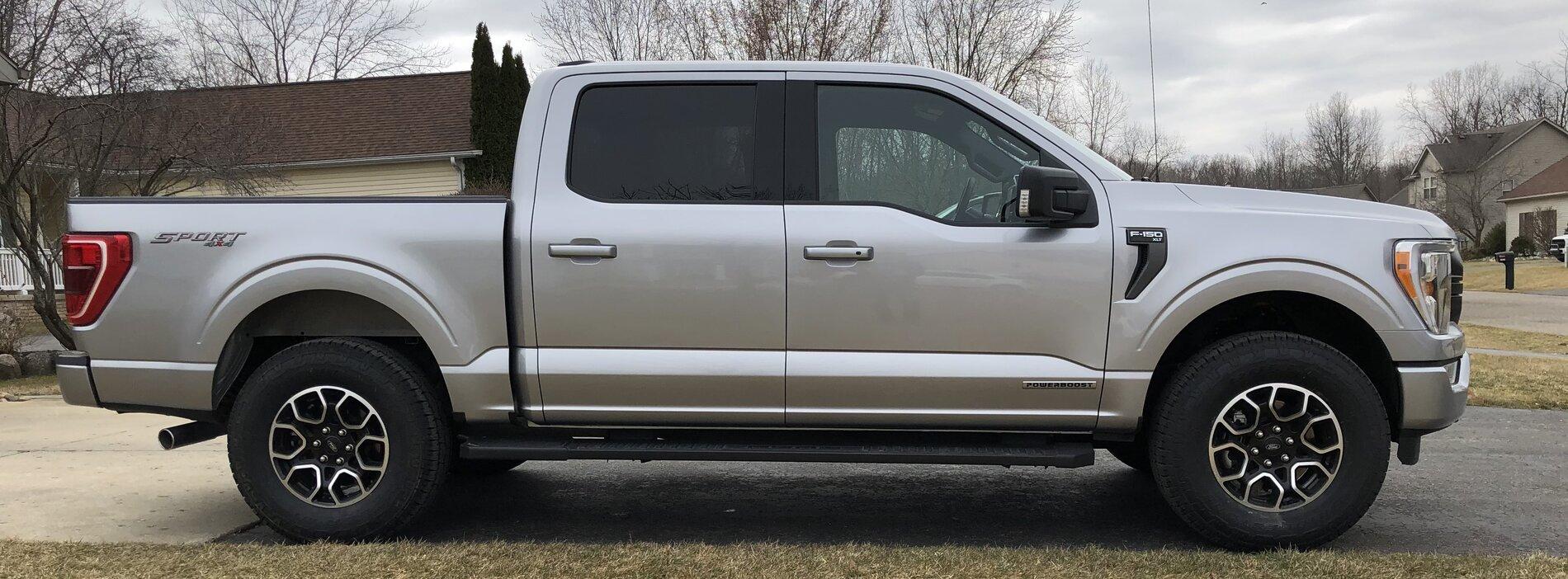

Wow, that looks really good. Now I'm on the fence between 285/65 and 295/60s! I'm assuming that they both would fit without a lift/level. I want a little more diameter but really want to get more width to protect the rims better. I've noticed that the KR chrome wheels are basically flush with the 275 stock tires and I'm hyper paranoid about scuffing them after dealing with very low profile tires on my car for years.295/60R20 Ridge Grapplers. Pro Comp 2.5” level. No issues, no noticeable change in ride, and to me no increase in sound.

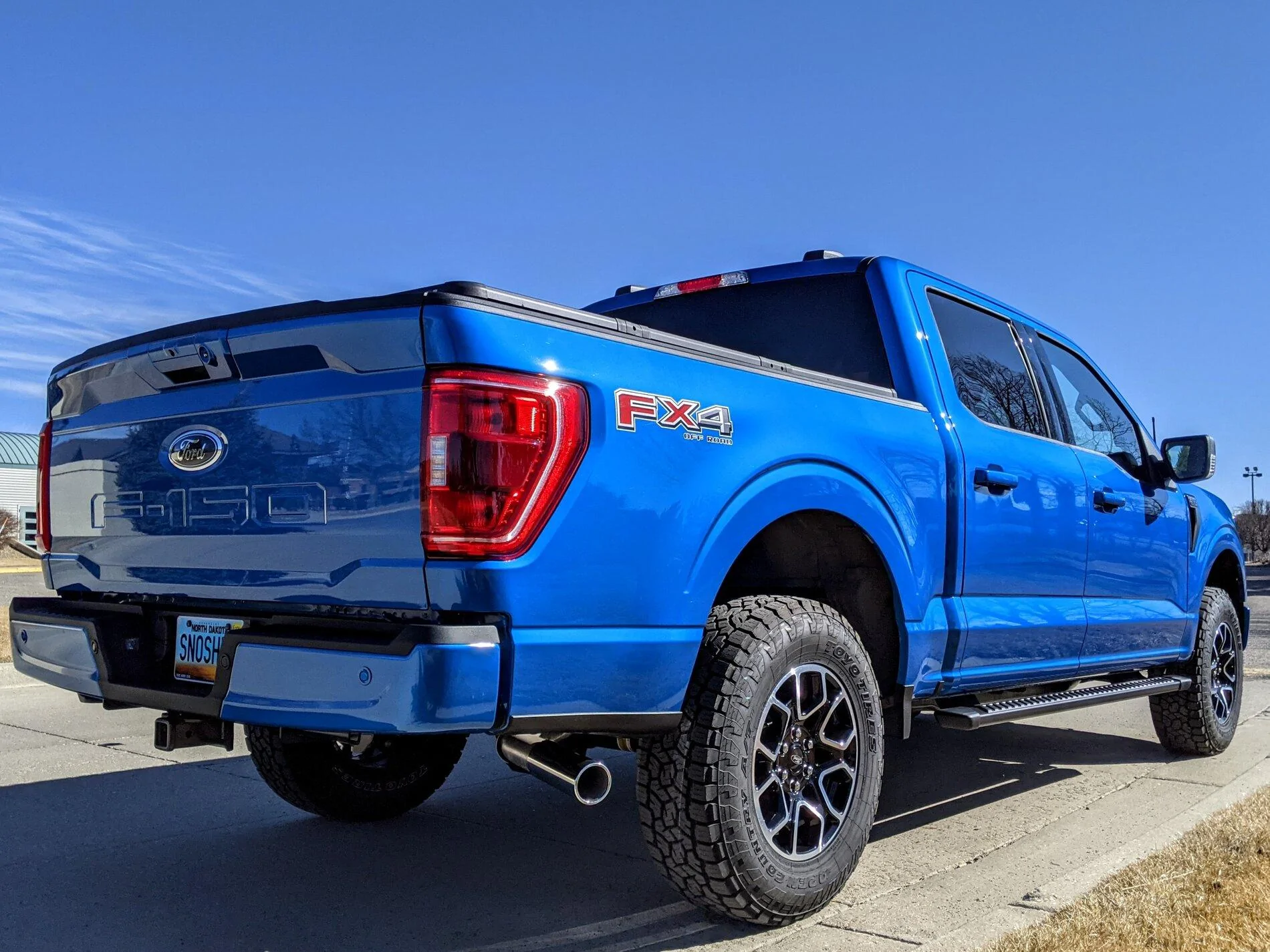

How do you like the extended running boards? I had them on my Silverado and liked them for reaching into the bed, but not many people have them in pics I've seen on this site. I have them in my build, but haven't purchased yet.I didn't that aggressive because my on road to off road ratio leans more towards on road.

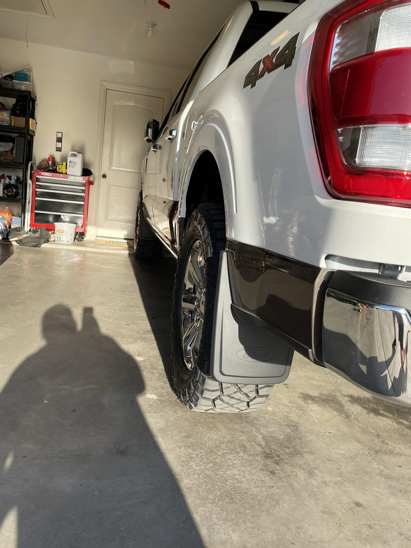

I have 285/60/20’s KO2’s on factory sport wheels without a level. Fits 99% perfect. Just a tiny bit of rubbing at full turn on the rubber fairing in front. I shaved off a milliliter using a dremel.Hi All, I’m looking to go up to Toyo AT3’s in 285/60/20 while keeping the factory sport 20’’ wheel. A tire shop said they will surely rub, while Ford said they “probably” won’t. Looking for opinions on level of rub, if any, at stock ride or with a level. Thanks!
