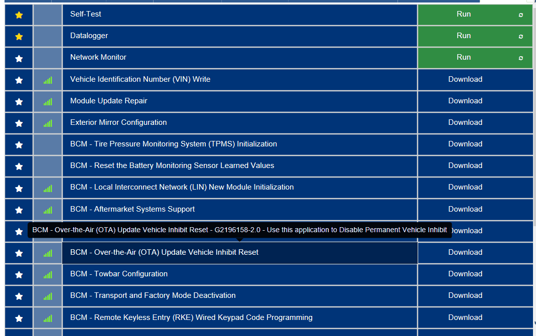

Like Gimme said: It is literally a button. The few vehicles I have gotten to check that were "bricked" during an OTA attempt only failed to come out of inhibit mode. It is literally a 2 minute fix. To anyone with FDRS, it takes longer to fire up the laptop and log in to FDRS than it does to "unbrick" the vehicle.

Your situation sounds like a prime case of the reason that OTA 23-PU1113-UNX-DC was released. Post or send me your VIN and I can look into an issue that could possibly be affecting your truck.
