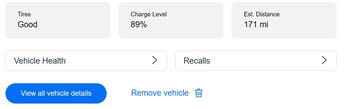

Login to Ford.com, then account, to see charge level of LV battery (why they do not identify that is weird @Ford Motor Company):
Thanks, but I don't get any of that tire, battery, etc. vehicle info on my account page (from a PC or tablet), which I think is because I can't get "connected services" to work which I think is because of the battery issue...a real catch 22.
When I go to connected services I get this:
Connected Services
Access not authorized. If you believe you have received this notice in error, please contact us.
Sorry – it looks like you’re not authorized to access Connected Services for this vehicle. To take advantage of these features and products, you’ll need to either log in with an authorized account or request access from an authorized account using FordPass.
I assume this is because of the battery issue, customer satisfaction program
"Battery monitor sensor replacement, Campaign#23B70" so until I get that done, I am not going to fight with the Ford computer system.
I don't need remote start and all that functionality right now, and if I want the tire and other info, I can go into the truck and see it on the main screen.
If the battery fix doesn't solve the connected services problem, well...whatever as my grand-kids like to say.
