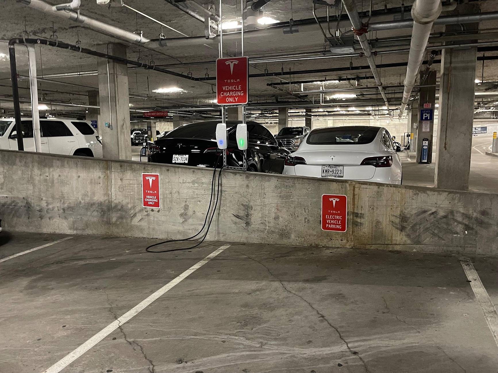

Another option for charging at a low price or free is by using a NACS to J-1772 adapter.
This adapter is used with Tesla destination chargers commonly found at hotels / shopping center / parking lots.
The level 2 Stellar adapter will pay for it self overtime by avoiding an expensive fast charge on the road every night while you sleep at the hotel with Tesla destination charging.
You can use the same Tesla Find Us link to locate Tesla Level 2 destination chargers.

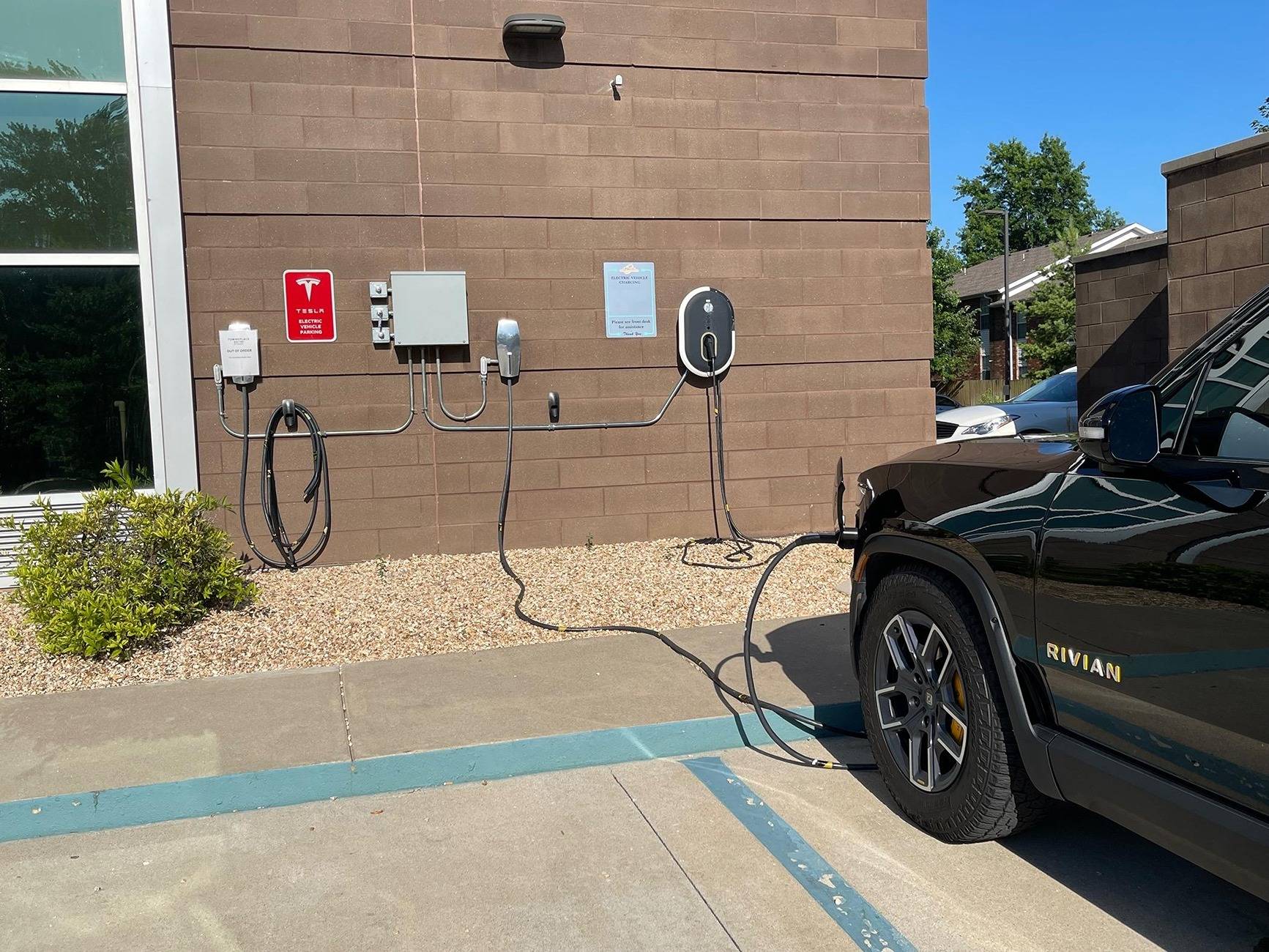

Here is a good example of 10+ free Tesla destination chargers 8 kW - 16kW charging available at a grocery store only if you have an adapter. This is commonly found at malls, shopping center, movie theaters, etc.
