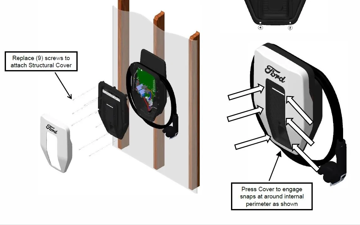

The Install guide on page 7 talks about opening the cover and on page 16 about replacing the cover - it unsnaps via "Hand Pulls" so maybe that info helps? The image of snaping bakc on shows where to push:
"The unit can be left in box to protect from any
scratches or debris. Using both hands, Place
thumbs on inner Black Cover and fingers into Hand
Pulls located on sides of unit to unsnap and
remove the decorative cover and place aside. DO
NOT PLACE COVER FACE DOWN ON ANY ABRASIVE
SURFACES."
