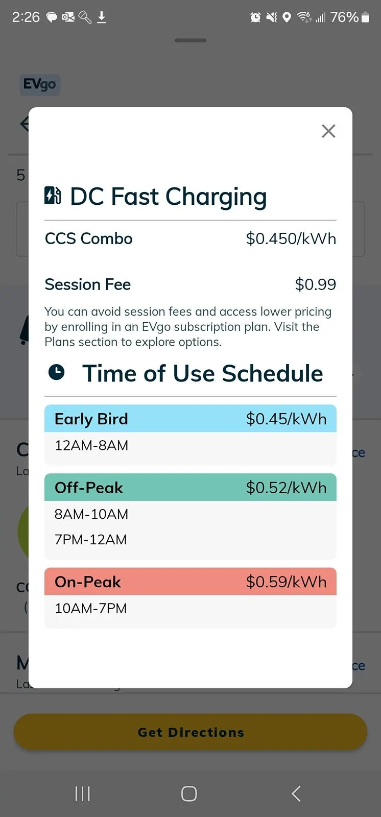

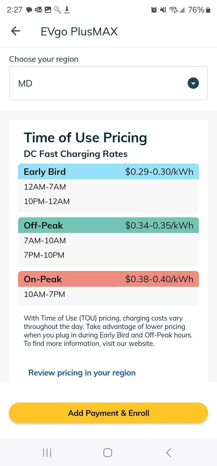

I'm Pasadena, Maryland. Just visited my friend up in PA and drove back last night. It was like 1230 a.m. and I was around 25% charge. I was like, I wonder how the charging locations feature works on the GPS. So I punched it in and for compatible charger for super fast charging, I found one but these were the rates.
*I don't have the ford-tesla level 3 charge adapter yet. (Estimated for October)
I downloaded the evgo+ and noticed there were memberships and stuff. The max % I could see was if you get the most expensive monthly subscription.
