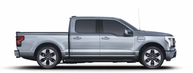

With a symmetric design feature, the F-150 Lightning has a passenger side cosmetic charge port door. Could Ford add a second charge port that would be compatible with the Tesla NACS Supercharger cable?
Ford F-150 Lightning Ford - Is a Lightning NACS Plug Addition possible? 22_FRD_F150Lightning_Plat_ICBS_Length_57280.tif
It's main competitor, the Chevy Silverado EV was able to locate it's charge-port on the driver-side rear, similar to Tesla vehicles charge-port location.
The need to take up two charging stations will become more of an issue as more EVs switch to the NACS charge-port and the Superchargers see a corresponding increase in activity.
Hopefully Ford could do this with a modification to existing F-150 Lightnings and incorporate it into new vehicles starting with the 2025 model year.
This would be a show of appreciation for the Lightning's early adopters and a competitive advantage for all Lightning vehicles.
