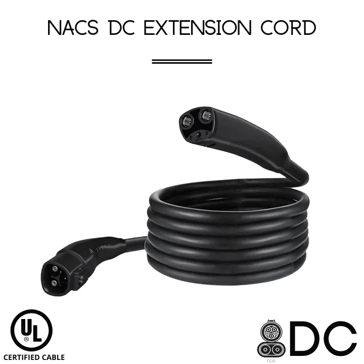

Not quite:
Ford F-150 Lightning Ford - Is a Lightning NACS Plug Addition possible? EXTENSION_NACS

Not quite:
The A2Z extension appears to be going without active cooling which means thicker conductors to keep the resistance and heat down. Its not a shipping product yet, so not sure that photo will be what it really looks like. My prediction is it comes in shorter - like only 2m (6') long to hit their cost/price target with all that copper its going to need to stay cool enough.
Also they talk about active thermal "monitoring" which is another word for throttling.
You will notice the power rating of the extension is not yet published. Its likely going to be limited by current, not overall power. (i.e. 250 amps at 800v = 200 kW, but 250 amps for 400v vehicles like the Lightning is only 100kW).
The tradeoff might be you can reach the charge port, but you can only charge at some reduced current levels.
Hopefully they can get it up closer to 500 amps that us F150 Lightning owners really want.
