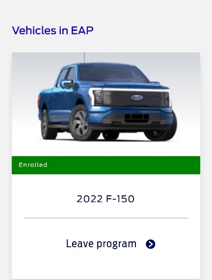

It would be nice if they would maybe use the Early Access for Lightning owners now too. Or if the MachE guys have it tested, just get it rolling. There must still have issues however.
Both my Lightning and Mach-E are registered for the EA program.
