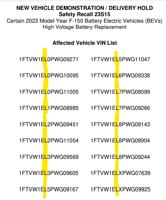

The 18 VIN's
https://static.nhtsa.gov/odi/rcl/2023/RCMN-23V168-3872.pdf
Where window stickers were still available, most were Pro's, a XLT and Lariat all (SR) models

Might be more information about SR vs ER and which packs had the problem. I don't know if they disclosed that part.
The 8 digit of the VIN tells us these trucks were all SR models
Are we sure these 18 trucks aren't just the trucks that somehow made it to the dealers and possible into customer's hands? Does this also include the trucks that were left in transit? I'm worried that more trucks might be affected, but they only need to issue a recall to trucks that were delivered.
Some are special orders and some are dealer stock based on the window stickers that are still visible, about half are no longer visible and the production date tracker shows the others have been delivered.
If there are more trucks affected than what they listed above I would expect to see an amendment of the filing of affected VIN's at some point.
