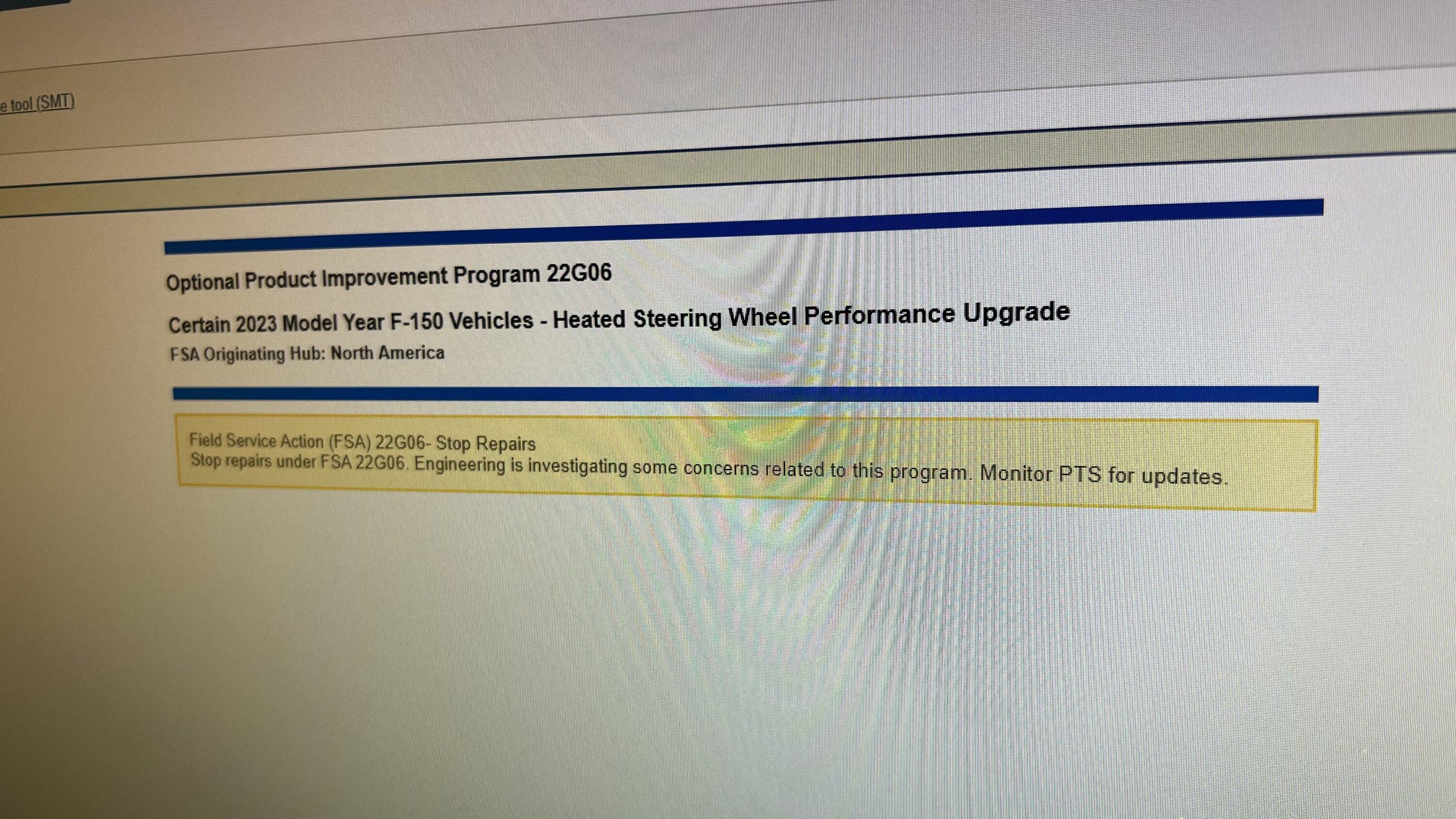

It’s true. It’s a national hold.
Ford F-150 Lightning Ford resumes heated Steering Wheel Repairs (was on hold) IMG_1159
