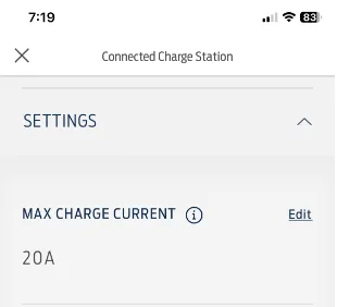

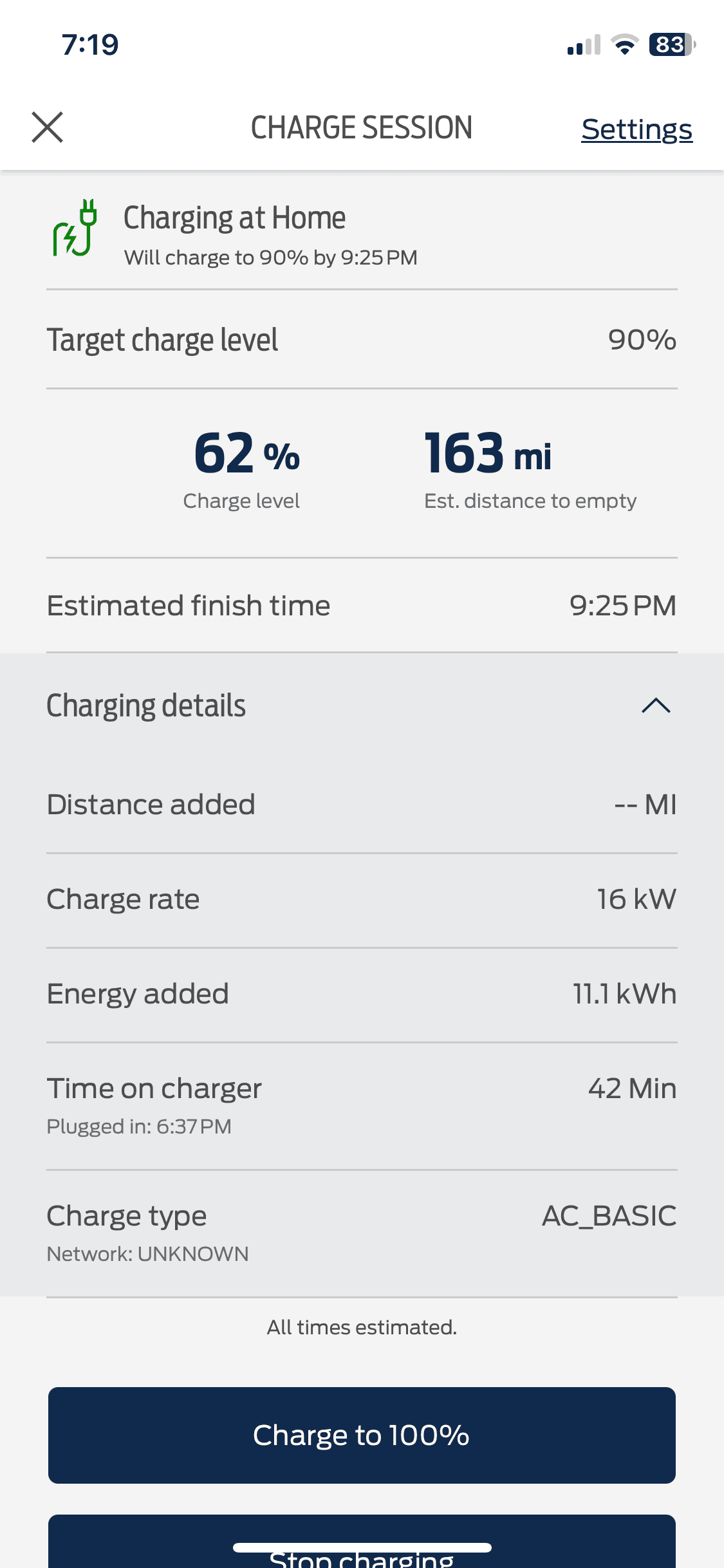

I have the Ford ChargeStationPro installed, and the FordPass app installed on my phone. I’ve set the charge limit to 20 amp in the app but when I charge it’s still charging near 80 amps at 16Kw and not recognizing the charge limits in the FordPass app is there anything else I should be doing?

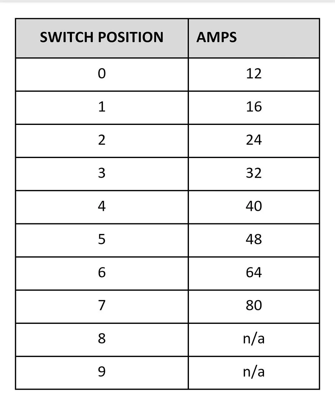

If I have a 60 amp breaker, and I set the charging station under the cover to the proper setting (7 I believe). I'm getting 10.4kw/hr rate. How high can I get on a 60 amp install? Do I need to change the setting in the FCSP? The app was at 16 amps and I moved it to 40 amps. What charge rate should I receive?

If you're on a 60 amp circuit, you can charge at 48 amps. Position 5.

Your charge rate will depend on your voltage. Multiply your voltage by 48 to get the rate.

So originally the installer set it to 5, but it only charged at 16 amps. I'll have to check, but it seems I am maxed out, which I wanted.

7 & 6 settings are unsafe for your breaker and I'll assume the matched rated wire, restore it to position 5!!!
Lucky that you are driving a 2024 Lighting it can not draw more than 48 amps, but the setting 6 & 7 are unsafe conditions if you plugged a higher capacity Lightning or other vehicles capable of more than 60 amps!!
The installer did everything correctly for the parameters of your 48 amp truck charging system.
It was only charging at 16 because of the software limit, which you changed.
10.4 kW sounds about right for 48 amps. Depending on where you are getting that number, that is at least 220V.
