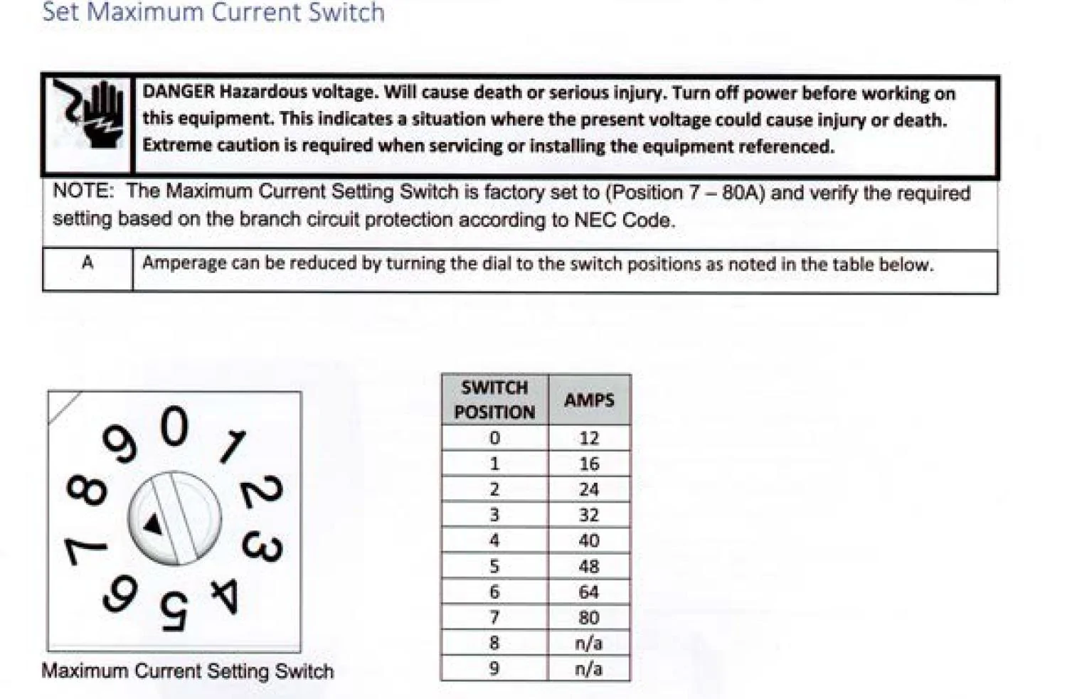

If you don't need the 80A option, and 60A or lower is fast enough, turn the circuit board dial down to a lower rate.
A lower rate is better for battery longevity.
My SR battery is limited to 48A by the on-board charging circuitry and so far it seems to charge at about 44A according to the truck data.
I could get by with less, the Mobile Charger's 30A/32A is probably enough for my uses (all local driving), I just am hesitant to use it on a daily basis due to all the posts I saw about failures of it.
I don't need 80A but I do like having it. Most of the year it isn't a problem, but last summer I did get a few notifications of the unit overheating and it would pause/resume. Haven't noticed it this year yet. I'm not worried about the rate and battery health, the C rating from 80A to 48A is 0.13 to 0.08 which is to say not much. The size of the charging deltas (20% to 80% vs 50% to 70%) will likely have a bigger impact than charge rate when it comes to level 2.
That and I'm too lazy to take the panel off to access the dial :D

I considered dialing down to the 32A setting, the truck (SR) circuitry keeps it no higher than 48A which means I can go from 40% to 60% in a bit over 2 hours and leaves around 6-7 hours to balance cells before I use the truck at around 10am - 11am.
Assuming the FSCP has 240V at it's input (I should open the cover and measure it one time when it is charging to see) it seems to be pumping somewhere around 44A into the truck circuits - a calculation number, not measured by me.

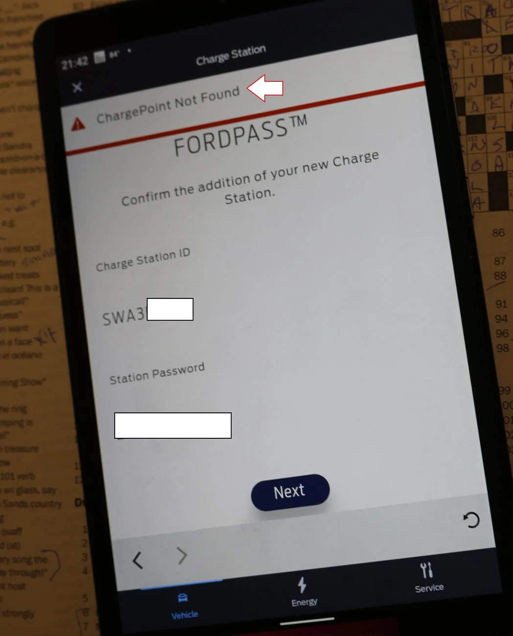

FordPass on the tablet sees the FCSP, the FCSP setup app see it too and then there is the "confirm" step which errors out.
This step had always been iffy even way back in October 2022 when I was setting up my FCSP, eventually the linkage to my FP account was made, I don't know for sure but it seemed like it took a few days for the systems to acknowledge each other.
The few times I did a factory reset and reconfiguration, the same delays and roadblocks occured, but after a few days, just performing that last step worked.
FCSP has WiFi connectivity only.
Use the Sync feedback reporting system to remind the engineers of this ongoing failure.

I have tried that last step to connect the FCSP to FordPass a number of times over the past few days, and will keep trying until it happens.

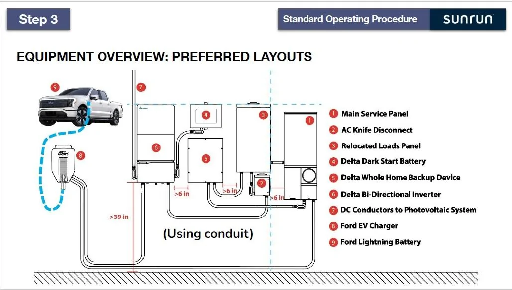

Looks like it should be a fairly "easy" install at least from a hardware standpoint.
Ford F-150 Lightning Charge station pro Ford Pass connection issue HIS preferred layout
I just need to figure out where to mount it, seems like putting in near my house main service panel (basement) would save on wire and conduit, but I have more wall space in my garage.

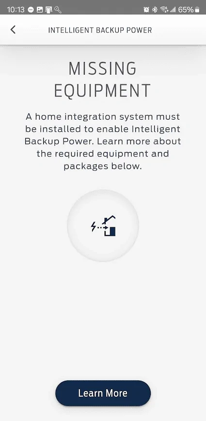

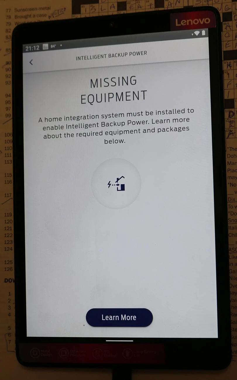

I tapped on that menu item and it just said missing equipment so I don't think I need the FordPass connection:

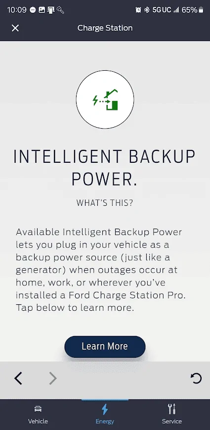

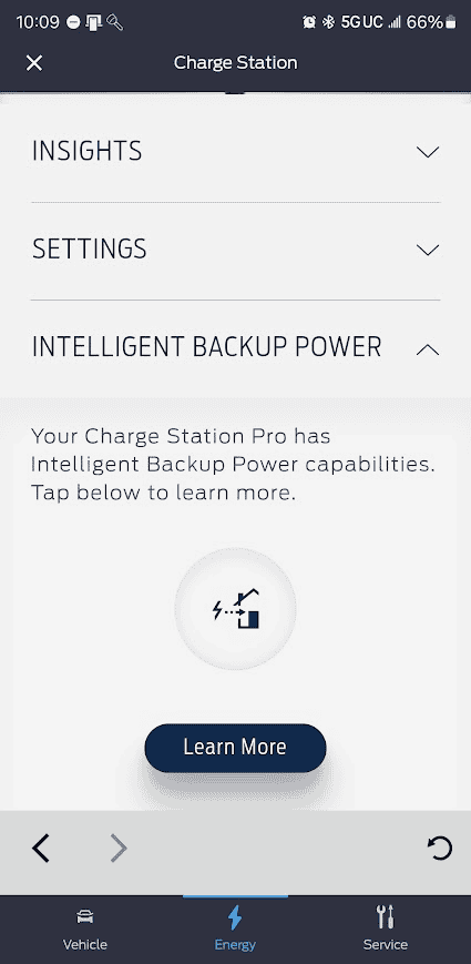

Right, but that's what I also see as a functioning FP user w/o the HIS equipment, so curious if you will be successful or not.
Ford Pass View0

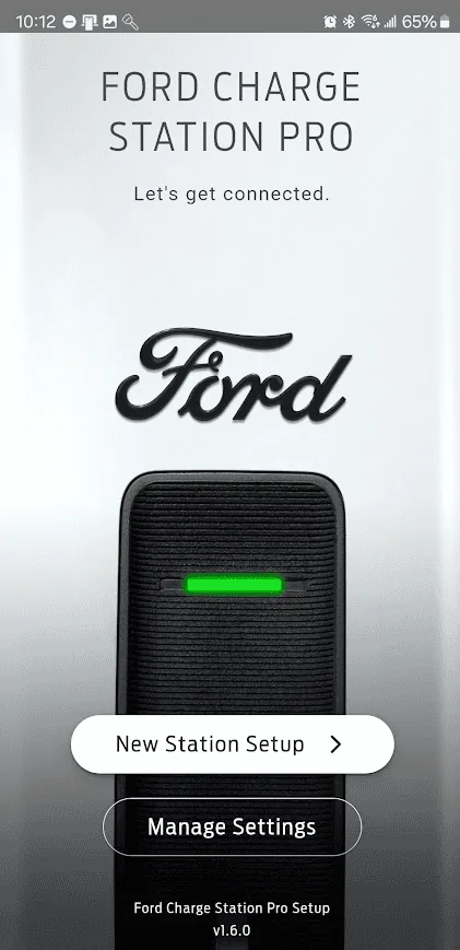

FCSP setup utility view:
Ford F-150 Lightning Charge station pro Ford Pass connection issue 1721096119998-st
Ford F-150 Lightning Charge station pro Ford Pass connection issue 1721096141265-54

to connect the FCSP to FordPass!
Ford F-150 Lightning Charge station pro Ford Pass connection issue IMG_5643-connect to FordPass 4-error
