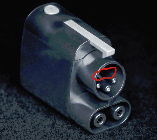

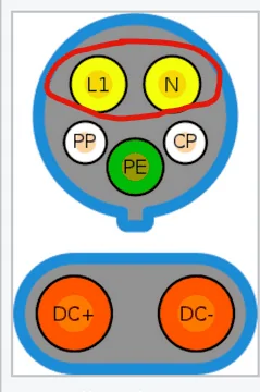

Anyone know if these will do AC charging as well as DC Charging? I thought the A2Z does not, but perhaps someone who has one has tried?
IIRC Tesla uses the same pins for DC and AC charging. The car figures our which one you're doing and has internal mechanisms that adjust things accordingly. Fords don't do this as CCS has separate pins for each. So these adapters shouldn't be able to do both.
Plus if you look at the picture of the Ford adapter, it is missing the AC pins on the CCS side. DC only.
