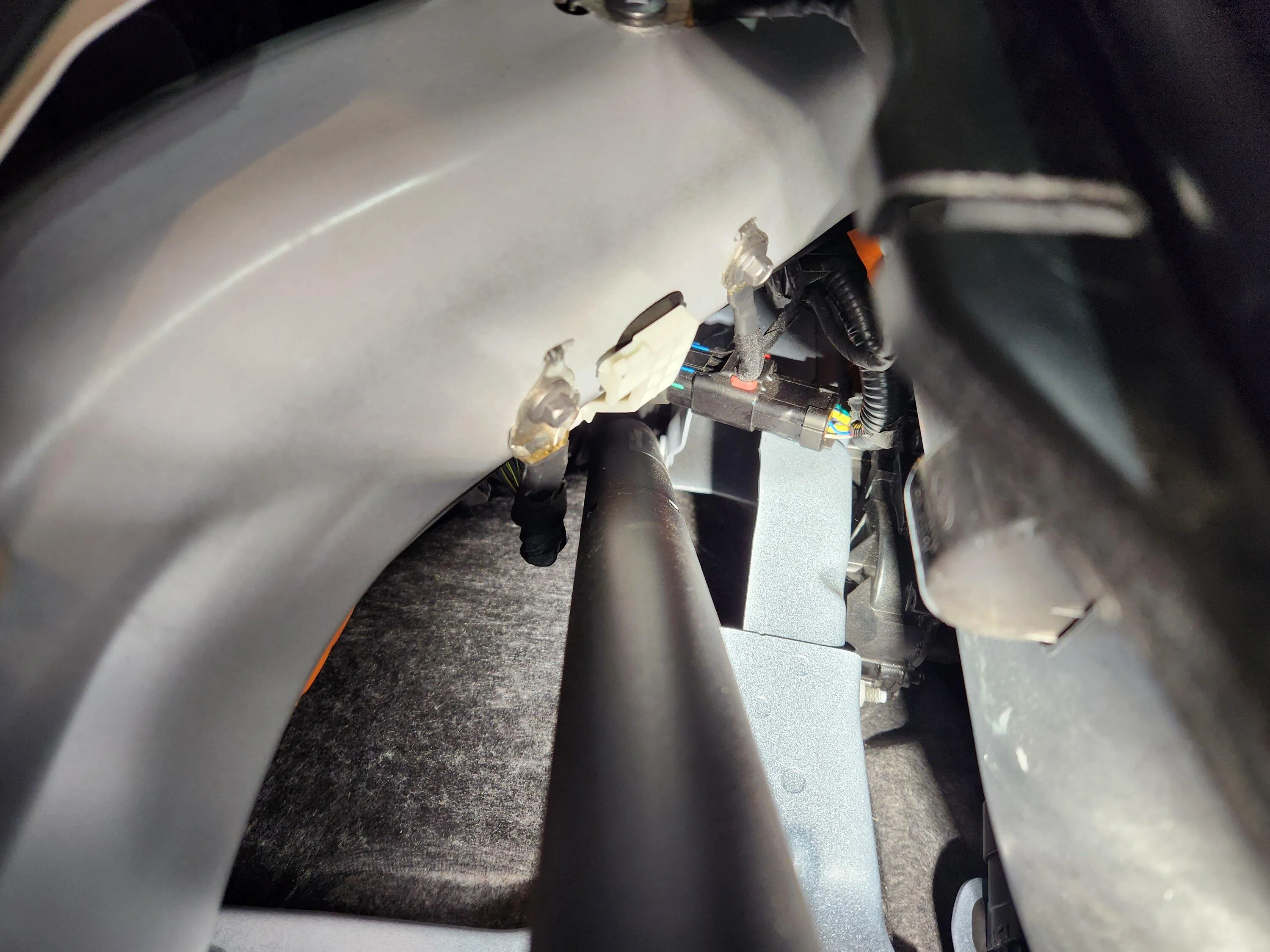

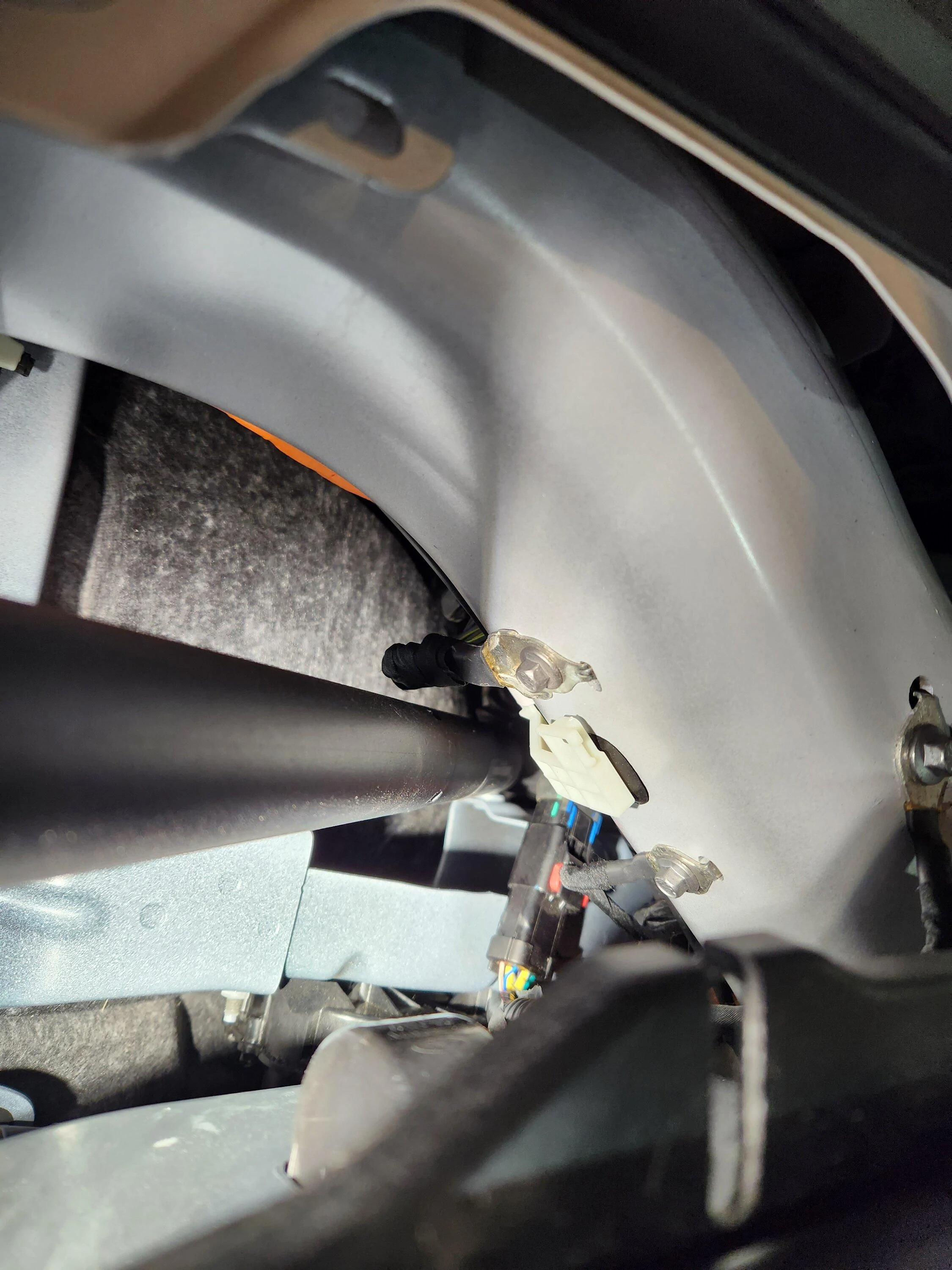

So an update:
I spent yesterday evening working on the truck trying to identify what could be causing the failure.
I looked for water intrusion or really any evidence of water at all near the lift strut harness connectors and unsurprisingly there was none. I double checked both relevant fuses and they were still fine.
I did a 12V battery reset and with both battery cables disconnected, connected them to drain all capacitors in an attempt to get as many modules to reset as possible.
Still no luck.
But just as I was ready to give up, I remembered reading something about the emergency trunk release button in the trunk being pushed and then requiring a full manual cycle and push close to reset the system. So I gave it a shot.
I closed the hood as far down as I could while still being able to reach the button from the outside, I pushed the button. The rapid alternating chime could be heard from the cab. I then manually opened the hood all the way and then closed the trunk completely and pushed down firmly to latch it. It still didn't function. But then I pulled the manual release again and cycled it fully open.
And then something crazy happened: when I pushed the button on the hood the trunk began closing. It's been working ever since.
So I'm not sure what exactly caused it, again it could be water intrusion that finally dried out, but again, based on how little rain there was that day and the complete lack of any evidence of water in any under-hood spaces, this seems unlikely although I'll be sure to report if driving in heavier rain causes the issue again.
As of now, I'm still wondering if it has to do with the last software update as it was soon after that last update that I also suffered that odd software glitch that replaced rhe Lightning icon in the top left of the head unit with a Mach E icon and some major range calculation issues.
Anyway hope this is the last issue I have, but I will definitely update if anything changes!
