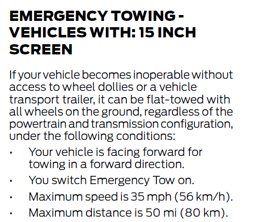

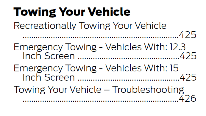

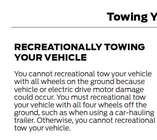

I didn't think car dollies are safe for EV's.

Ideally the Lightning should have all wheels off the ground, otherwise slow speed and short distance with all wheels on the ground
