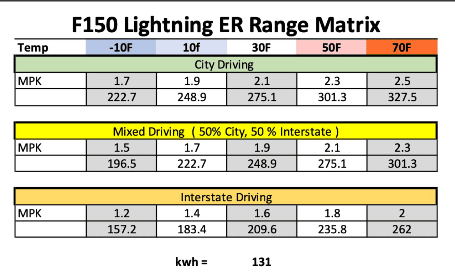

Tell your wife to figure out in advance the miles/kWh needed to make the trip. And accept that range drops dramatically at highway speed.
I recently planned a 260-mile foliage tour in northern Maine on a route with ZERO high-speed chargers; I knew I HAD to make it back to the CSP at our camp for a recharge. I calculated in advance that I needed to get at least 2.0 m/kWh (or shorten the trip.) When I make the frequent drive from Boston to our camp in Maine I get much less than 2.0 m/kWh because it’s mostly highway. But it’s not a problem because the trip is only 140 miles, and the CSP is waiting for me!
Well, the foliage tour was all on back roads, with an average speed of 45 MPH so I was hopefu I might get the 2.0 required. I charged to 100%, and set a start time of 8 AM. The truck turned on at 7:25 AM. I reset one of the trip meters, and then watched the miles/kWh carefully throughout the day. At the non-highway speeds, the miles/kWh stayed between 2.2 on the way up into the mountains, and increased to 2.4 by the end of the trip. I got back to the camp with 50 miles to spare.
It’s all about figuring out in advance the miles/kWh needed to make the trip.
Can you tell me the math behind figuring how many total miles (DTE) when you know your mi/kWh? For example, if you are burning 2.0 mi/kWh, what is your DTE?
Please explain the math behind that.
2 x your battery size, which is either 98 or 131. If you're at 43% charge, multiply the answer x 0.43.

So I have the ER Lariat, please show me because I get 320 according to Ford at 100%, so you are saying if I get 2.0 mi/kWh, that is the "2" that I multiply my battery size (131) then take 90% of that number? That gives me 235 DTE
3,837
4,973
Yes. 2 X 131 X .9 = 236.
ETA…in cold weather, your battery capacity will be somewhat lower than 131. Plan conservatively.
No, you get 320 according to the EPA calculation.
2 x 131 = 262. That's your range at 100% charge, going to empty.
At 90%, your range would be 262 x 0.9 = 235.8.
But, you don't go to empty, you recharge at say 10%. So, it's 90 - 10 = 80%. 262 x 80% = 209.6 is your distance from 90% to 10%.
In reality, on the road, you charge from say 20 to 80%, then back down to 20%, then ... So...
0.6 x 262 = 157.2 miles between stops, after leaving your house with 100%, which if you went down to 20% gives you the 209.6 on the first leg.

To get 320, you'd need to achieve 320/131 = 2.44. Unless you do a mix of highway and city driving, and it's warm, and you don't drive fast, you won't ever get that.
