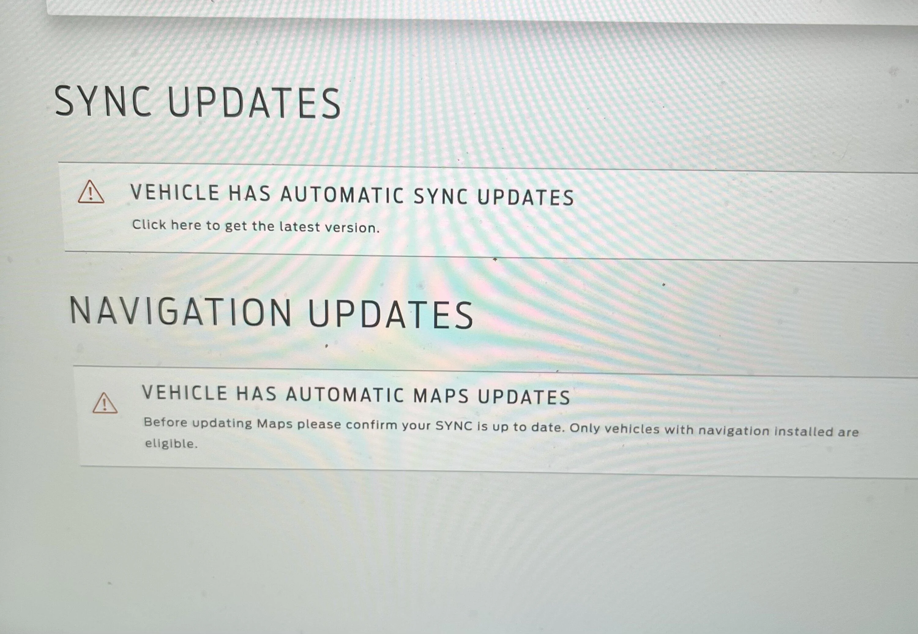

This is what ford.con says when I enter my vin for updates. You weave you’re way to the install via usb page and it just talks about turning on automatic updates.
Running SYNC Version 4.0.22294
Same issue for me...
btw, I have an appointment at the dealer on the 16th to hopefully get this resolved....
When I talked to Ford customer support, they told me to reference Technical support bulletin TSB22-2105 when I drop it off.
