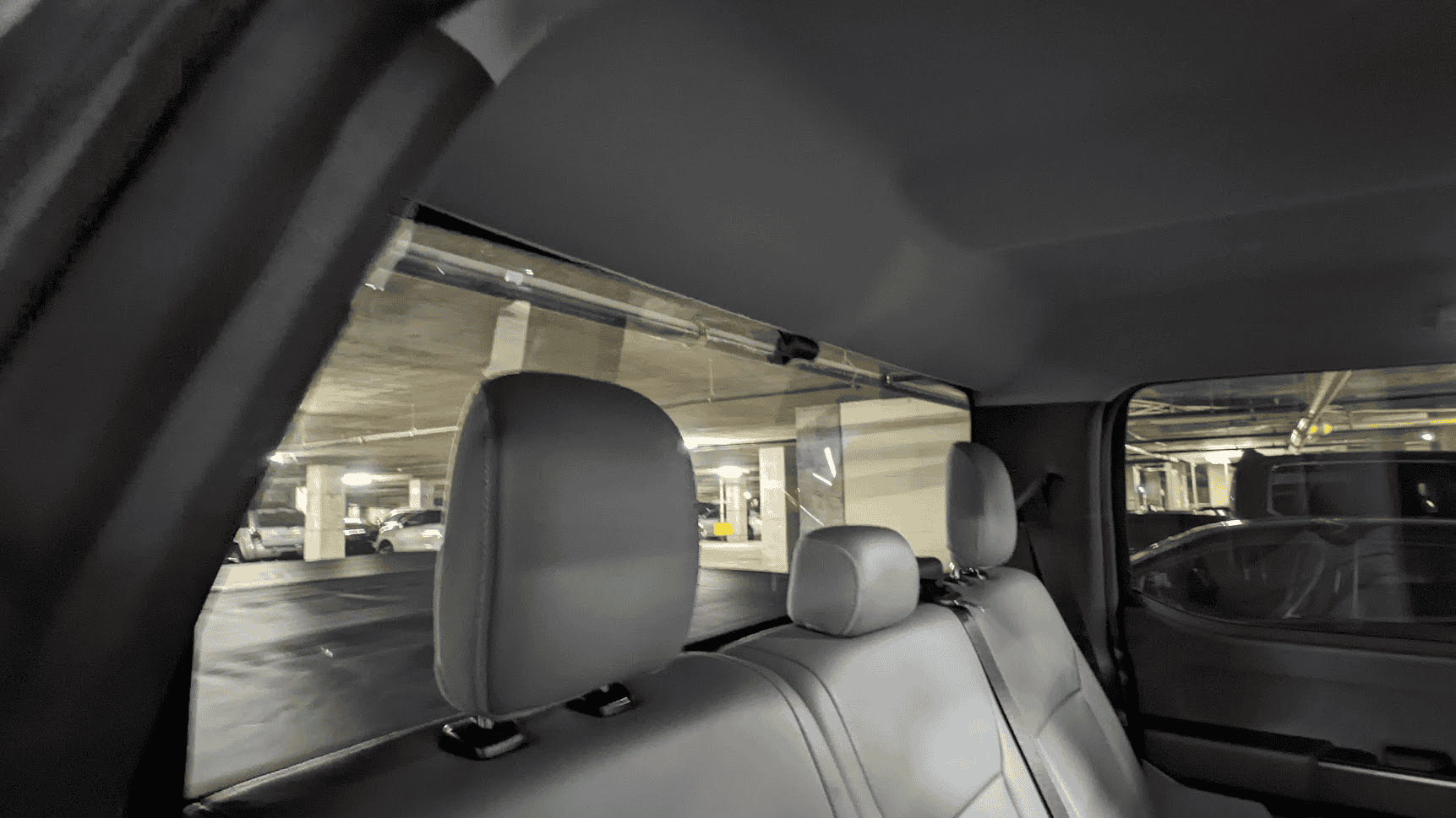

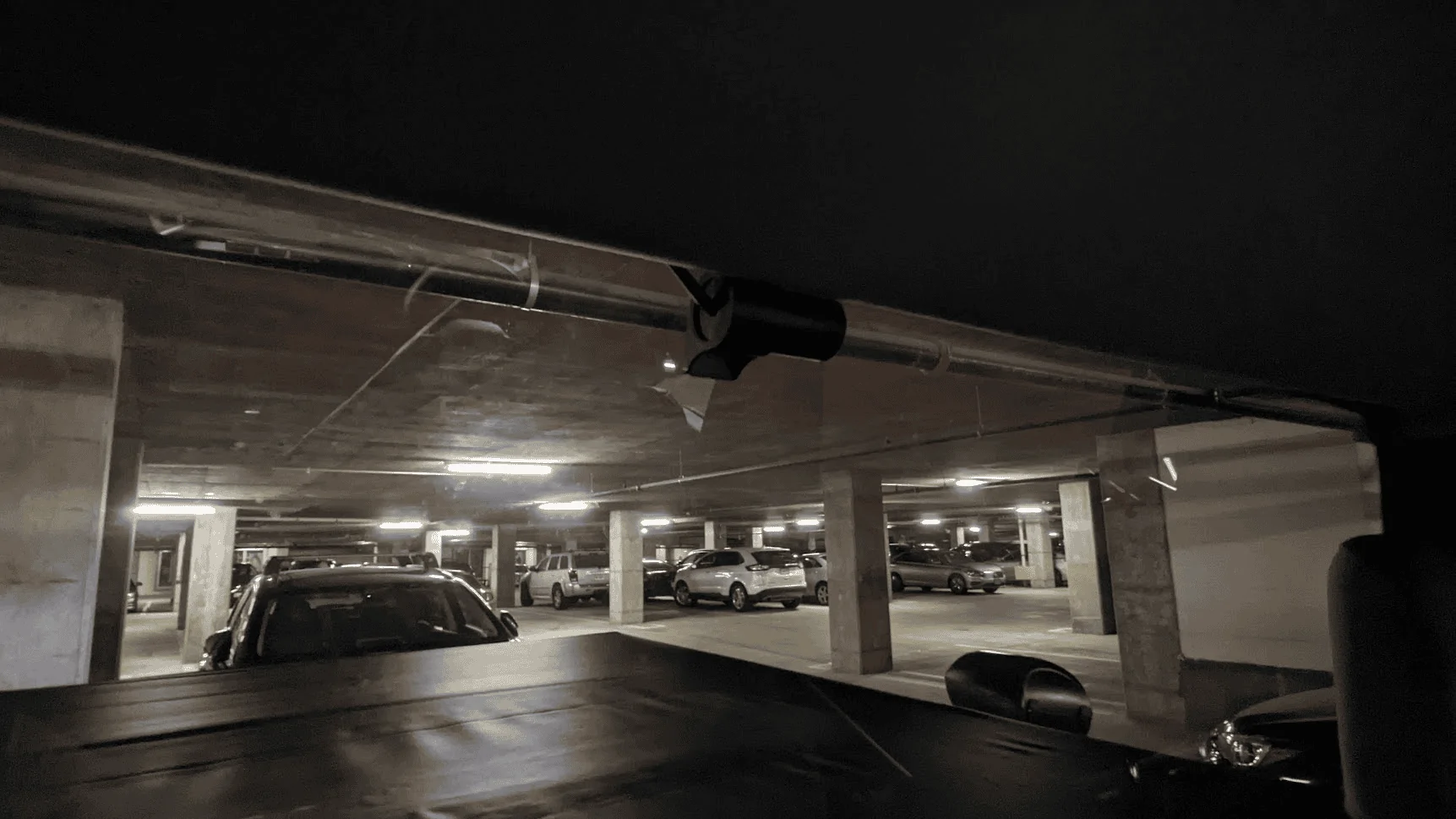

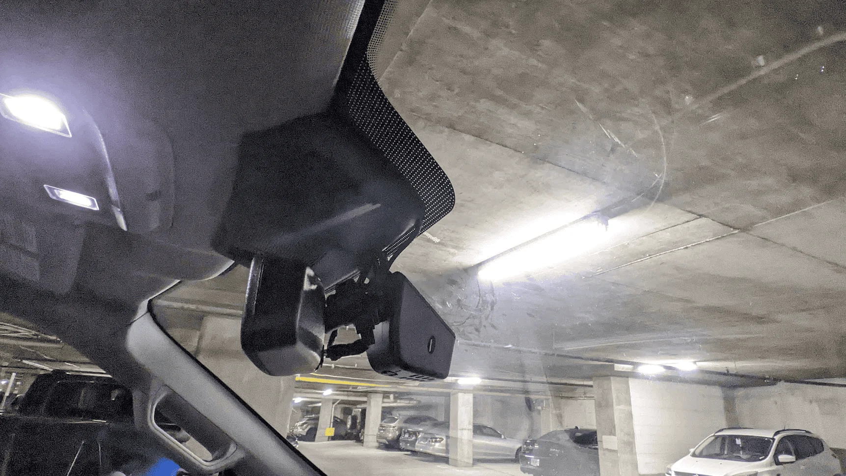

Today I finished installing the rear cam as well. I ran it through the front windshield and roof liner and then took the top part of door seal stripping and ran it through the roof all the way back and then ran it through the rear windshield and the roof liner. The rear cam sits right by the roofline. When you take the seal stripping out, it's pretty easy to run the cable. The cable ends up being really long so i hid the extra cable inside the rear passenger door plastic trim after removing the seal strip.
vsansal
Volkan
Jun 27, 2022
117
98
Arlington,VA
F150 Lightning Pro, Tesla Model Y Performance
Here are the pictures for reference

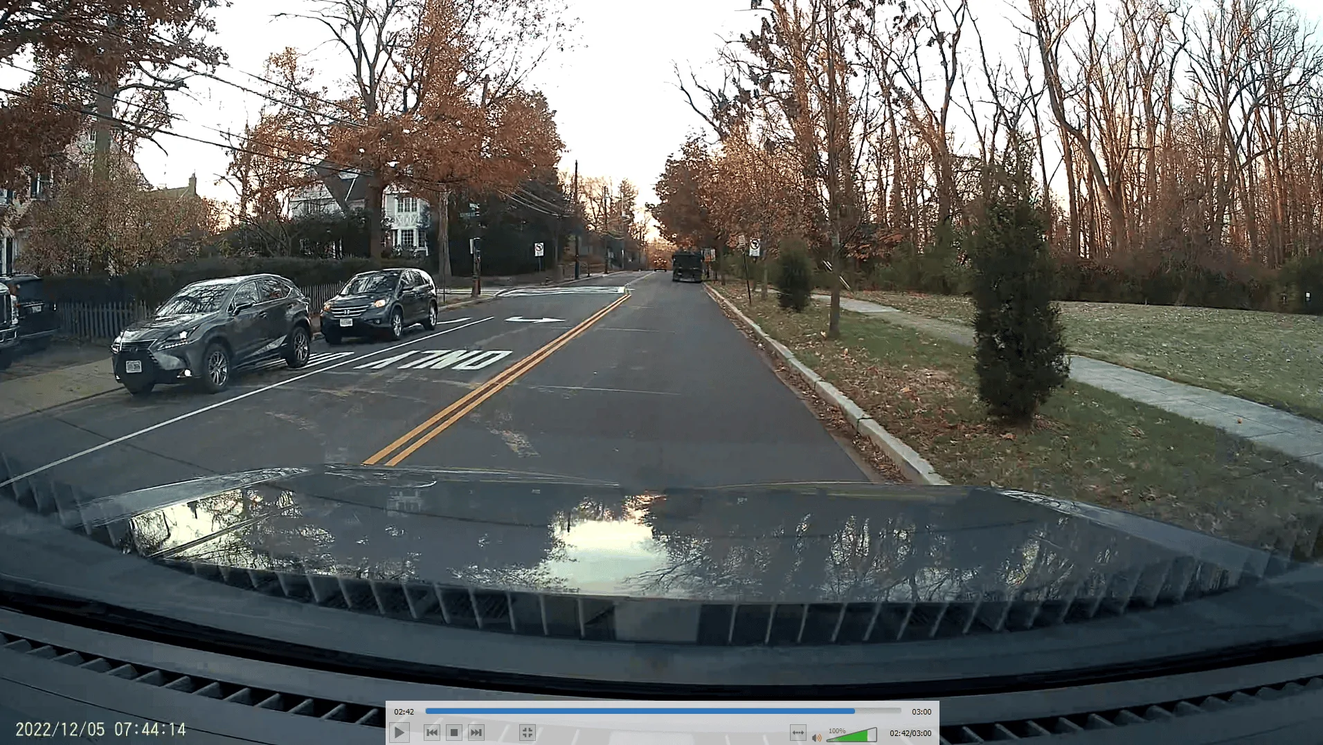

Here is a screengrab for the rear camera angle
Ford F-150 Lightning Just installed this Dash Cam in 5 minutes 1670246911738

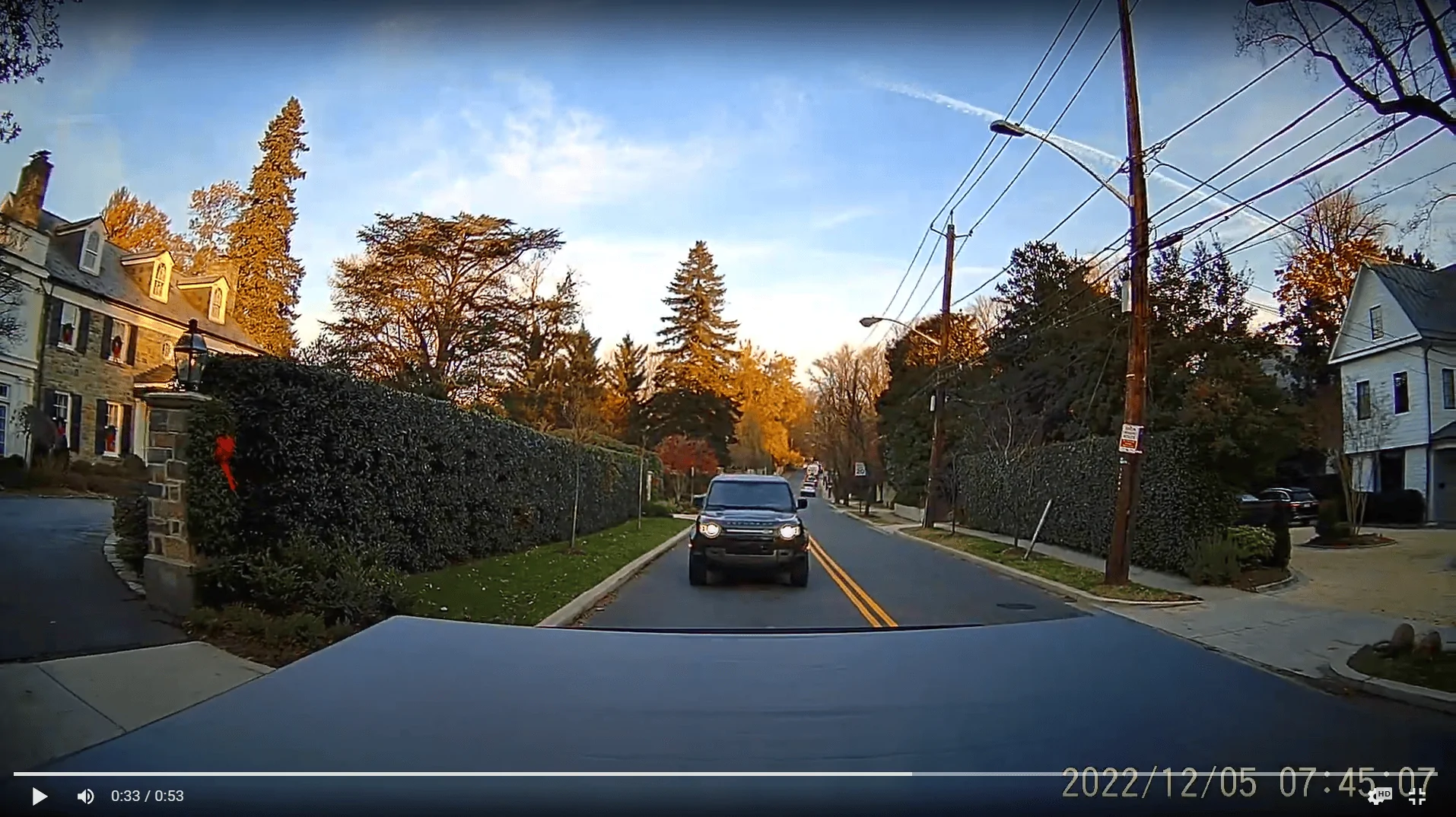

and here is one for the front camera
Ford F-150 Lightning Just installed this Dash Cam in 5 minutes 1670247087366
