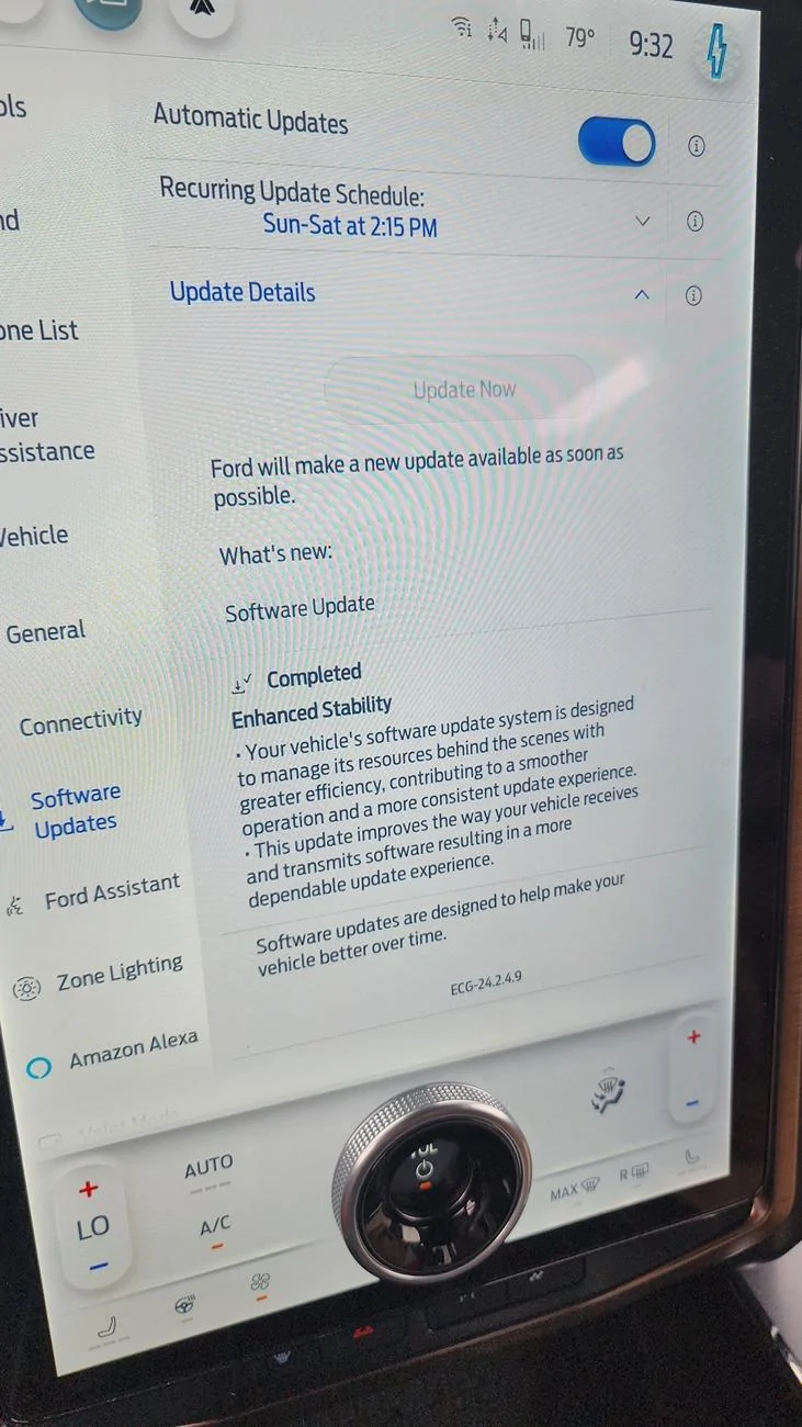

Finally! Five days shy of my 1 year anniversary, I finally received an OTA update! Hopefully this breaks the logjam and I start getting many of the others mentioned on this site.
Ford F-150 Lightning Lack of OTA Updates...Am I the Only One? 20240706_093239
Great. Hope they keep rolling in for you.
BTW, the Recurring Update Schedule time is best set to a time when you likely won't be driving the truck. A few updates don't allow the truck to be driven when they are installed.
Most folks set it around 1AM.
That said, the 2:15 PM time you have might be right for you.

Thanks. I've tried several different time windows. Figured I'd try a time that others are probably not using, hoping the server bandwidth is more available. In my case, being retired and doing most of my trips in the AM, I'm usually not driving in the afternoon anyway.

Files are downloaded as soon as the OTA trigger is accepted by the vehicle. Then the files just sit there until either the auto-updates schedule installs it or the owner manually initiates the install. A 1am install time is not recommended because it allows the vehicle to sit and the 12v battery drains. Best time to initiate the install is after the vehicle is taken for a drive and the 12v battery is topped off.

That's the new gateway update that opens the door for the new APIM (Sync) update to Sync 1122.
That's the one that is NOT available for '22 models yet....sadly.
