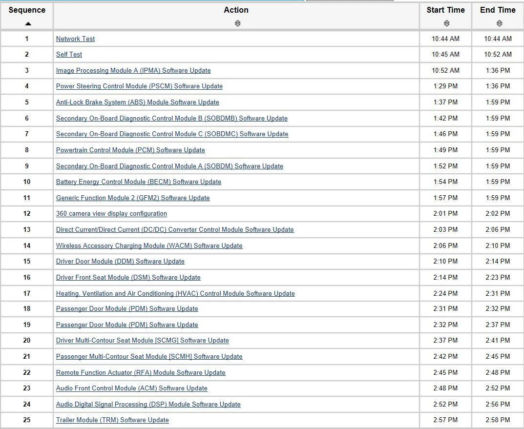

Updated two fellow lightning owners today and got to experience the IPMA fun. Really is like watching paint dry. Someone needs to put a supercharger on the mongoose. Below was everything out of date on a 2022 Platinum and had to fix the small 360 camera that a dealer previously fudged. Guess I'll go ahead and update mine this evening once it cools down some since I already have the license.

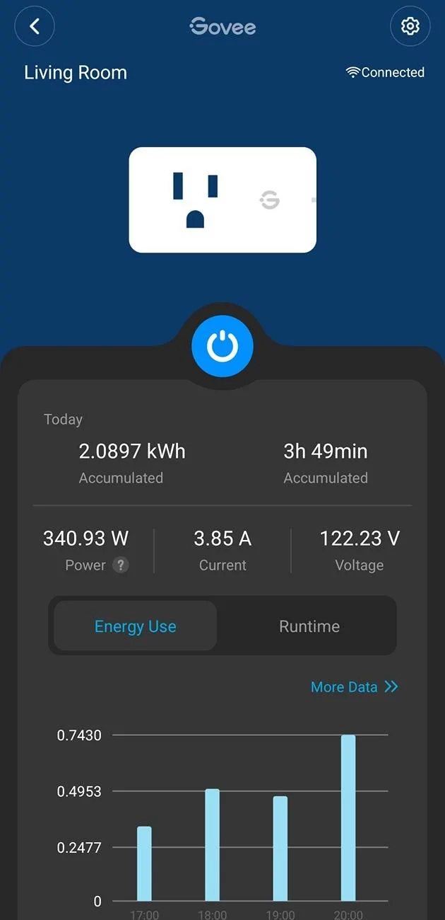

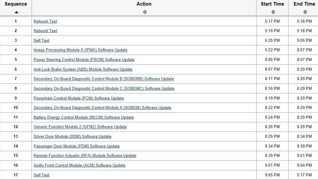

Took about 4 hours to do my updates. Govee outlet monitor showed I burned about 2kWh over those 4 hours and held a steady 10 amps during most of the updates. This is the actual power supplied directly from the house and not what the power supply is pushing (usually 60 amps+) Oddly enough the IPMA never showed above 5 and the truck voltage never dropped below 13.1 where some of the others updates went as low as 12.4. RFA took surprisingly long compared to the truck I did earlier today and when I updated everything on mine last fall.
