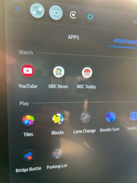

The second thing is your truck probably will never need to connect to your home Wi-Fi for anything unless you want to sit in the seat with it in accessory mode and play some Youtube videos or watch some of the ABC content.

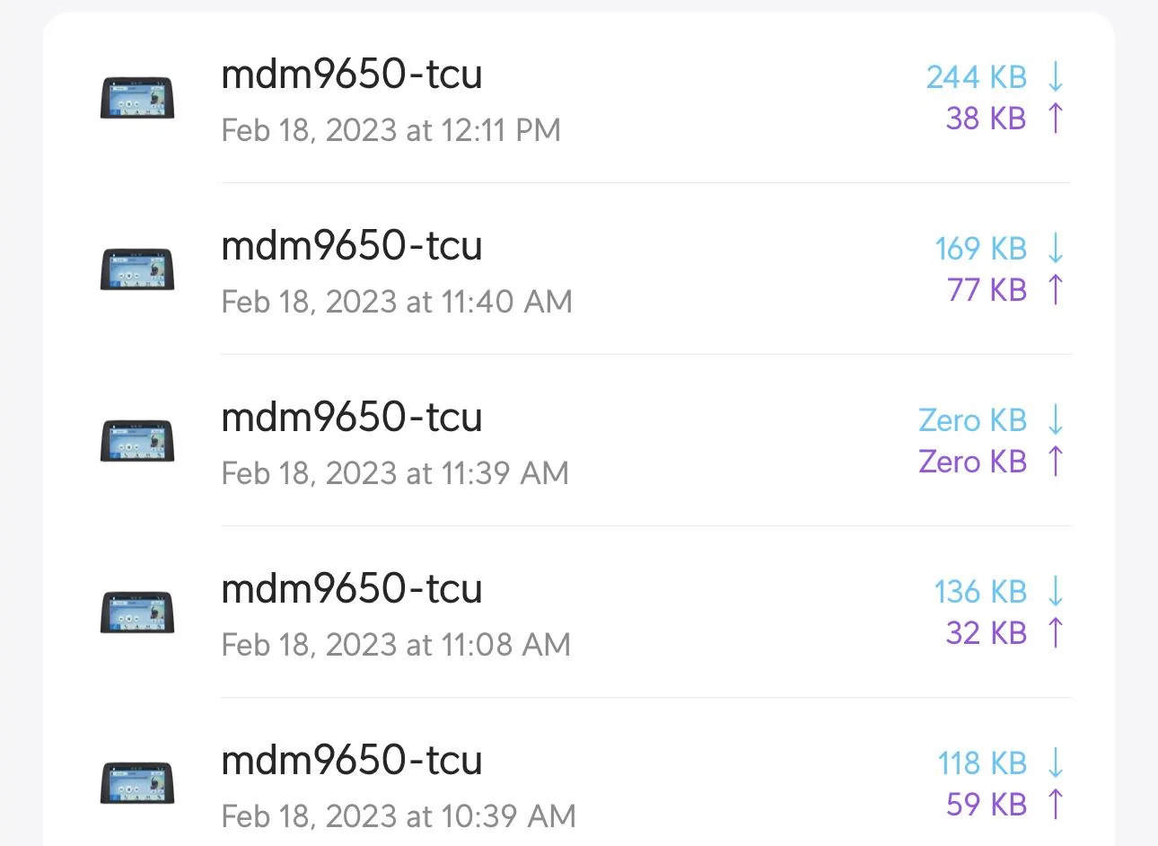

Both my Mach-E and my Lightning connect to my WiFi every time I pull into the garage.
Some guys on the Mach-E forum have reported occasionally seeing big chunks of data traffic over their networks to their cars at night.
Any further comments would just be speculation on my part.

Try resetting your home WiFi router.
Make sure it is broadcasting a SSID on 2.4GHz.
My '22 Lightning has not forgotten connecting to my home's Wifi since day 1.
On the road, I use a Verizon MiFi hotspot with unlimited data that broadcasts on both 2.4 and 5 GHz.
Using the hotspot, it's easy to watch YouTube videos away from home.

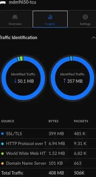

Yes, there are occasional large data packets that are received by the truck over WiFi.
It's mostly SSL/TLS traffic.
I use the Ubiquiti UDM + U6 Mesh routers and monitor data thru both main and remote WAPs mostly to monitor what traffic my kids are connecting to...

I do the same but I don’t have the DM as I use the EdgeRouter Infinity with CloudKey and U6-Pros. Regardless I have logging enabled and I can trace large downloads per session.
