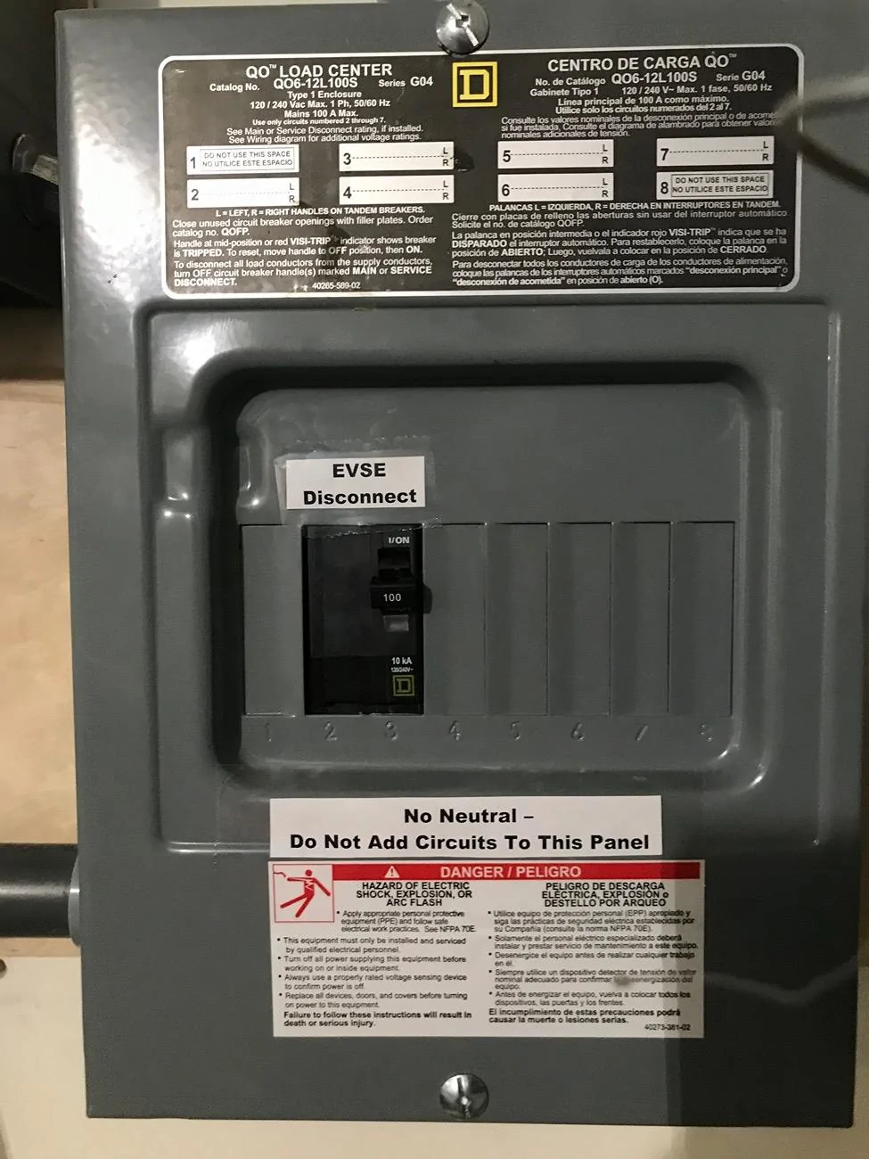

I used a subpanel ($28 without the breaker) for my local disconnect and labeled it accordingly. If I ever move and take the FCSP with me, I’ll leave this panel.
