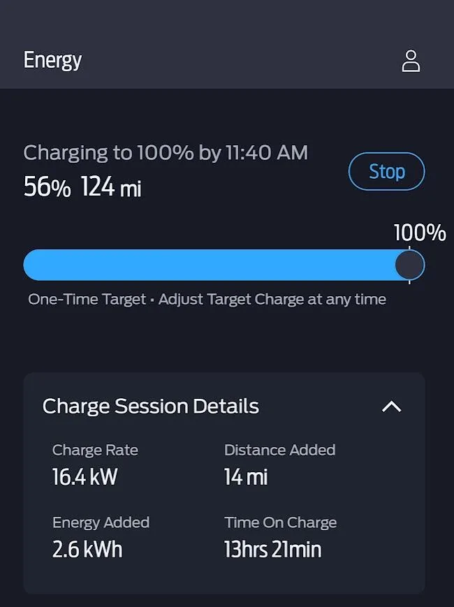

I assume the "Charging to 100%" by a past time was only a software bug? Or will it go ahead and charge to 100% even though the time to complete isn't accurate?
I may be assuming too much, but I take that 9:34AM to complete charging to mean that it will take nearly 24 hours for some reason.

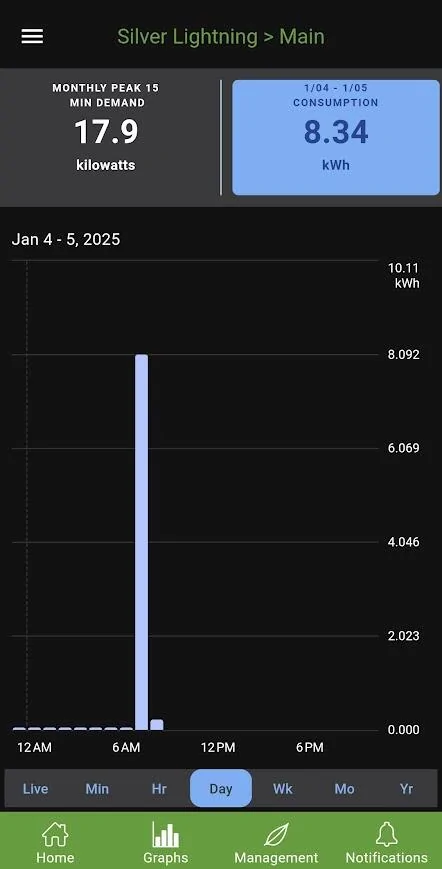

My test: My Emporia declared it was providing all the kW possible. The FordPass note on the screen states it is charging to 100% (at a past time) and it gave me pause; and I only allowed it 10-15 minutes before stopping the test. I noted there seemed only a small amount of gain to the HVB charge level, say 1% while it consumed 10 minutes of full power.
I may be assuming too much, but I take that 9:34AM to complete charging to mean that it will take nearly 24 hours for some reason. Sponsored
I think this is right. Based on my observations of the time calculation after pressing the Start button in FordPass, I think it is simply calculating a time based on a real time charge rate. Plus there's probably a bit of lag. It seems to take a little time before the time becomes accurate.
Now I'll go into speculation territory. Maybe the extended time displayed after pressing the Start button is an indication that not all the energy is being put into the battery. Maybe it's an indication the battery is being "preconditioned." Or it could be a bug.🤣

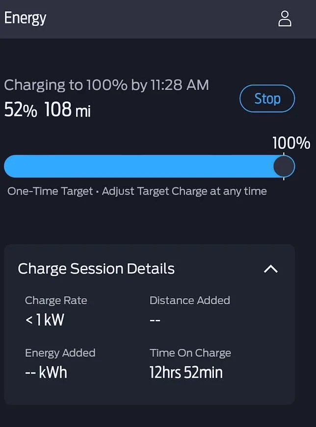

To be sure I understand your finding:
I press the "start" on FordPass; and it provides the statement "Charging to 100%" by a specific time (which in my case wasn't in the future); the truck is actually is preconditioning the HV battery?
Is the result of your test: To precondition while plugged in, use the "Start" but be sure to cut it off after the state of charge begins to climb?
Ignore the gibberish about when it will complete 100% charging.

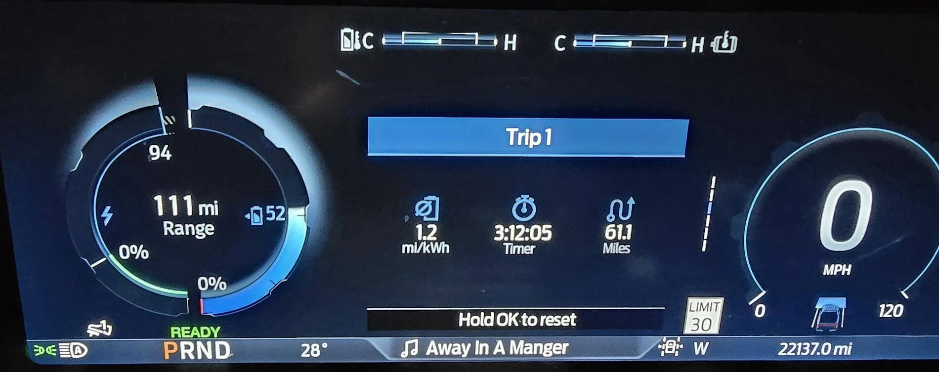

This was the battery condition last night when I parked, motor energy reduced to 94%, SOC 52%

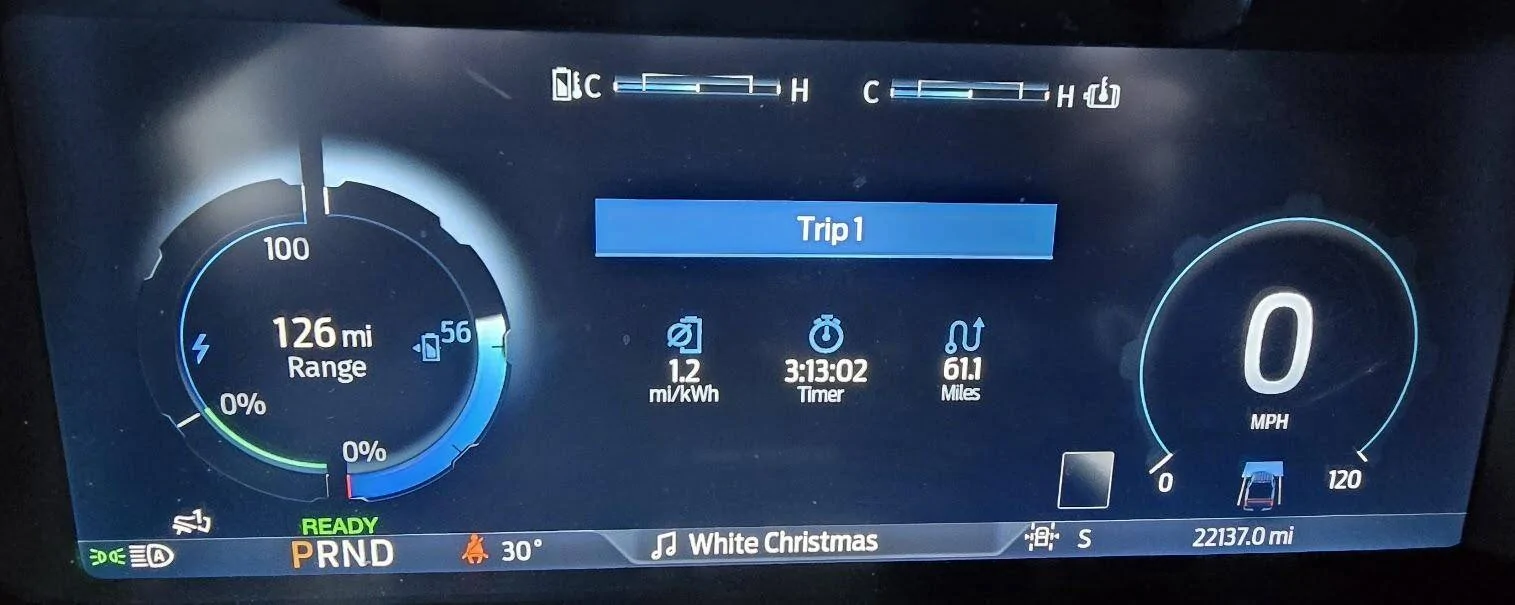

I hit the START charging button at 07:30 and let it run for 30 minutes this time, SOC appears to increase by 4% and performance increased to 100% with potential extra range of 16 miles.

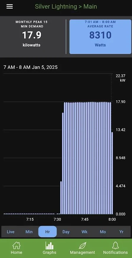

Juice used for charging / battery warming and 15 minutes of cabin warming according to Emporia

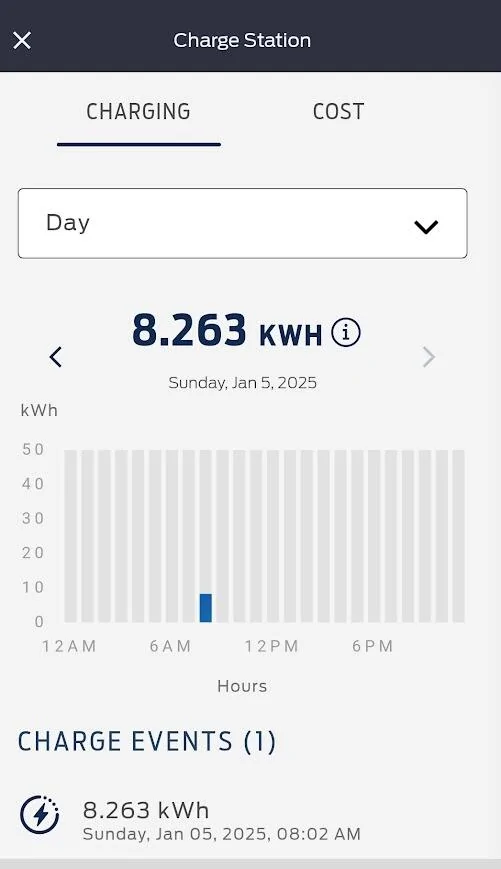

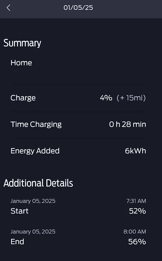

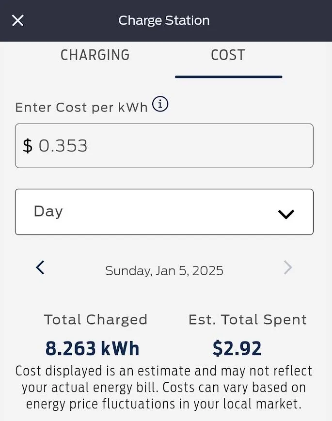

Ford pass and FCSP log data: 4% traction energy of about 6 kWh, gross energy running through the FCSP 8.263 kWh costing $2.92 to prepare the truck for travel.

I do this as an exercise in helping others understand what's happening, the reality of my personal use case, I do not need to do any of this for local short mile trips, but if I were going on a long trip, then these steps would be worthwhile.
I wasn't worried that the battery was gaining additional energy, in reality that extra power is useful for the days travels, but I was hoping the BMS would inhibit charging so that I could in the interest of science determine what the energy expenditure is in battery warming and cabin preparations.
