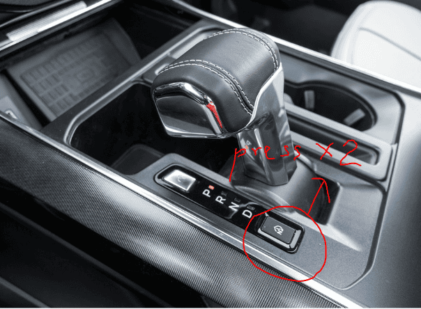

🤣🤣🤣 This is funny coz this was the exact video that the tow guys used to finally get it to neutral. In case it happens to you guys and you need to put your lightning to neutral for towing, you have to press the brake and the accelerator pedal together then move the shift to neutral. You then press the small "neural" button (Not sure what that button is but attached is a photo of it) button TWICE then you can release both the brake and the accelerator pedals. This should put the vehicle to neutral.

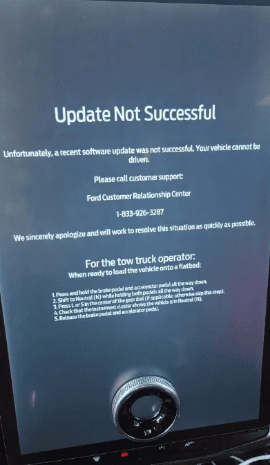

What update was your truck attempting to install, did it have a code below the description of the update?
Not sure what update this was. I had my truck set to auto update so I didn't get a chance to see what it was. The "Update not successful" message on the screen did not mention what version of the update failed either.
